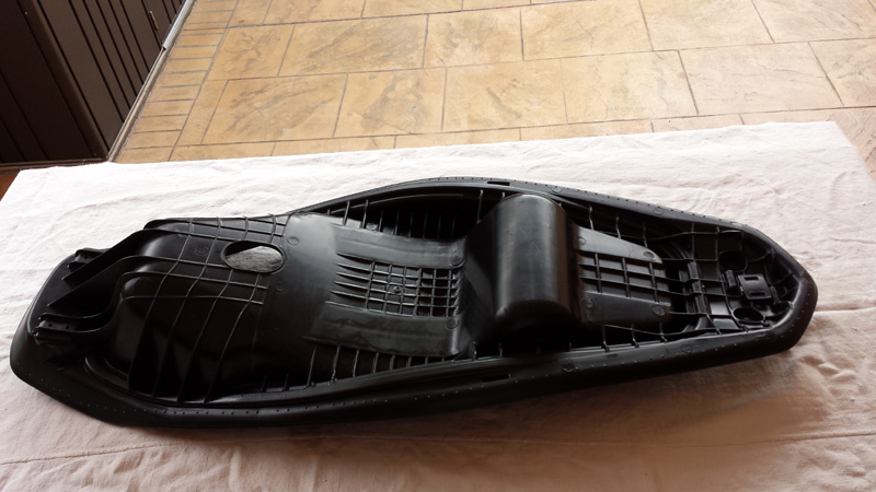

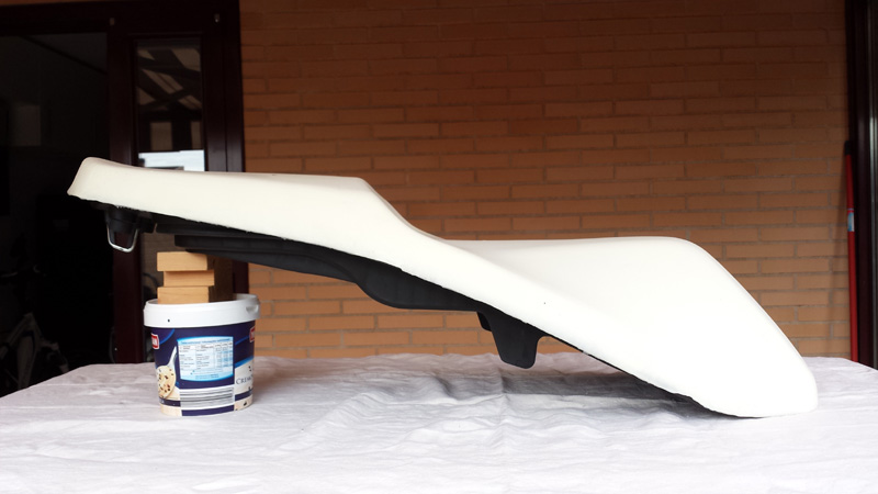

And here you can see some pics of the seat, unveiled:
seat 01.jpg (109.06 KiB) Viewed 7859 times
seat 02.jpg (135.69 KiB) Viewed 7859 times
seat 03.jpg (96.32 KiB) Viewed 7859 times
As you all can see, the 2014/2015 seat does not have a "hump", but has a "WALL" that is really tall!!! :lol: :lol: :lol: :lol: :lol: :lol:
