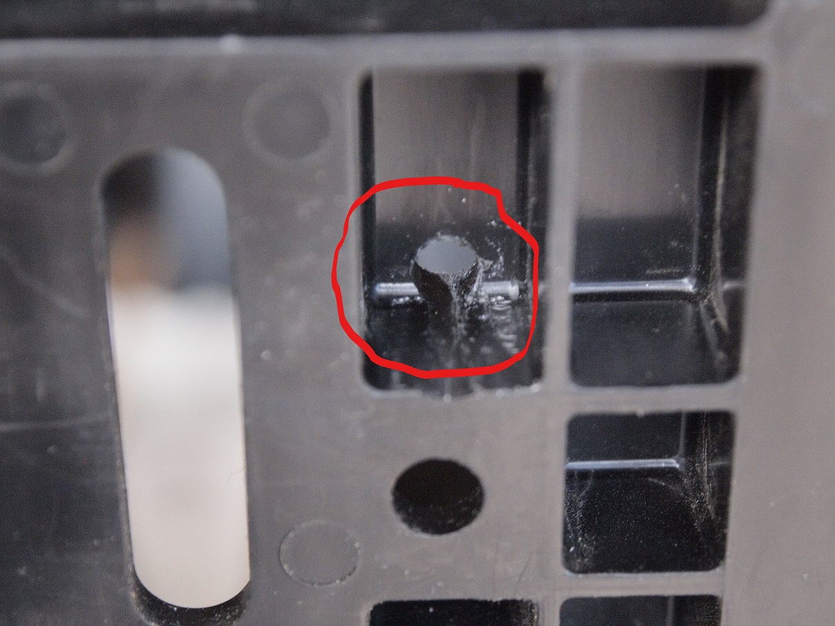

Now that the electrical was done, I needed to make my mounting holes. From the pictures online, it looks like the DOB29KL has two mounting holes while the DOB50KL has three. Of course, none of the holes in the top box's mounting plate or rack aligned with the 50's holes. I ended up drilling one new hole in the rack and two new holes in the plastic mounting plate:
I also needed to carve away a little bit of ribbing under the plastic mounting plate where the center mounting screw was going to go (sorry, no picture; it was easy with an X-acto knife). I was then able to reassemble everything! The DOB50KL sits flush with the edge of the plastic mounting plate, so there's less chance of damaging it when the top box is off.
