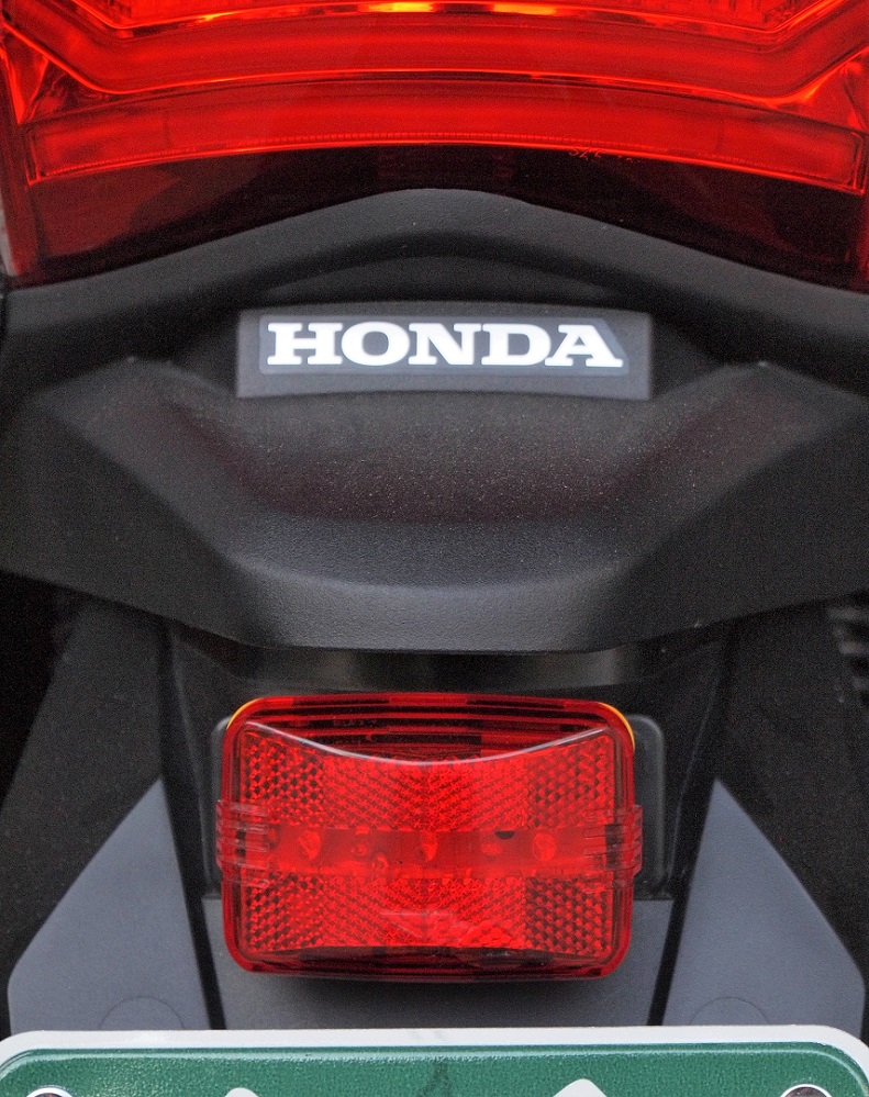

I did a fairly simple mod of replacing the rear reflector with a battery-operated red LED light. This is a light I used for years on my bicycles, but with smaller, brighter AAA models available I never use this AA model on my bicycles any more. Also, being an older model, it only has one flashing mode as its "ON" setting. (Legal here in the US, but possibly not in other countries.) With the LED off it's still a reflector, but now I can turn it on at night or also use it as a flashing DRL.

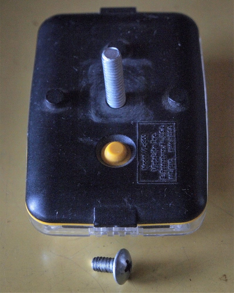

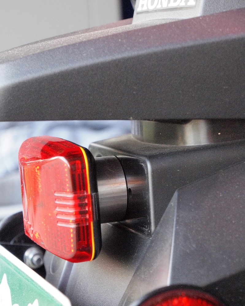

The only two hurdles to overcome were finding an appropriate standoff (to allow access the On/Off switch on the back) and then installing the correct size mounting screw from inside the light (this requires R&R of the LED circuit board).
I also have the same model front flashing LED (white/yellow) that I'd like to install, but I can't seem to find a decent mounting point for it. Any suggestions for a similar installation on the front? :D
Installed LED in original rear reflector location
LED installed with standoff in original rear reflector location
Original external bracket-mount screw shown next to light with standoff-length screw installed
