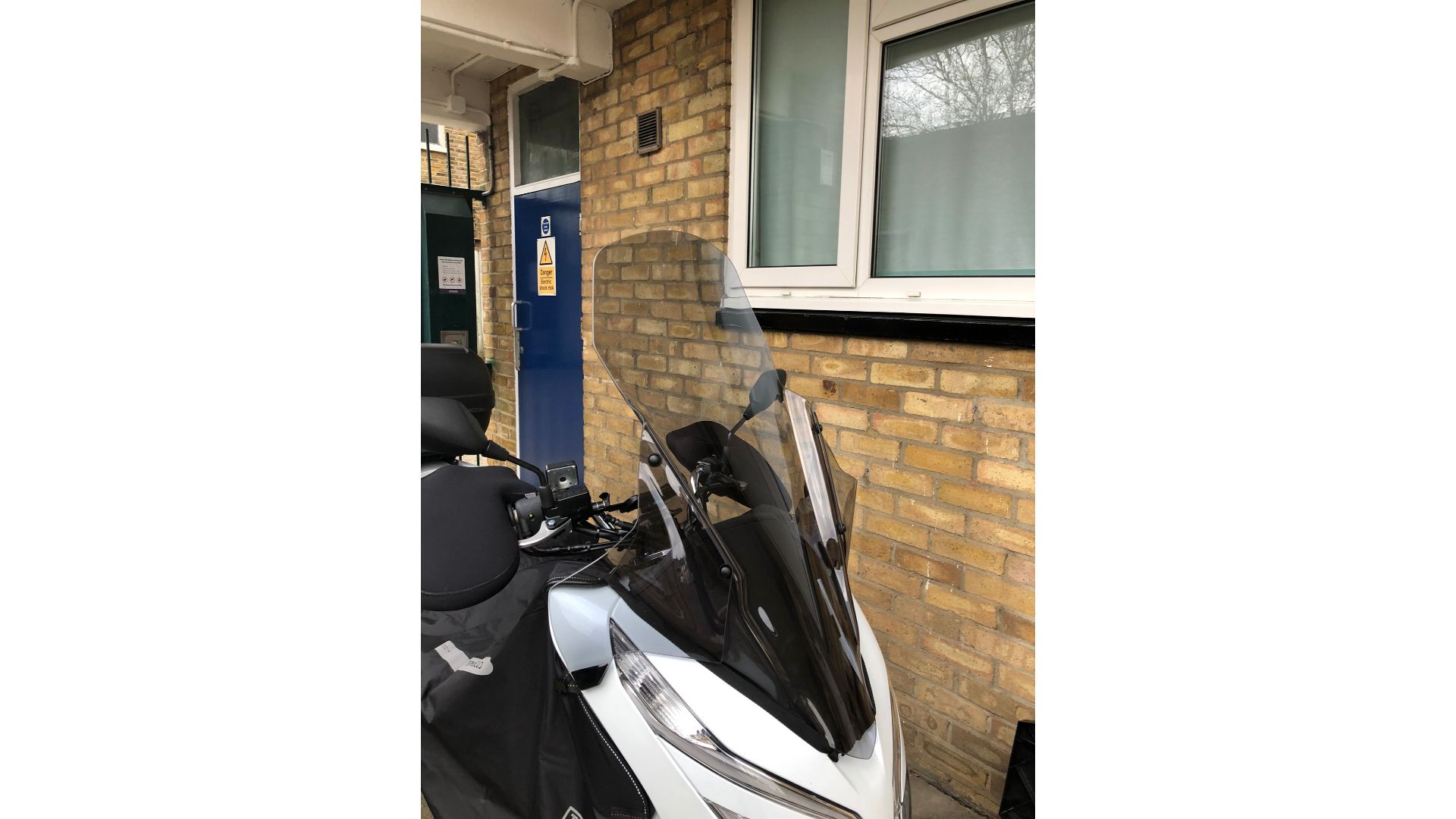

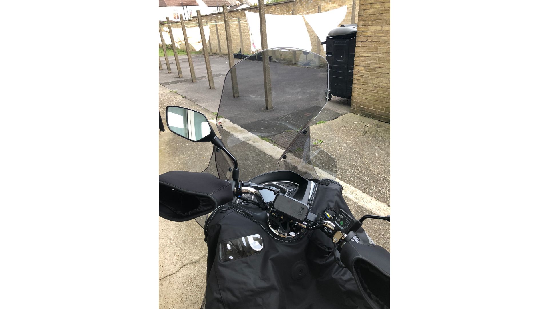

*The windshield is quite tall - I am 1.75 m (5.7 feet) and i can only juuust see over the top of it. I till take some getting used to.
*Please don't get it black. I got it "light smoke" and it is already tinted enough. Anything more and I wouldn't be able to see potholes in front of me, just the direction I'm heading to. This will take probably some getting used to!

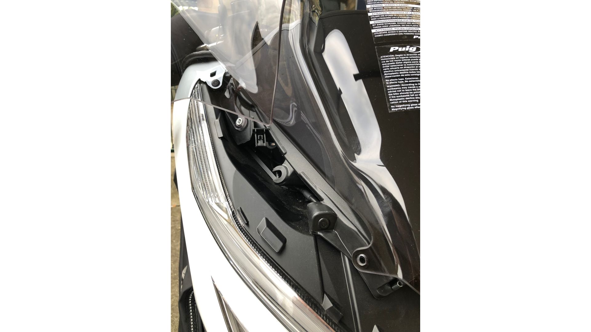

*Installation is easy. More on that & thoughts in the picture.

*The lower securing bolts from Honda are baldy designed, it's a rubber grommet with a screw inside - mine was already warped and quite loose. I made it work nonetheless.

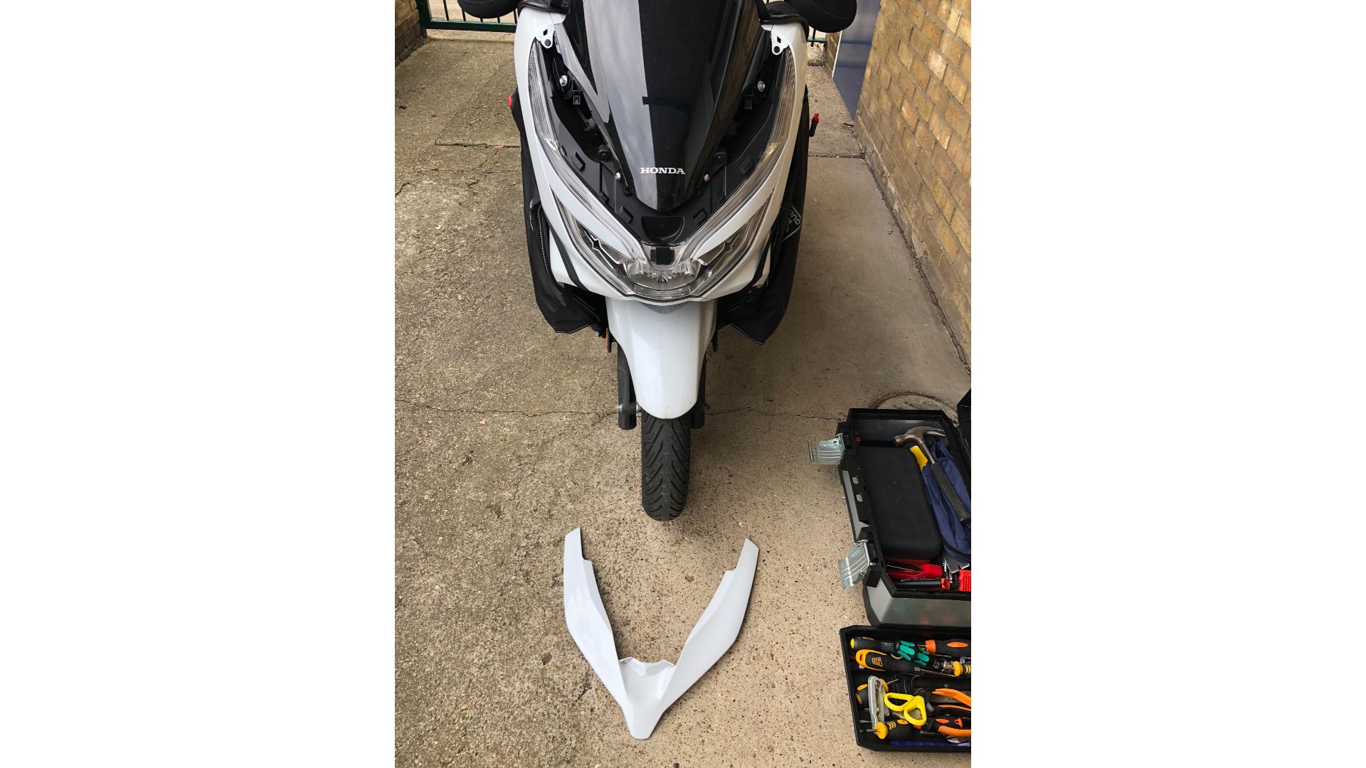

Delivered package, tools, no beer because it's cold, just a cup of tea. The patient. Front fairing removed. Old screen removed. Good riddance. New screen out of the packaging - sexy mama. Back view Alignment with the factory screws is impeccable! The one ordered from Motea comes with the hand deflectors assembled. Please make sure to tighten them - mine were rather loose. I think the need to spend actual money on translators, this has probably been done by Google translate on Internet Explorer. Side hand deflectors have a unique design that includes double tape & strong plastic velcro to secure the hanging bits to the bike. How this looks pressed against the bodywork. Finished product from all directions. Responsibly getting rid of the box. Leftover screws for the hand deflectors - spares. Someone asked before about handlebar turning - it goes almost to the very end - literally a few millimetres left before it hits the windshield. Not a problem at all - well designed. As the hand deflectors go over the indicators ever so slightly, whenever you indicate there's a nice reflection to remind you the indicators are on.

@Eiron - when living in a rainy city, looking through a windshield is not the best. Rain forms beads which (especially in evening time) distort light & everything else. I used to have a Vespa GTS300 a long time ago, and their big windscreens are full ones - never felt safe during the rain. Always hesitant to what's actually in front. When rain is on the visor, the brain can ignore it & form clear vision by what's between the droplets, because they are so close.

Not a happy bunny I'm afraid. Had my first post-install commute to work. 11 miles of 20-30-40 miles an hour.
*Wind buffeting is a problem and a major one for that matter. The screen, although quite high, protects the front of the helmet, but then it slants in a reverse "V" towards the sides (look at the above pics). Wind just hits the sides of my head, particularly around the eyes. It would have been massively uncomfortable if I had no sunglasses today. With the helmet visor closed you can feel like a couple tiny hammers keep knowcking the side of you helmet at all times. Maybe it's my height - but it should't act like that. The previous Givi had a slight angle at the very top - like a curve that pushed air over the helmet at all times, inlcuding for the sides. This one doesnt. Wind also buffets on the sides and makes its way to the chest.
*Light smoke screen. WHY did I do that??? It's so awckward! Light changes are tough to adjust to. If I am negotiating a massive roundabout, go under a bridge or a cloud shileds the sun, the eyes need a few secs to adjust. I can see in the distance over the windhield, but not what's under my wheels. Those few seconds make me hesitant which I hate. A confident rider is a safe rider. Please go for the clear if you order one. They also make it in Dark smoke which is basically black. That's suicide for this height of windhsield.
