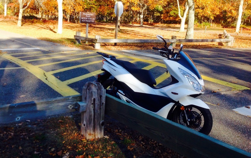

Hi Ed, Just catching up! Welcome to our Forums!
Glad you found us and Happy that you bought a PCX! A hoot to ride (even "as is"). Indeed, Mine is White
with added Prestige badge(s).
Enjoy yourself and Ride Safe, Always
