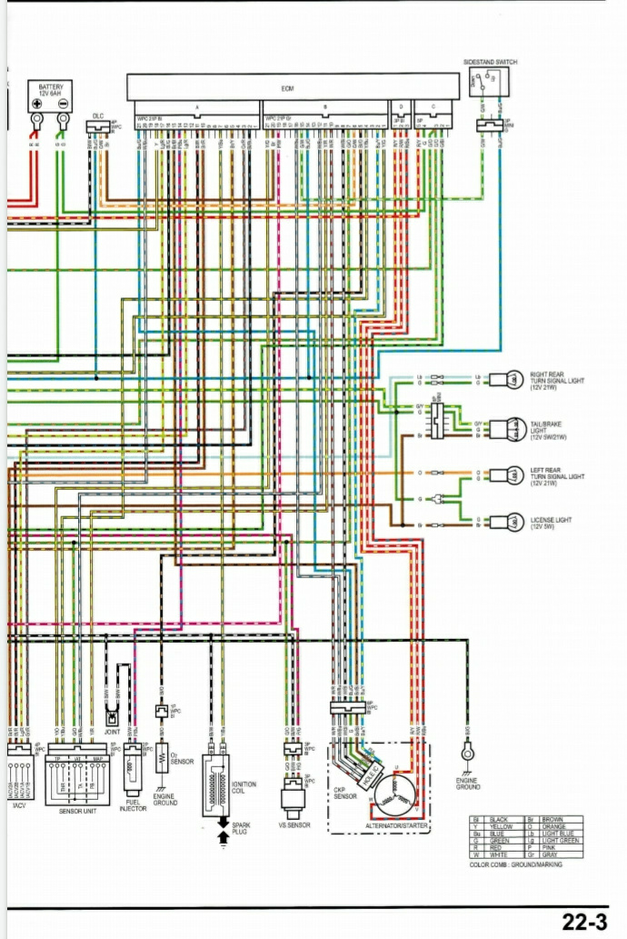

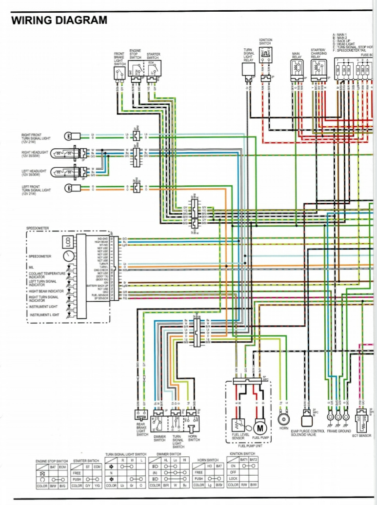

Re: Installing a new ignition after theft attempt!
Do you have a wiring diagram?
Wiring diagram 1.jpg (330.46 KiB) Viewed 1363 times
Wiring diagram 2.jpg (320.82 KiB) Viewed 1363 times
These are screenshots so I can't get better clarity. Sorry.
