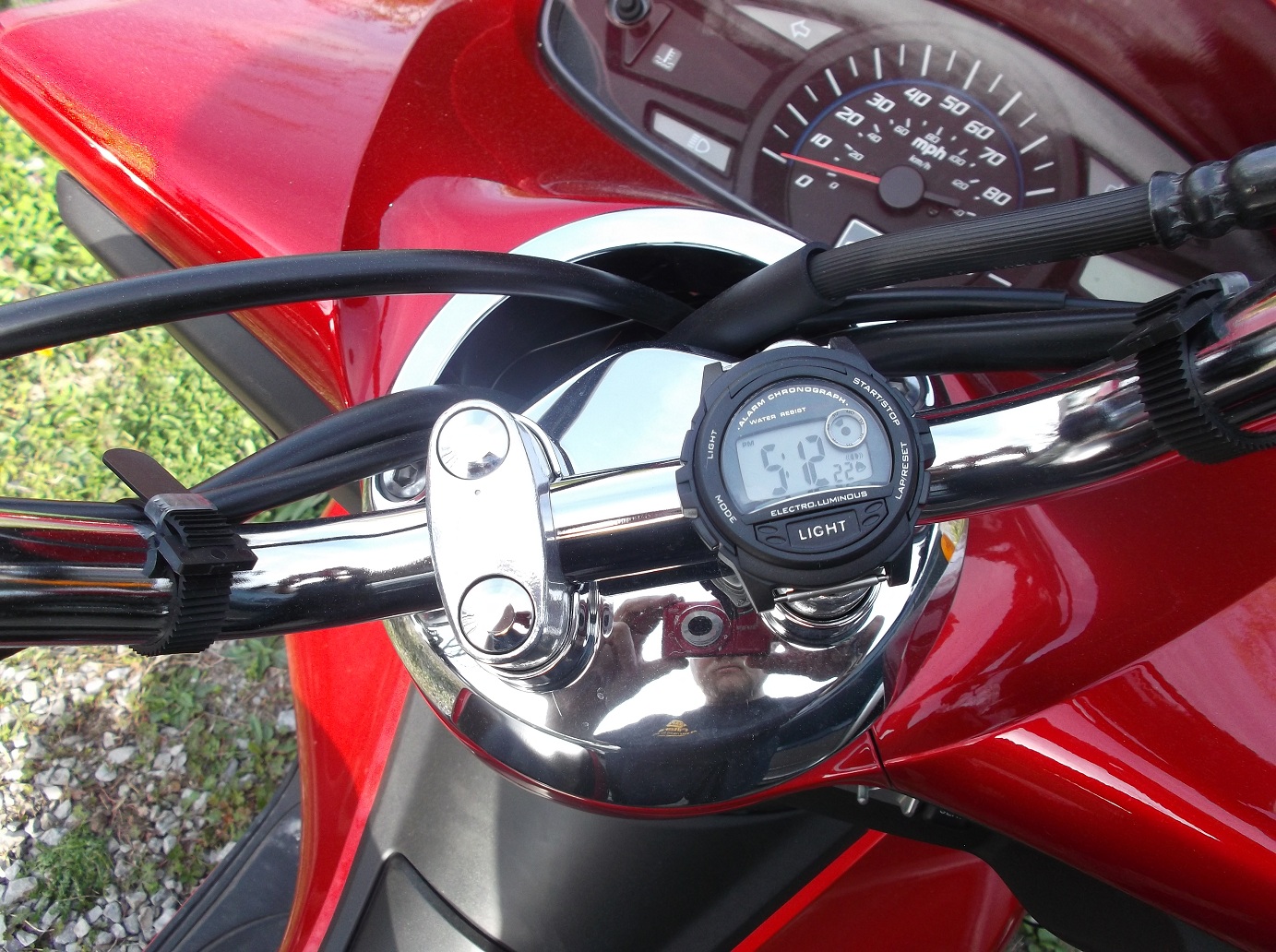

- just to show ya how i added a clock hehe. its a 12 dollar waterproof watch from wal mart. has a convienent light button right on face of watch for when its dark. Took off the watch bands and secured the watch using 3M vhb tape
- cheap clock lol.jpg (588.93 KiB) Viewed 4441 times
