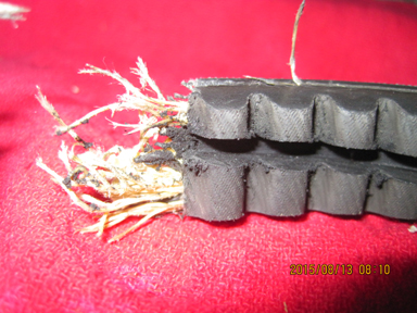

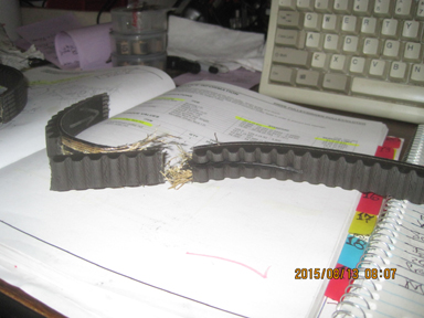

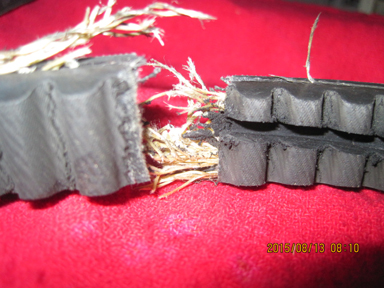

01 torn-busted belt 1 324k.jpg (100.92 KiB) Viewed 4737 times
and
01 torn-busted belt 2 324k .jpg (132.54 KiB) Viewed 4737 times
and
02 torn-busted belt 324k.jpg (141.89 KiB) Viewed 4737 times
You can clearly see where belt was on top of pulley from grove cut in it.

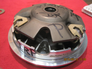

Also, this is shot looking at ramp plate and movable plate on Dr.Pulley variator.
You can see the opening.
04 Dr P variator ramp plate 324k.jpg (112.96 KiB) Viewed 4737 times
I was able to manually wiggle some sliders out.
There were no obvious rub marks on inside top of casing where the grooved section of belt was pulled from.

:? I can still see a crack in the belt.

you can see that belt is slightly twisted and wedged between veriator and cvt case.
NO WONDER MOTOR WOULD NOT TURN.
Also look at lower center behind twist in belt, you will see a slider laying there.
and finally the belt itself.
So – now we know why motor would not turn over.
BUT - we don’t know why everything fell apart. :?
It’s the old who came first question – the chicken or the egg ?????
Veriator nut still in place and properly tight and no damage to any components.
After I get all the tupperwear back on and have a chance, I will play around with the variator and see if I can duplicate the sliders coming out.
