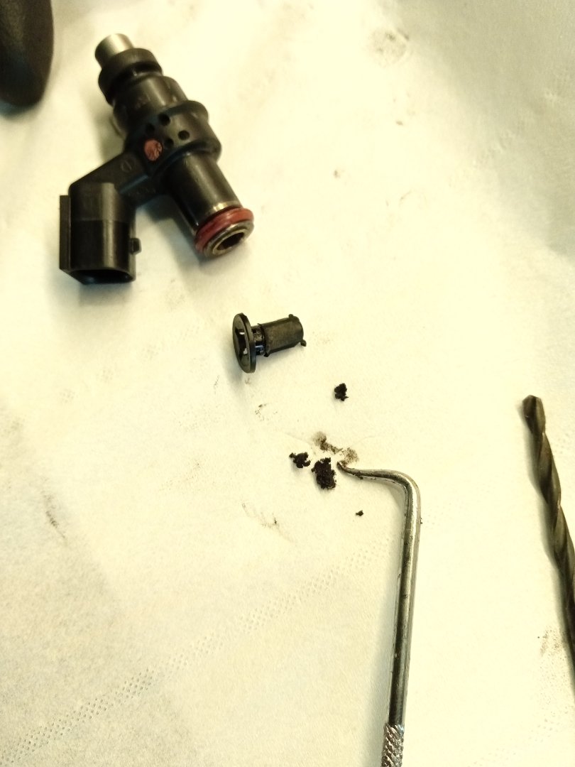

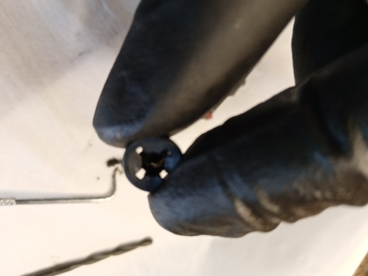

Good morning everyone... Yesterday I was on foot for the first time with the machine... after 11 years and 80,000 km... The bike started because I couldn't accelerate very much, that is, I managed to reach 70/80 kh... However, it didn't go over 40/50kh until I was just on the fly.... I called the trailer home and thought it was the gas pump... I went to test it and the pump makes more than 3 bar of pressure., .. I assembled the original injector and it was ok... However, when I look carefully, I verify that the injector microfilter is completely covered with rubbish.....
I took it apart and cleaned it... it was spotless... I couldn't figure out where so much garbage came from since the gasoline well has a filter too...
I decided to dismantle the pump and came to the conclusion that inside the pump filter there is another filter that must be undoing!!!!
The great evil is not just the filter sold.
- IMG_20210618_160718.jpg (152.4 KiB) Viewed 33486 times
- IMG_20210618_160437.jpg (215.54 KiB) Viewed 33486 times
- IMG_20210618_160435.jpg (144.92 KiB) Viewed 33486 times
- IMG_20210618_152749.jpg (153.57 KiB) Viewed 33486 times
- IMG_20210618_152410.jpg (141.94 KiB) Viewed 33486 times
- IMG_20210618_152350.jpg (134.86 KiB) Viewed 33486 times
- IMG_20210618_150601.jpg (215.37 KiB) Viewed 33486 times

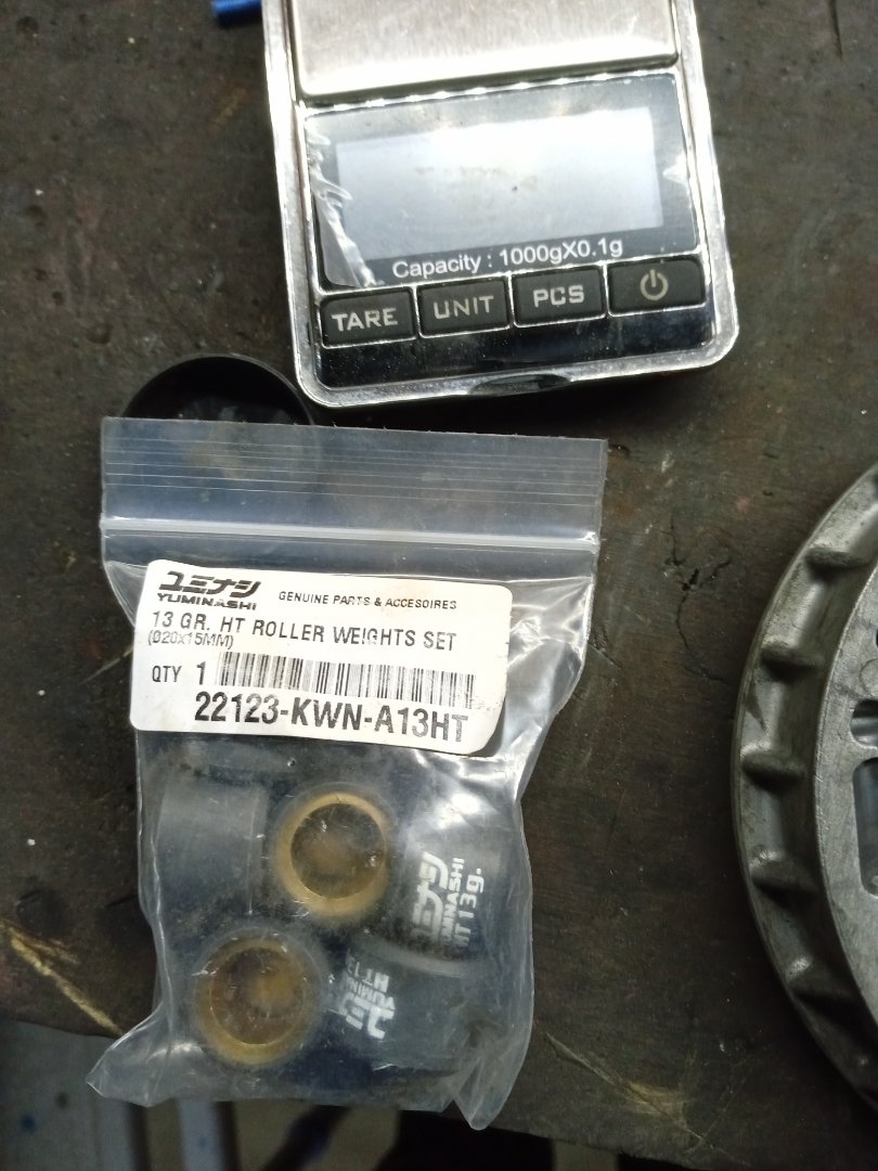

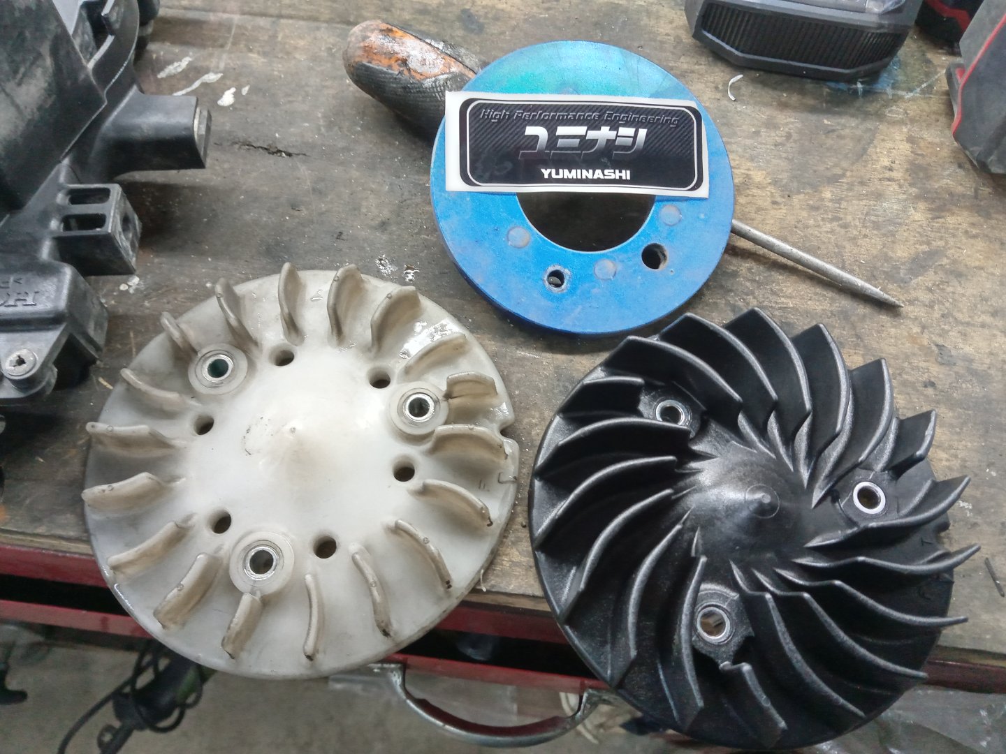

Re: pcx power-full
good morning guys, well here is the yuminashi variator with almost 50 thousand km.. and like new...
replacement of antifreeze, and new rollers but this time 13 gr
- IMG_20220208_215343.jpg (189.52 KiB) Viewed 32464 times
- IMG_20220208_215347.jpg (186.81 KiB) Viewed 32464 times
- IMG_20220208_221016.jpg (174.72 KiB) Viewed 32464 times
- IMG_20220208_215348.jpg (183.76 KiB) Viewed 32464 times
