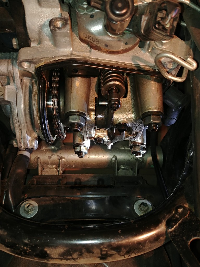

Followed this for the 2015 PCX (Chassis KF18-100++++) Japan model.
Thought I had copy and pasted the procedure incorrectly, as when I got to removing the center console, I saw that it is different to the one featured here.
My fuel cap cover opens on an arm forward of the fuel filler cap, not to the rear as is shown here.
There is only one screw visible from any angle that is behind the fuel cap cover and just in front of the seat.
Now trying to follow this Youtube video as he does it without removing the center console, but it appears that he, too, has the North America model. I am stuck trying to get the seat bucket out before removing the side panels.
https://www.youtube.com/watch?v=ierh8gBeuLg
OK, back to it... frustrated and without a scoot for work if I don't get it done by Sunday evening (now Saturday lunch)...
I will update this post with pictures that I am taking as I go.
Don't want to call a dealer, but might have to get the bike safe enough to ride and then leave it with a dealer..

2015 / 150cc
Bought in Jan '16 at 4,400 kilometres / 2,750 miles.
First known check at 9,200 kilometres / 5,750 miles.
Used the specs from this post, so I hope the 2015 model is the same.
Quoted specs.
In: 0.1mm plus / minus 0.02mm
Ex: 0.24mm plus / minus 0.02mm
Inlet was very tight on 0.11mm and would not take 0.12mm.
That is almost exactly ideal and is within spec.
Exhaust was Extremely tight on 0.25mm and would not take 0.26mm.
That, too, is within spec.
Broke only one plastic retainer re-assembling the bike (grab-bar cover left side orange trim retainer).
Took photos.
Made Facebook album.
Will post link.
http://www.fuelly.com/motorcycle/honda/pcx150/2015/staninjapan/408151]Image

Feelers should be a sliding fit not very or extremely tight so it sound like both inlet and exhaust were right on spec.

So I did a valve clearance check 1.5 week ago. I don't think it had been done before by the fact that torqued screws still had the paint markings (yellow) nicely aligned. I bought it second hand at 2000km now it reads around 8000km so guess it was time to check the clearances.
First of all thanks for this how-to. Also thanks to Homie for his youtube video on how to remove the panels which is most of the work :) - some panels were different though, guess different model/year.
Good news for those who would be interested, the folks at Honda were clever and made the lock nut of a softer material than the valve adjustment screw. Guess how I found out? :oops:
Yeah , probably overtorqued it when fixing the lock nut after adjustment, some of the thread of the lock nut was winded around the adjustment screw. Initial thought when it happened - panic! :lol: Took a step back (more than one) and relaxed with a cold beer (also more than one).
So I ordered a new valve nut, first at official Honda supplier in Belgium from which I got an email stating it would take around 3 weeks to get it :o. Next stop,partzilla and got it delivered after 9 working days.
Oh and yes valves were too loose when I checked them (especially out valve) so now they are back as stated in service manual.
So all in all, still a happy PCX rider even though I messed up a bit - lesson learned!

Well I figured an update was needed. Last time I checked the valves I was at 13480km.
I decided it was time to check them before winter as I was doing an oil change and repairing my driving lights.
I was pleased they were spot on as my milage is now 43450km.
I learned something too. Do not put the Honda gasket sealant on the whole gasket, just the corners as per the manual. I must have done this last time and the valve cover came off, but the gasket was nicely glued in place.
Oh well, left it alone and put the valve cover back on.
