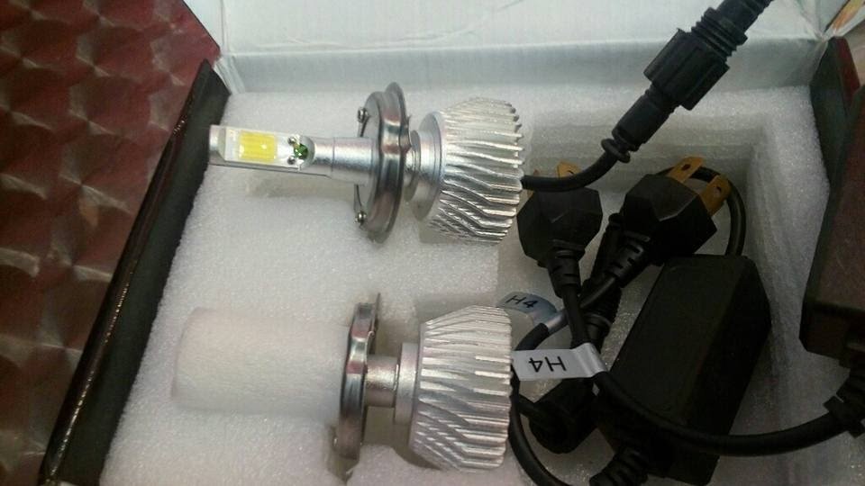

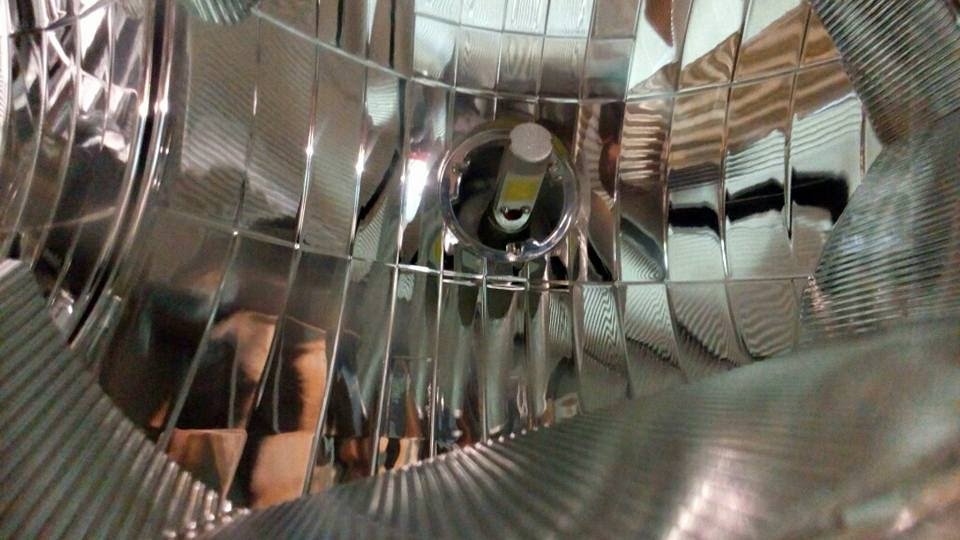

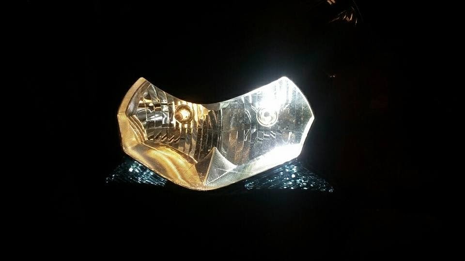

hello guys here are some more pics
original vs leds
original vs leds

How would you connect the H4 bulbs to the HS5 sockets?
power-full
Posts: 280
Year: 2010
Color: preta
aRe: pcx power-full
Post by power-full »
you cut the plug before the socket you leave a little wire for if one day you want to assemble it again, and you have the connections there .. you pass a medium wire to each side and the same with the medium wires

I don't fancy cutting and splicing wires. Are the any kits around that'll convert HS5 to any other bulb type?
ToraxOutlaw
Posts: 13
Joined: Mon Feb 14, 2022 7:01 am
Year: 2012
Re: pcx power-full
Post by ToraxOutlaw »
I'm only asking this as the LEDs you have installed are not road legal for the UK. My bike would fail its MOT.

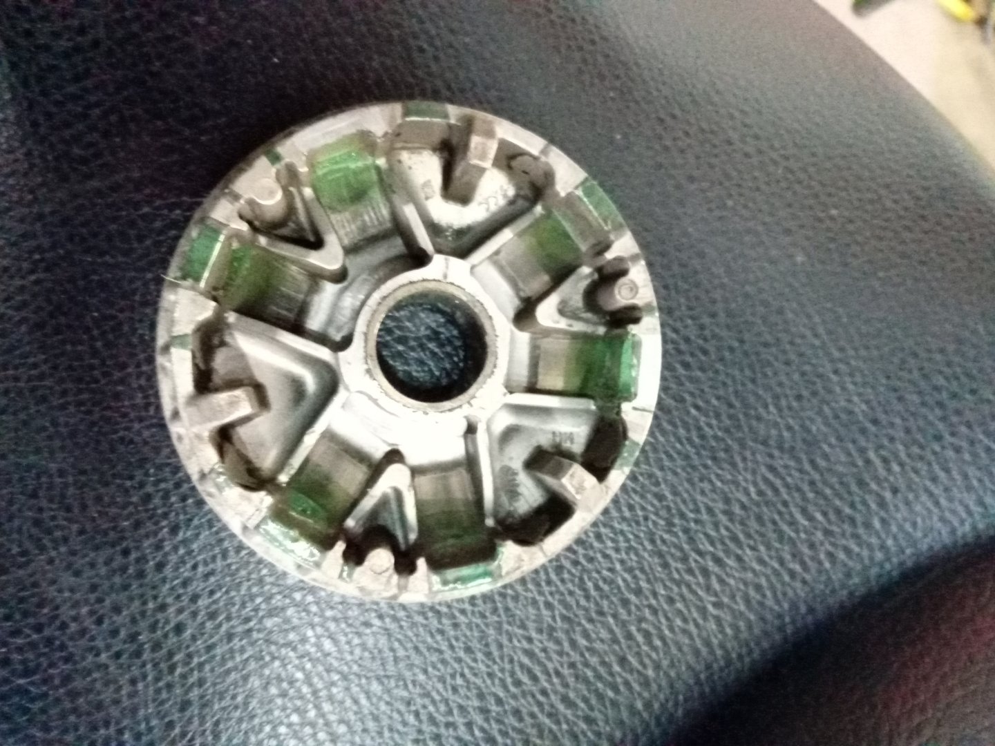

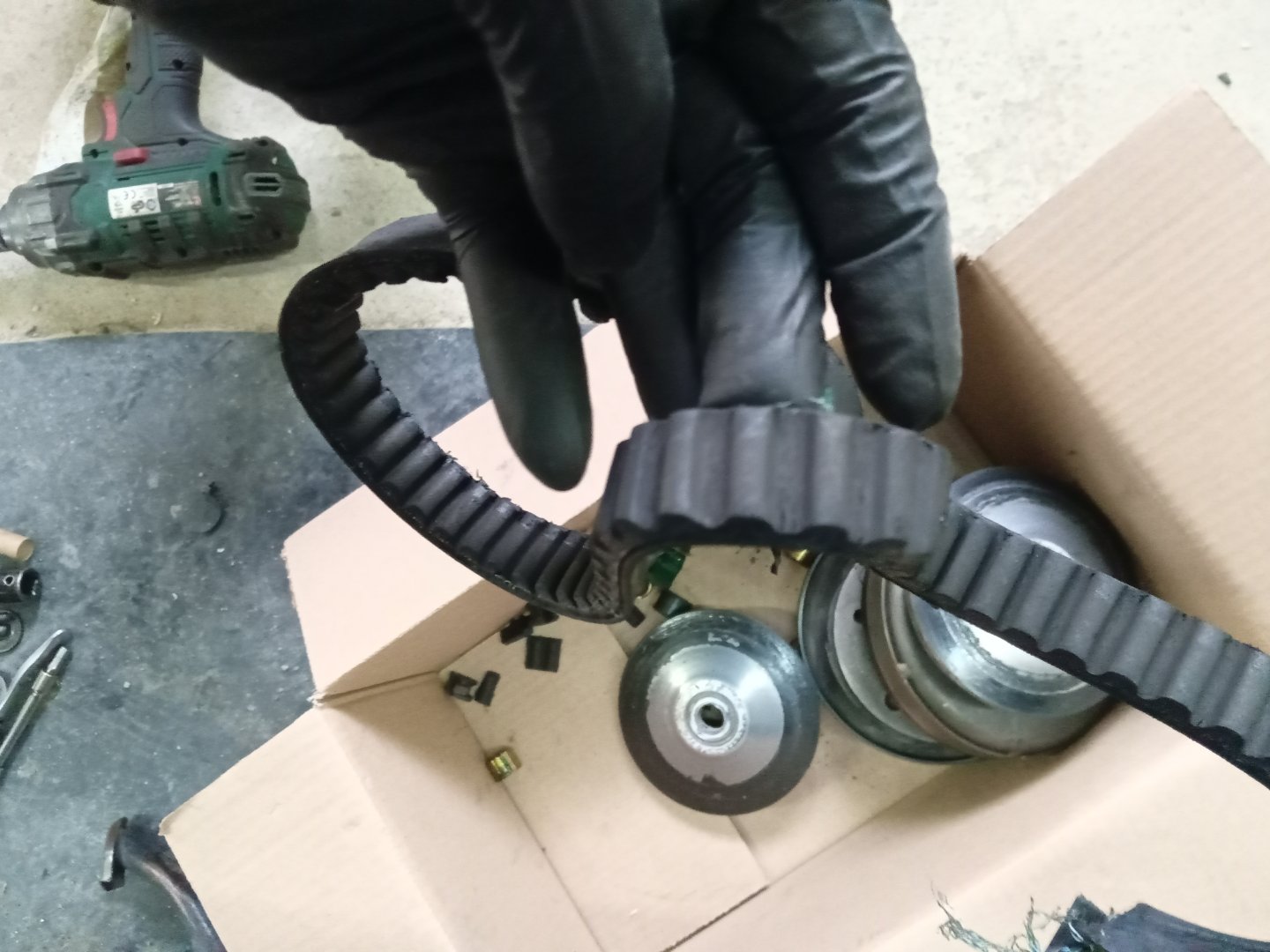

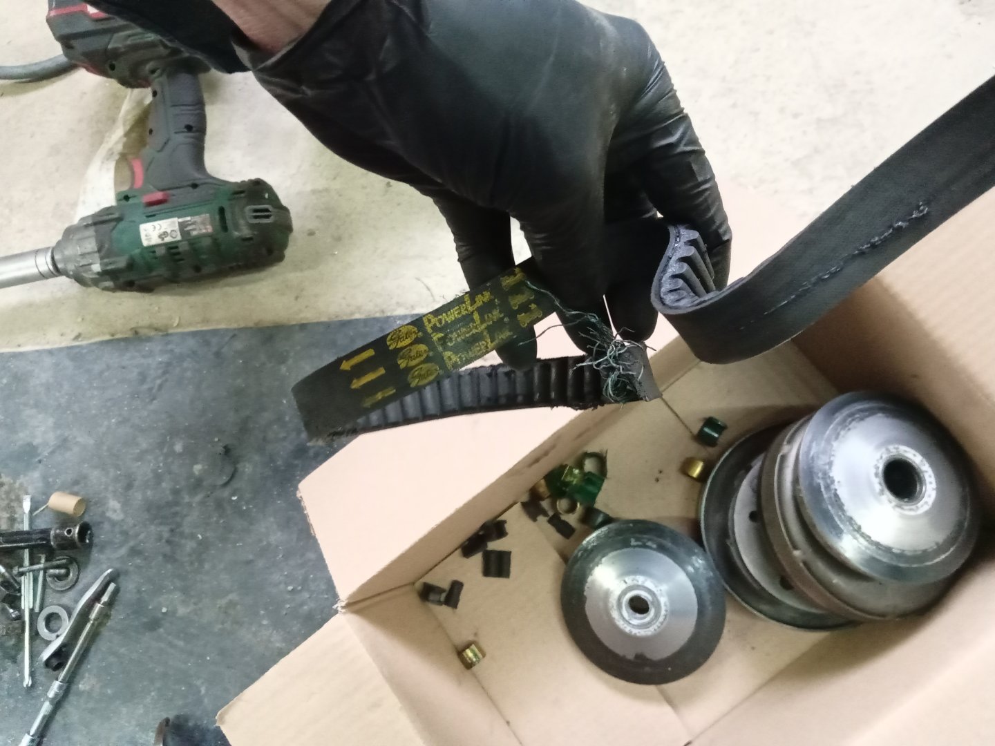

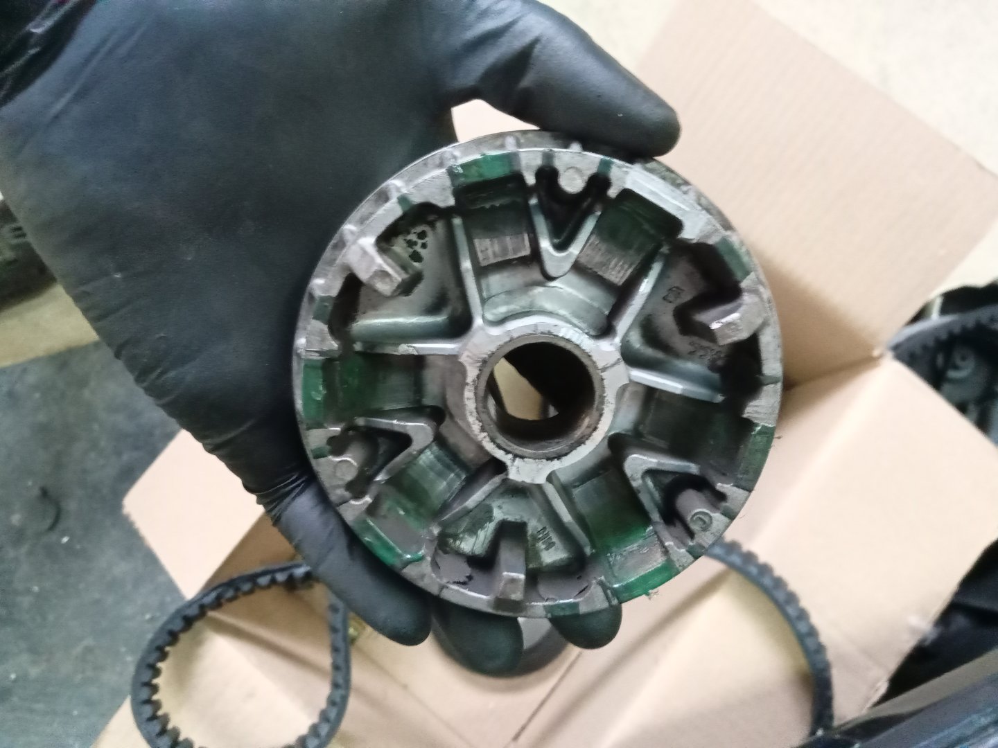

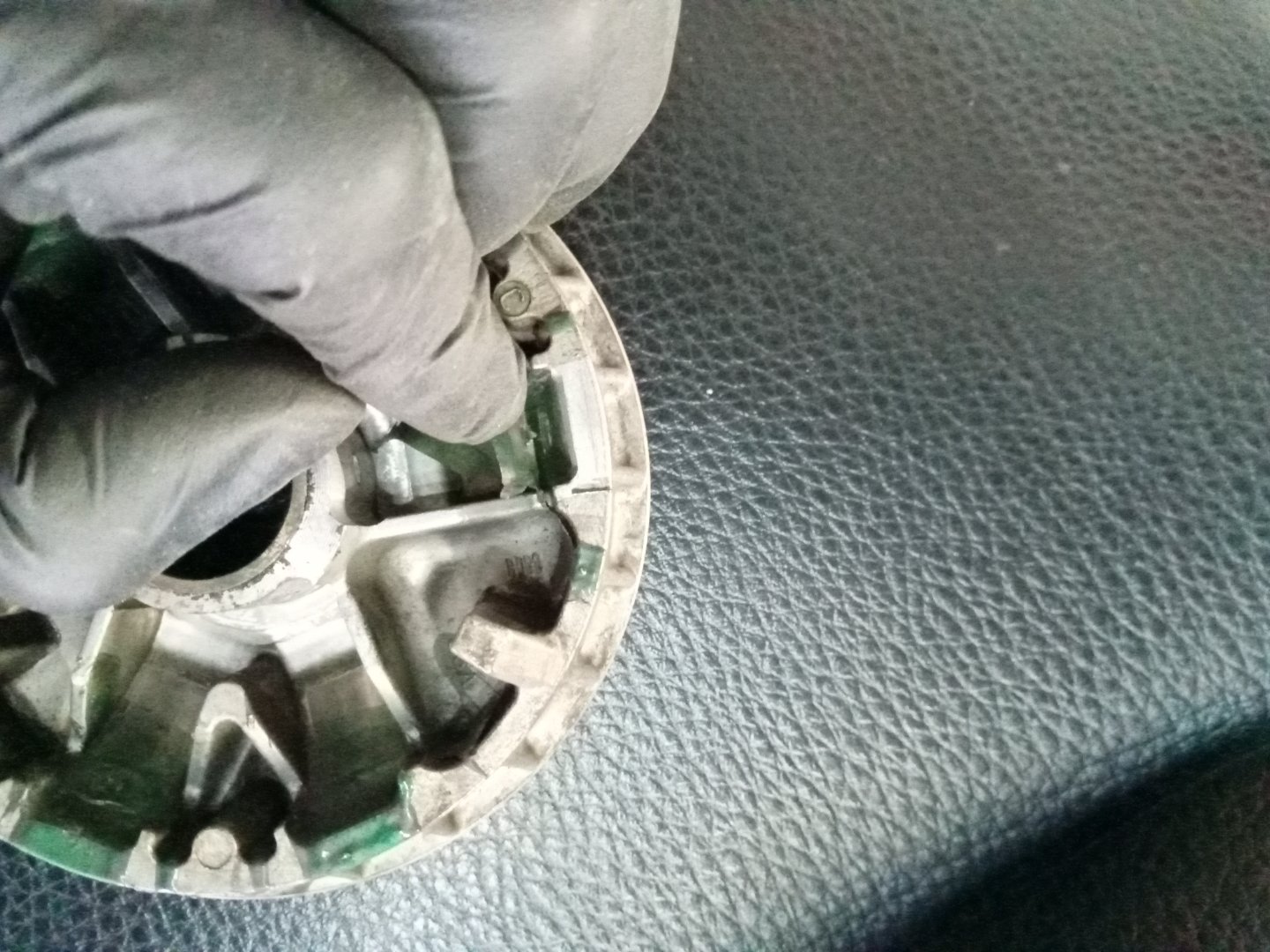

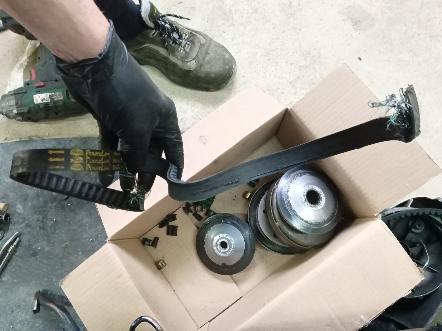

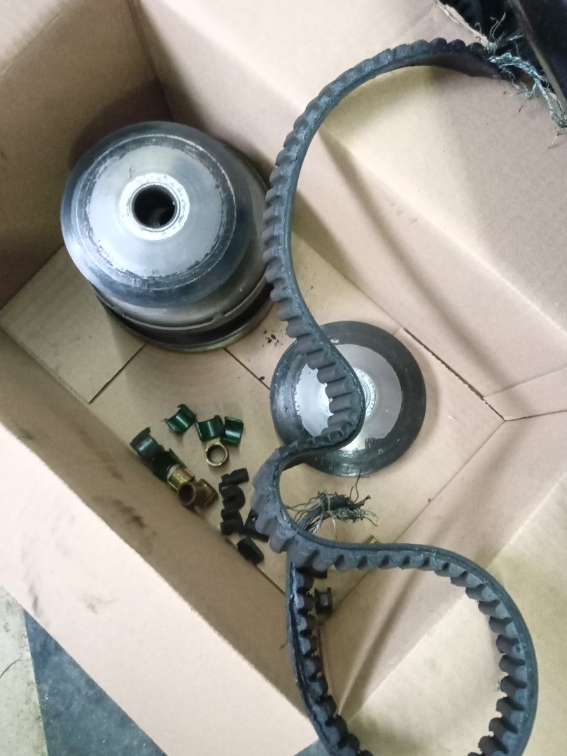

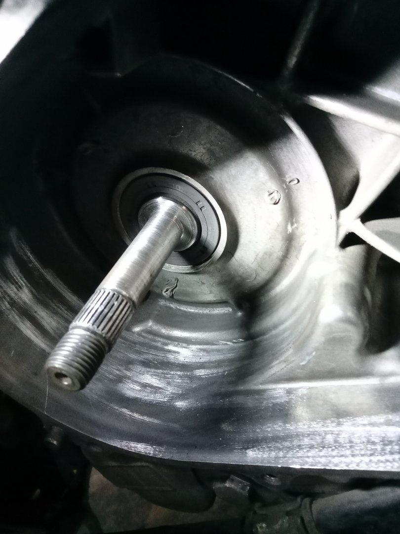

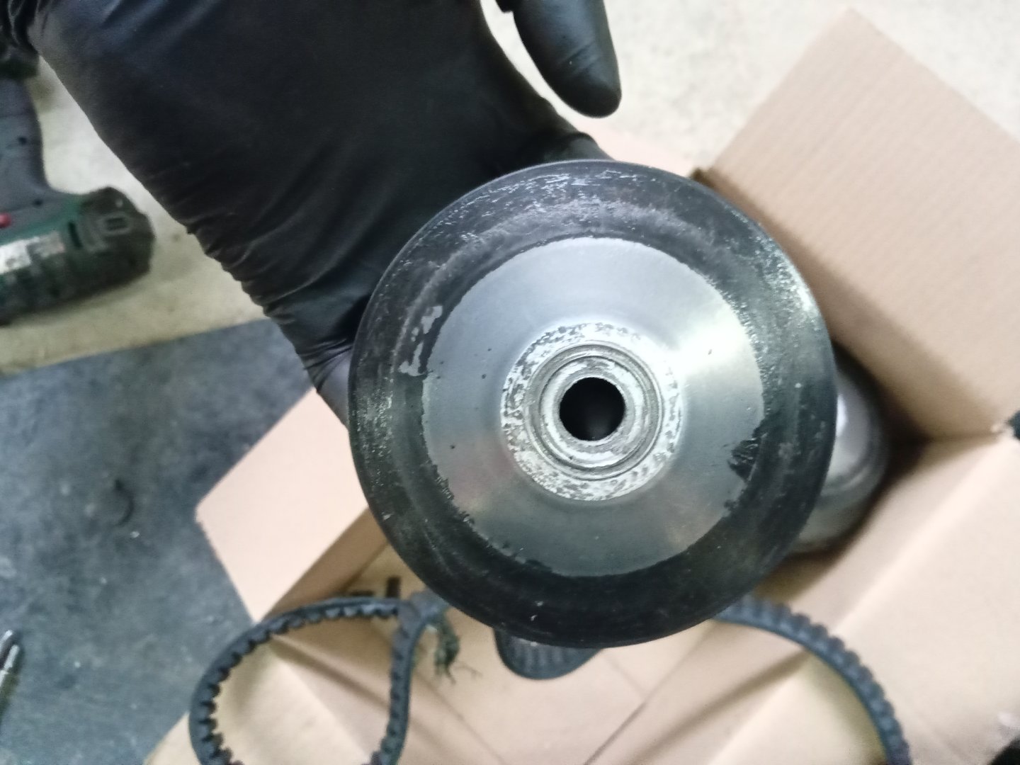

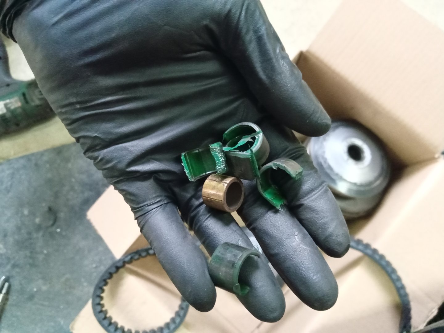

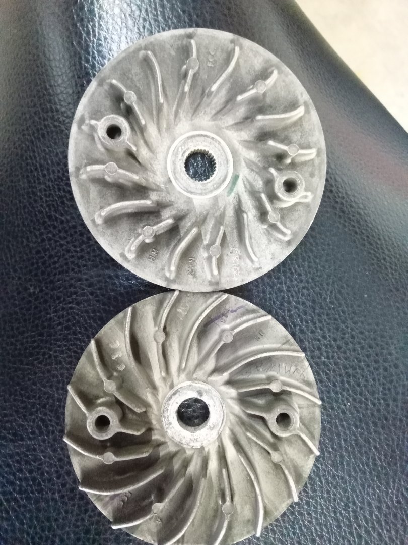

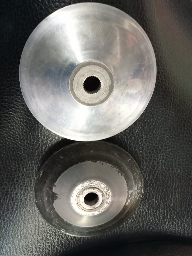

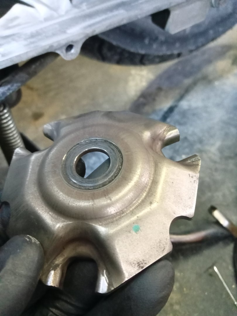

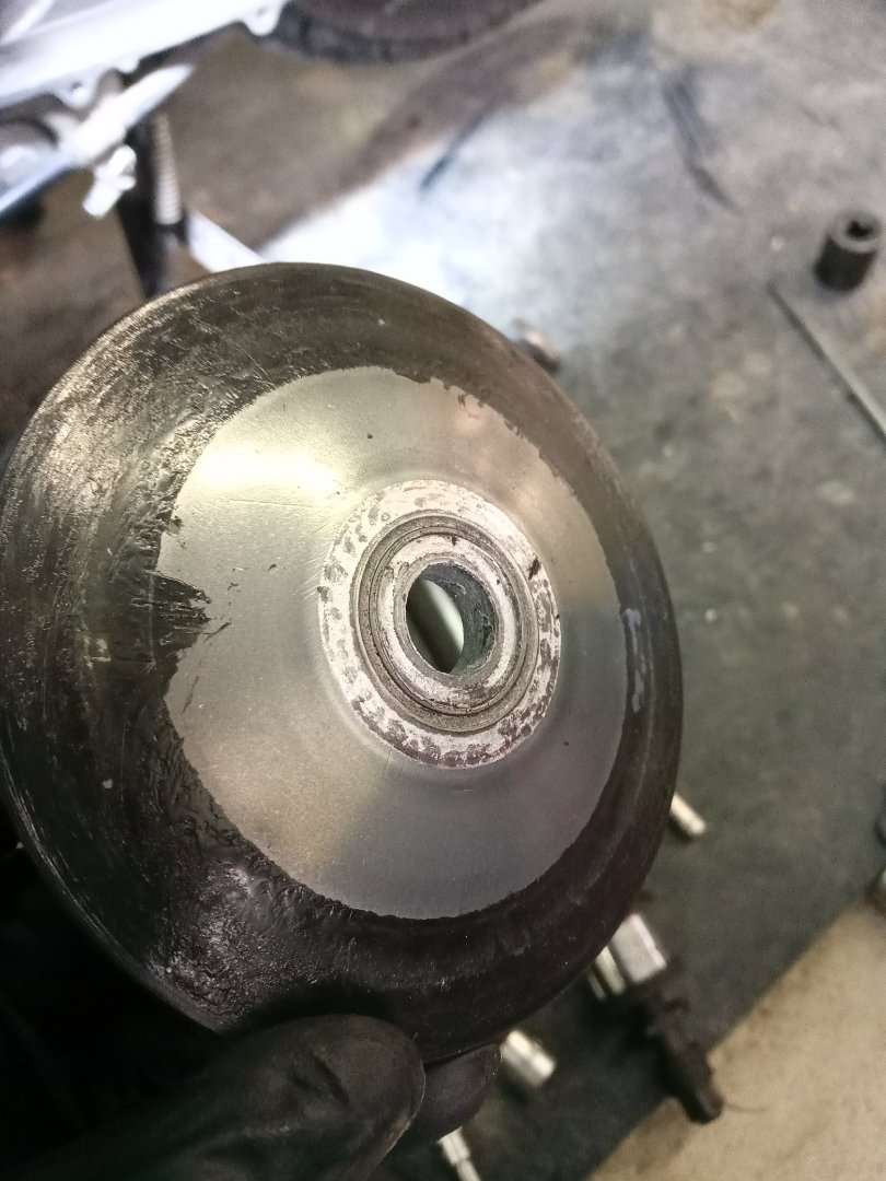

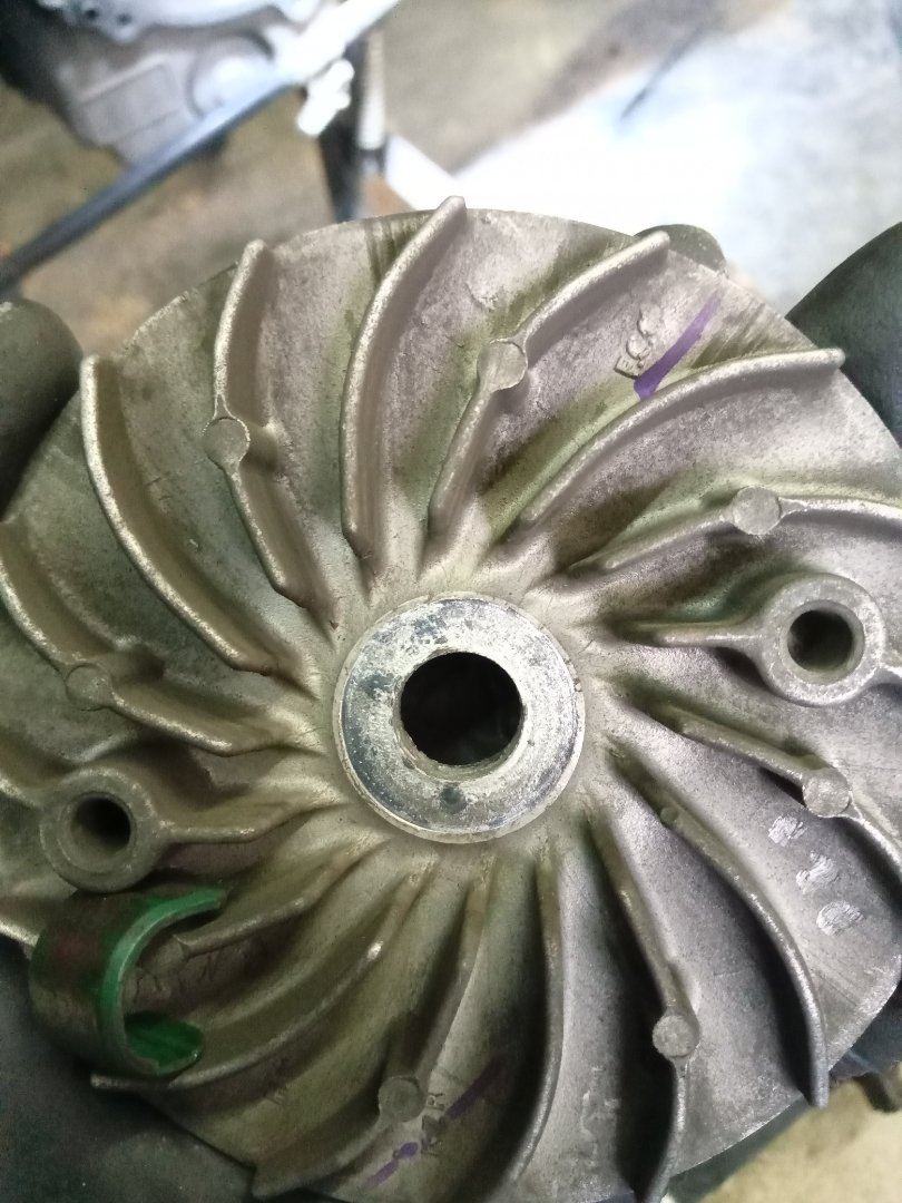

Yesterday was such a weird day. belt had 2000km, all of a sudden on the highway it was like this... I'm back on the road but this time only with 120 kh... I'll have to buy some new parts from yuminashi.

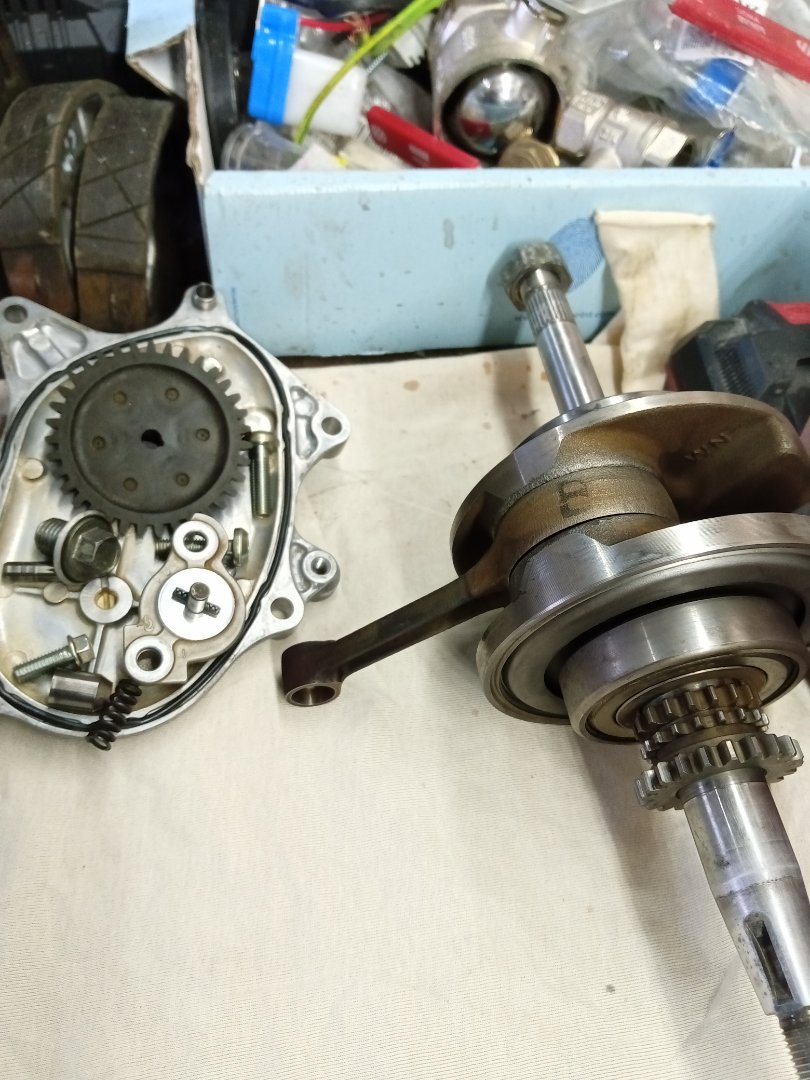

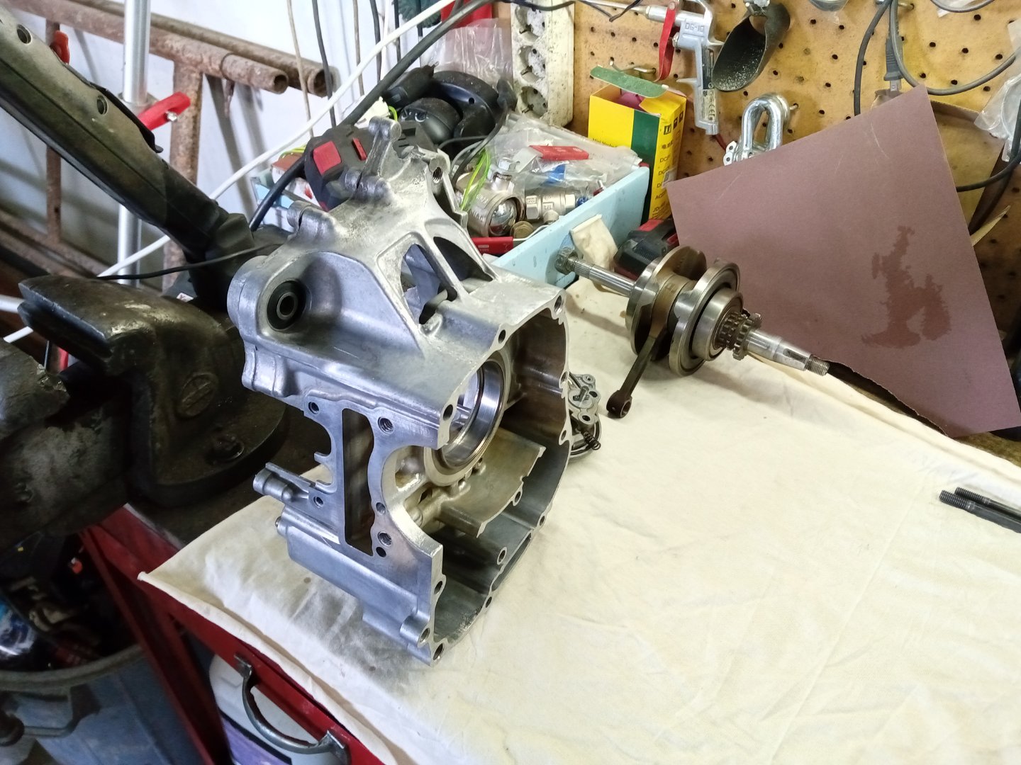

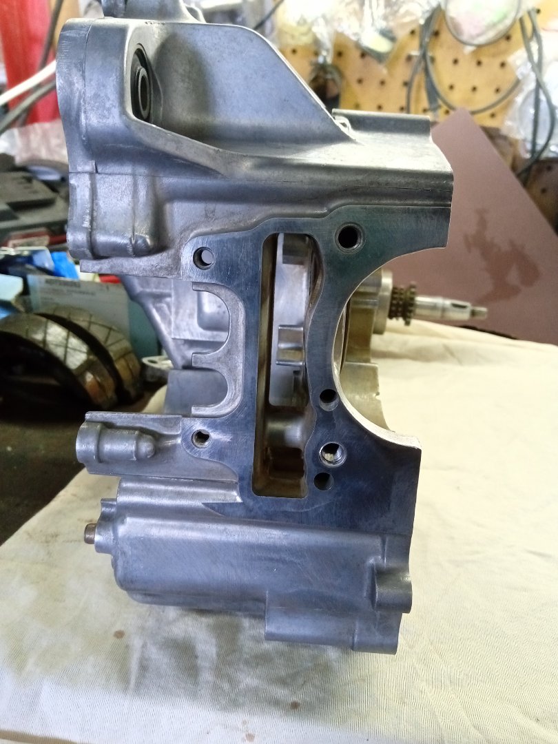

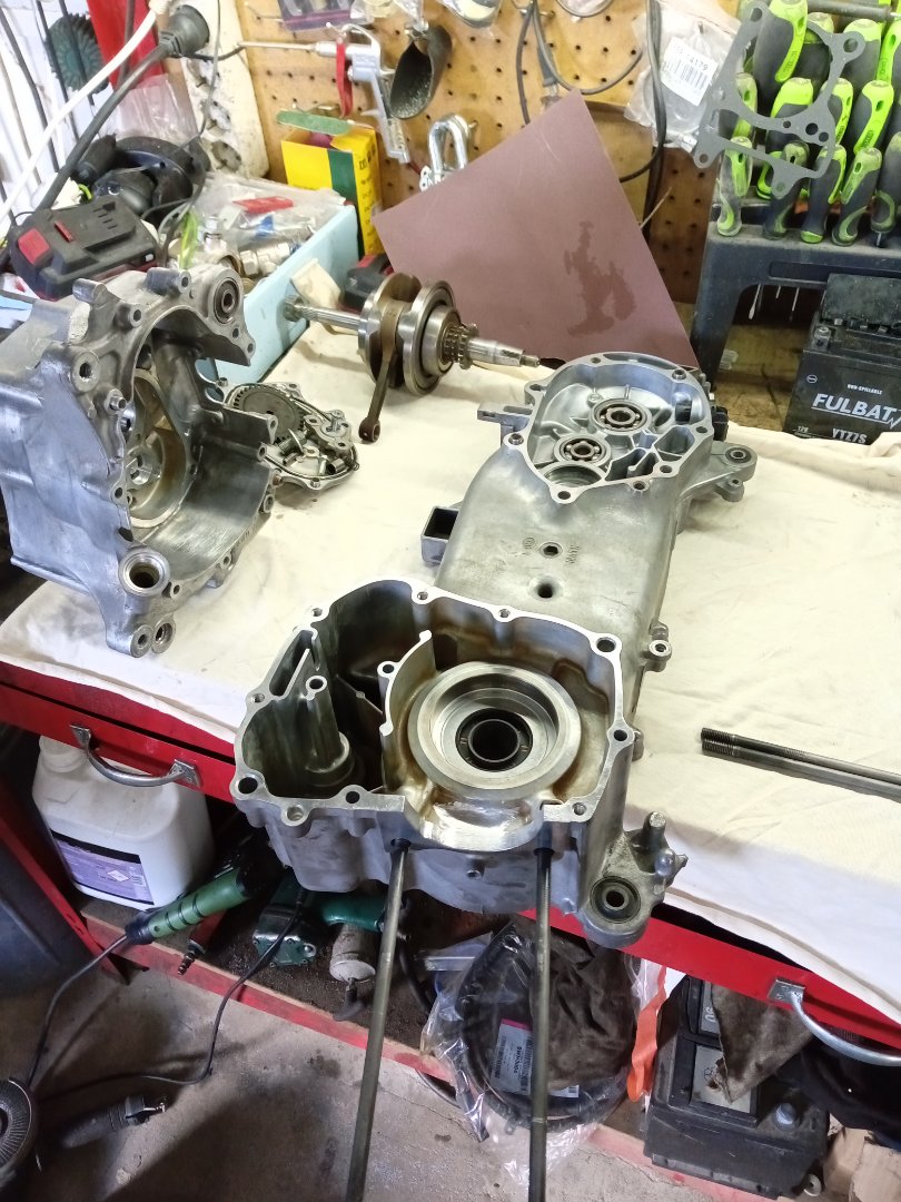

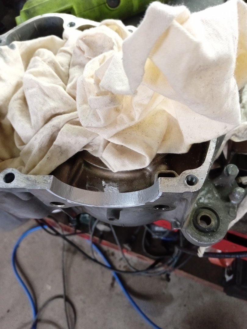

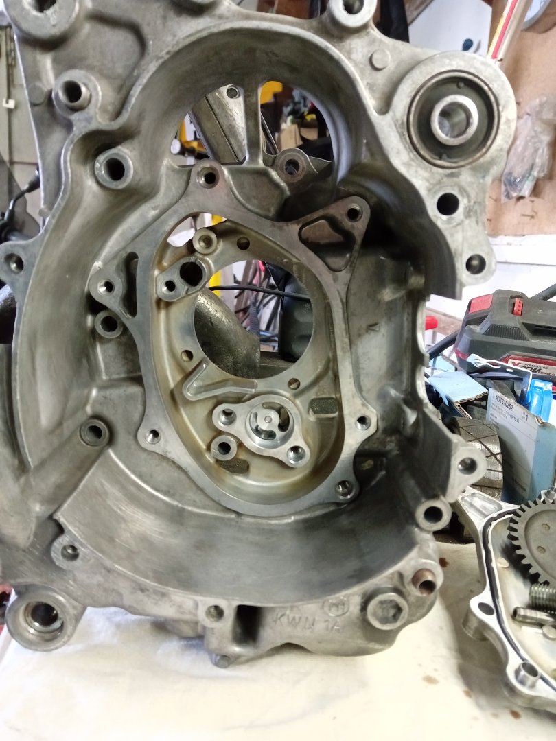

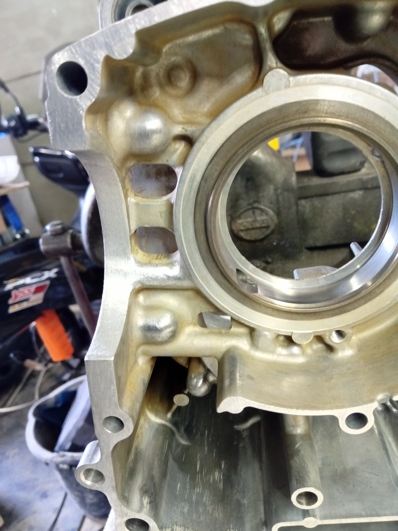

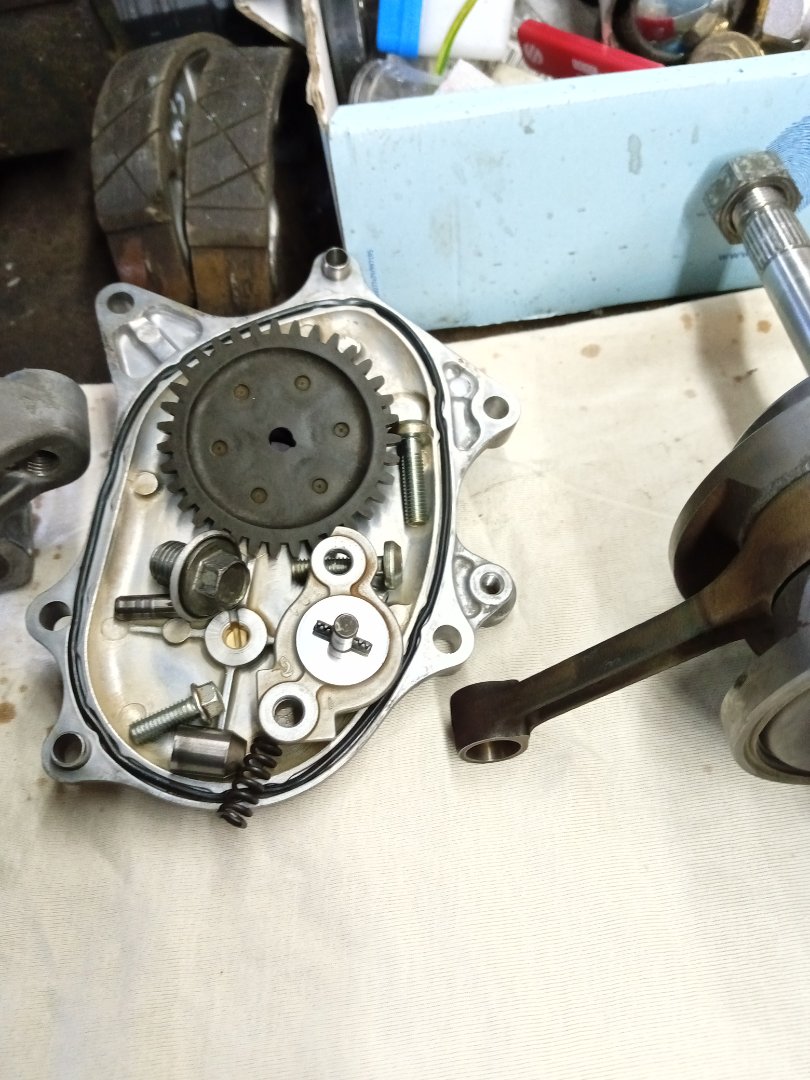

Hello good morning .. this weekend I started assembling the new yuminashi 164cc v2 kit here are some of the photos ..
mymitzi
Posts: 301
Joined: Mon Mar 04, 2019 6:05 am
Location: Delaware
Re: pcx power-full
Post by mymitzi »
Nice clean up...........will you replace with a Honda Belt or have they not been up to the task? Hope you get er going soon.
power-full
Posts: 280
Year: 2010
Color: preta
Re: pcx power-full
Good Morning. a yuminashi 164cc version 2 kit was assembled. this kit is fitted to 2010 engines up to 2018 engines .. in the non-esp version it is necessary to open the engine casings. an injector is included, I already gave a brief description of what will come out of here.

mymitzi wrote: Mon Apr 25, 2022 9:03 am Nice clean up...........will you replace with a Honda Belt or have they not been up to the task? Hope you get er going soon.
Hi i mounted one of Polini. I have another one of these from gates for this new kit.

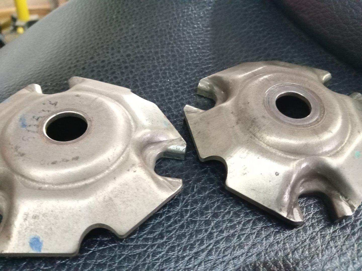

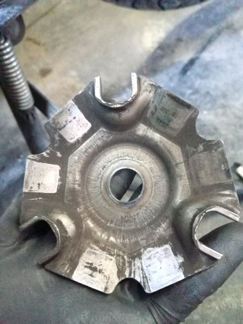

power-full wrote: Wed Apr 13, 2022 12:04 am Yesterday was such a weird day. belt had 2000km, all of a sudden on the highway it was like this... I'm back on the road but this time only with 120 kh... I'll have to buy some new parts from yuminashi.
Any idea what part or parts failed and caused the problem with your variator? Did one of the rollers come apart? Thanks!

hello good morning guys. I already have the new videos of the new kit assembled on my YouTube page. here is the last yesterday made just for walking I will have to adjust the weights of the variator
