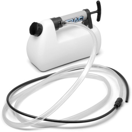

Thought I'd place these two fluid extractor's here, well....because it seems the proper place :D
(I re-use some of the extracted oil to clean tools, gardening equipment, and other misc doo-dads).
I own and have used this for oil removal: https://www.lowes.com/pd/LiquiVac-Oil-C ... em/1016407
I do Not own or use this, but it looks to do the job just fine: https://www.walmart.com/ip/TRAC-Outdoor ... r/27328297

WhiteNoise wrote:Thought I'd place these two fluid extractor's here, well....because it seems the proper place :D
Presumably you never need to undo the drain bolt then?
Nice idea, that gadget.
Wonder if we can get those here in Japan?
Thanks for the heads-up.
http://www.fuelly.com/motorcycle/honda/pcx150/2015/staninjapan/408151]Image

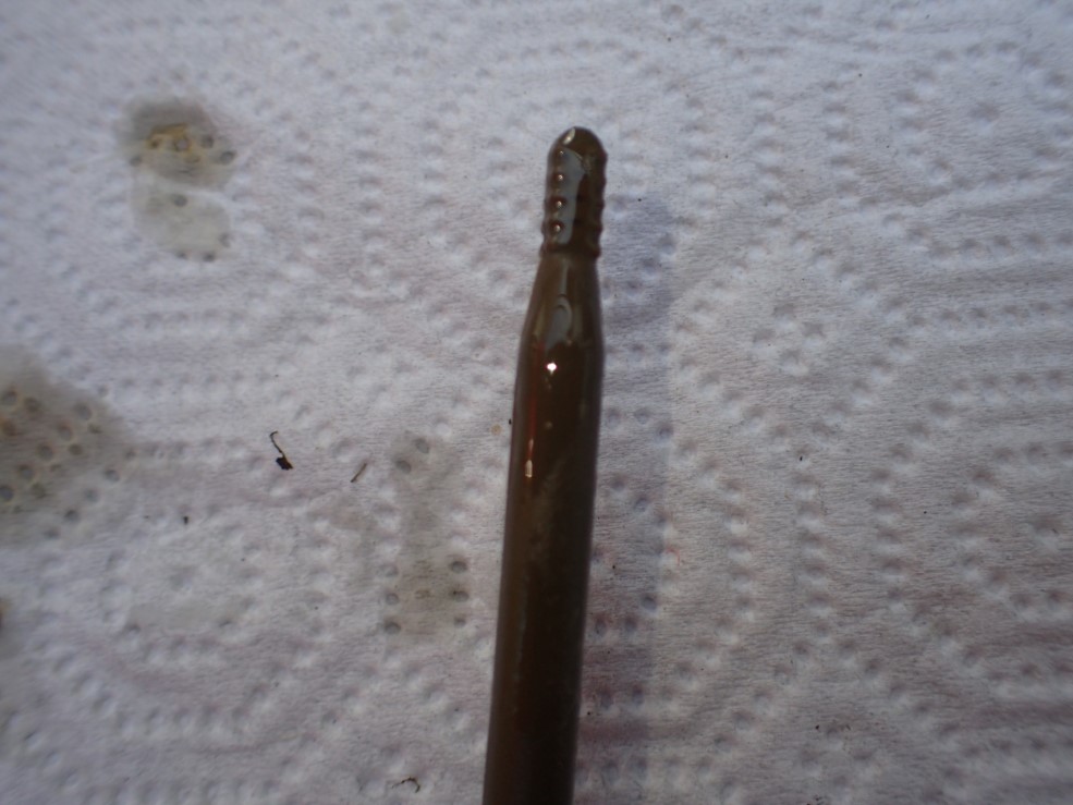

My small contribution is to stick a piece of aluminum tape to the face just behind the drain bolt. This did a great job of keeping the oil going where I wanted it.
I still made some mess, but not horrible. I did not clean the screen filter.
The weird thing was that I added around 700 ml of oil, then checked the dipstick, and seemed very full (oil all the way up the stick!). I measured the dirty oil and got a ballpark 750 ml (plus the mess, so maybe 780ish). I measured with the scoot on the center stand. I also ran out of daylight, and so will further investigate tomorrow morning.
So - proper measuring technique is scoot reasonably flat fore and aft, on side stand, dipstick just placed into hole, and oil only on the crosshatch part of the end. Do I have anything wrong?

Good tip, You². Let it run for a bit, checked, and needed to top up a bit more. Still overdid it. You need narrow tubing to get in to suck out the excess (1/4" OD worked - 3/8" did not). Perhaps I'm being too anal, but level is very finicky - 40 ml makes a big difference.
And 40 ml later:
Re: How-To: Oil Change For Honda PCX
George, yes do what 2you's said.
I like the level spot on too! :oops:
If excess is still present on dipstick, I use a "drinking straw" to suck it out. With a "small plastic cup" on nearby
....and "it goes a little something like this"
Place straw into dip stick portal, place finger over straw opening, then pull straw out (oil will be inside of it) grab that cup and place straw over it. Release finger. Excess in cup.
Repeat if necessary
Rechecking level as you go.
