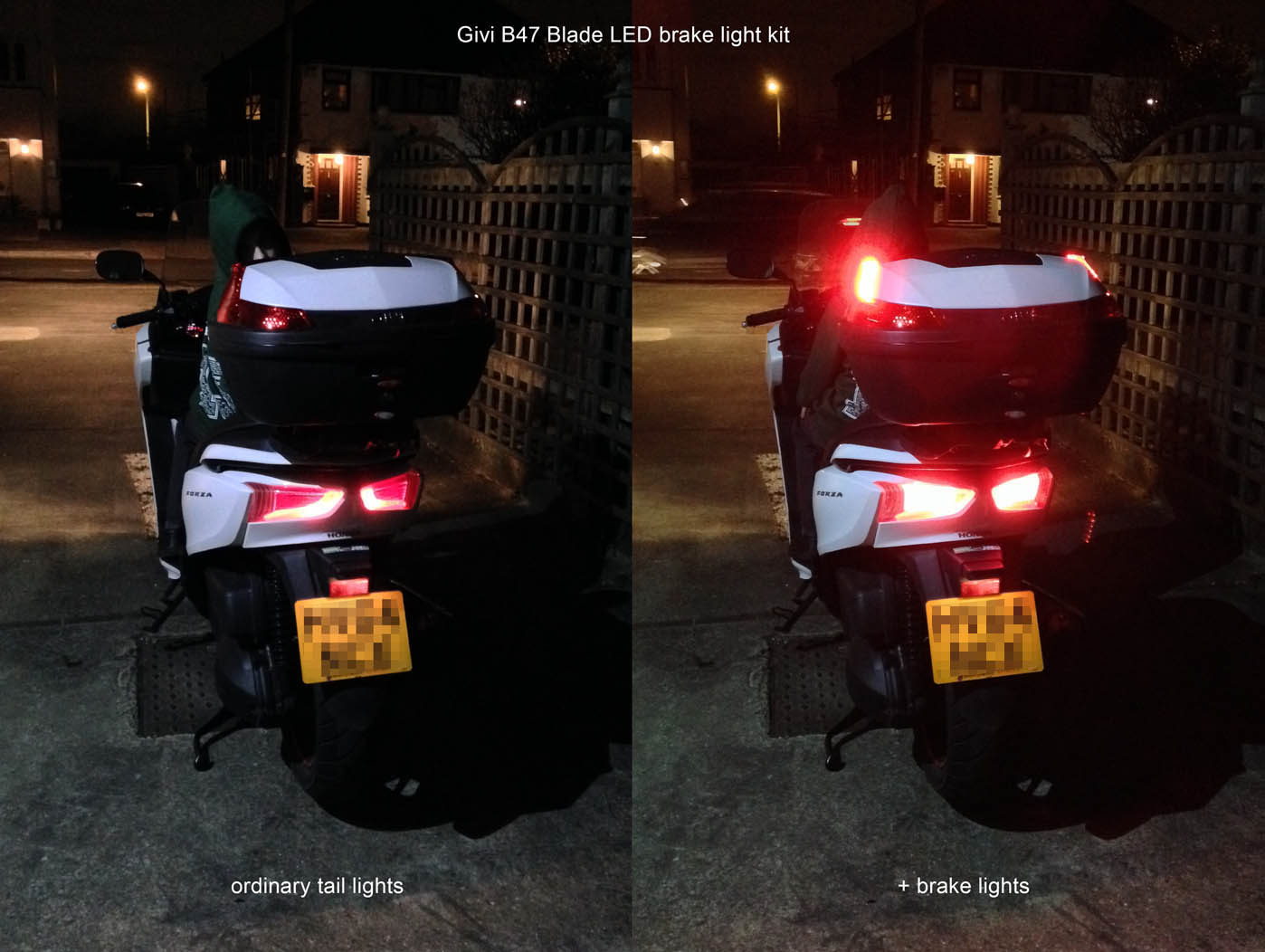

I forgot to follow up on this thread. To cut a long story short, I got the GIVI LED brake light kit connected up and working, albeit the supplied connectors were a little temperamental and needed packing with rubber washers and balled up paper etc. to keep them in position, but kept failing to stay in position sufficient enough to be reliable, so I dumped the whole idea of routing the wires across the end of the topbox that opened using Givi's supplied contacts and just rerouted the internal wiring around the back of the topbox, across the hinge instead, so that it stays constantly connected with no need to use the stupid spring-loaded connectors supplied by Givi. This is simply bad design on their part.
I am now happy that I can rely on the auxiliary brake lights on those dark, yet busy country roads. Here are the working lights. As you can see, due to their side-mounted positioning, it doesn't take much of an angle before you lose sight of one of them, however it does mean that they can be seen from the side of the bike also, which perhaps isn't the case for the original brake lights inside the main light cluster.
- Both lights are clearly visible when viewed from directly behind.
- Brake_light_Givi_02.jpg (133.5 KiB) Viewed 2365 times
- Slight angle showing how the side mounting position of the Givi brake lights means that you can easily lose sight of one of them.
- Brake_light_Givi_01.jpg (143.53 KiB) Viewed 2365 times
