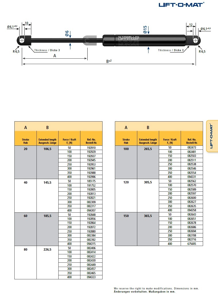

Why not? We need details of your old part BRed. The gas springs start from 106mm and the increment is 40mm. What is the diameter of both parts of it & how long is it measuring from the ball stud holes (fully extended)?

Never mind about the fully extended length BRed. The measurement when the gas spring is fully compressed is crucial too (measuring from one ball stud hole to the other). That, along with the thickness of the two parts and the Newtons (as I see from the second picture it says 500N of force) and we can be sure which one is it and which one to choose for a better replacement.

Well, with the facts you gave us, the best choice would be the one highlighted (115mm compressed length & 40mm stroke & 400N, as for the Newtons & the thickness, we don't have much of a choice, if we jump to a thicker one/stronger one -19mm cylinder thickness with 145mm compressed length, 60mm stroke & 500 or 600N or even 700 or 800N- it won't let the seat close entirely because it is 90mm longer):
- Lift-O-Mat Gas Spring.png (126.48 KiB) Viewed 4838 times
- Lift-O-Mat Gas Spring.png (116.6 KiB) Viewed 4838 times

Update: the "0500N" on the cylinder means it produces a force of 500 Newton. So, we can not choose something weaker! I will order the product with Reference No.: 2617NL (145mm fully compressed, 60mm stroke -it can push the seat way up-, 19mm of cylinder thickness & with a force of 600N).
