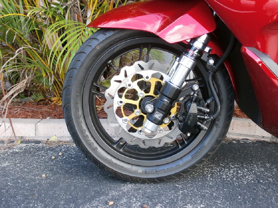

Relax, its one set (2 emulators) I found 2 turns in good for me at 190lbs, go by your weight and driving style and whether potholes roads are a frequent issue. For most riders 1 or 2 turns in is in the ballpark
