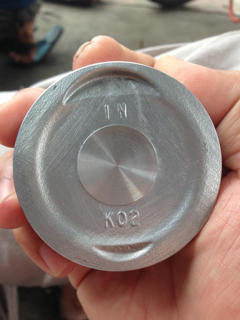

The difference between a 150 esp head and a 125 esp head is the dome area is a little carved out to drop the compression ratio.
the head of the SH 150 piston also reduces compression.
this is a picture I get online
I wonder, just wonder, if I can perhaps put in a new Sonic piston with the SH150 head (29mm intake/23mm exhaust) and use the yuminashi camshaft + a new set of rockers and sonic valve springs. The compression would be a little below 12 but above 11, using thin gaskets also. Wonder if the sonic piston which has a high head will touch the valves.
Too many options :?

That picture is terrifying. btw is that a 150 head or a 125?
You can buy yuminashi camshaft. Pick the RR version, reggy said it's compatible with esp 150cc engines. I guess, pop in the entire 150 head with double springs, slide in the yuminashi RR cam and you're good to go. Not sure about the 60mm piston that comes with yuminashi set as he said it's for use with 125 head and the pocket on the piston may need to be machined a little.
Yuminashi set has about 13 or more compression ratio. My mechanic said it's batsh*t insane :lol: . Wonderful power and fuel economy though.
