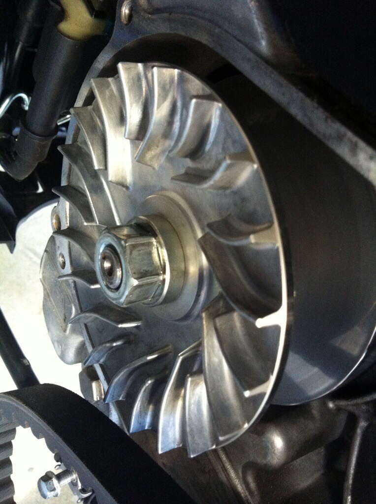

Here is a pic of the tick washer. It is behind the nut.

The washer is in the correct place.
There aren't many threads of the crank showing through the nut. I thought they should be protruding slightly. I've tried to find a decent photo of what it should look like to compare. It might be right but if the pulley is out of line with the rear pulley it will damage the belt in no time.

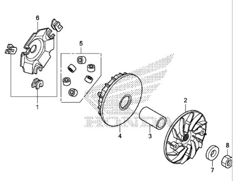

I found these photos. The nut is on further onto the crank. I would check the alignment of the pulleys.
I am presuming the nut was tight of course on your picture.

I've looked at the workshop manual and it only shows a diameter of the boss not the length. I'm going to fit a Takegawa pulley tomorrow hopefully so I'll measure the boss on mine. It's a 2011 though so I'd need to check the part numbers to see if they are the same.

The lenght of the standard boss is 47.5mm. Some variators
use longer (50mm). You should use whatever came with the kit.
