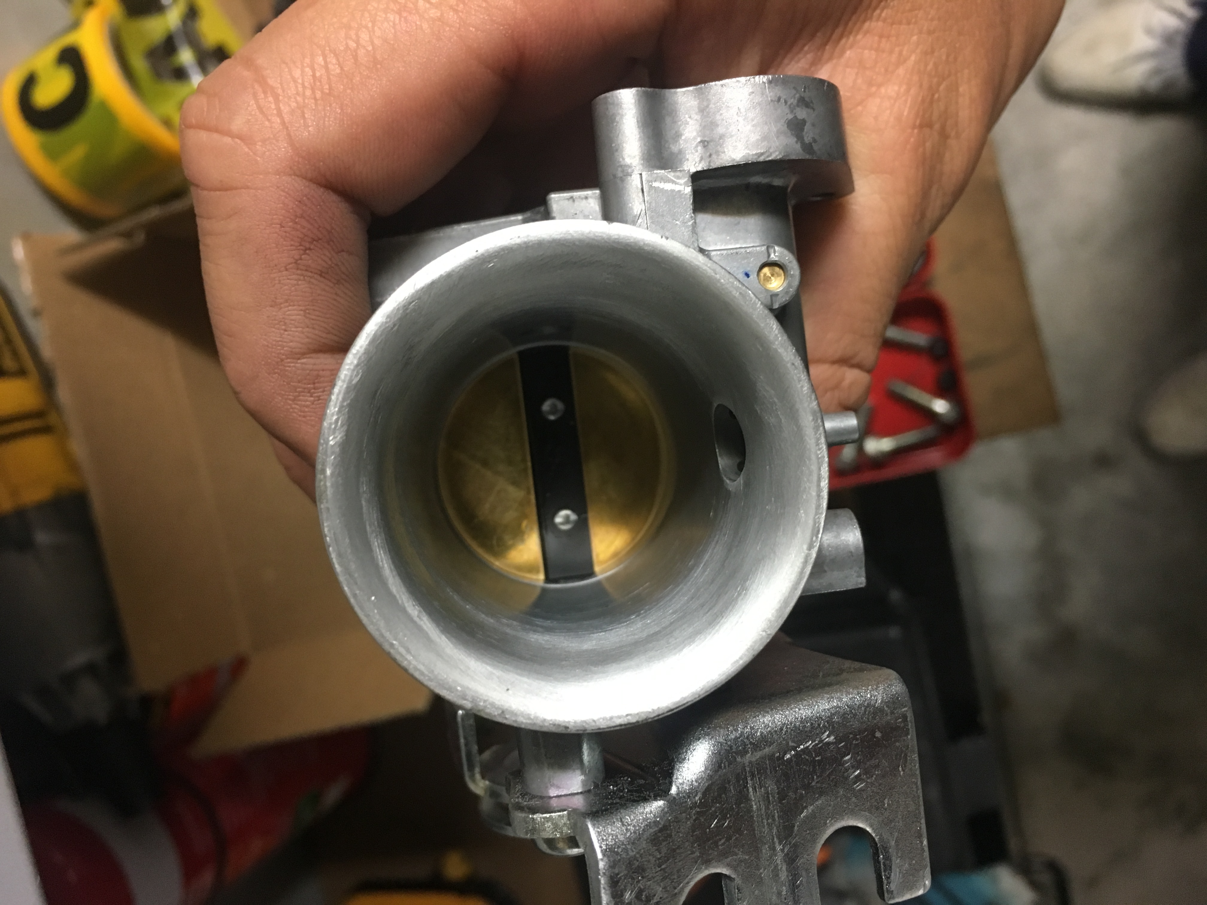

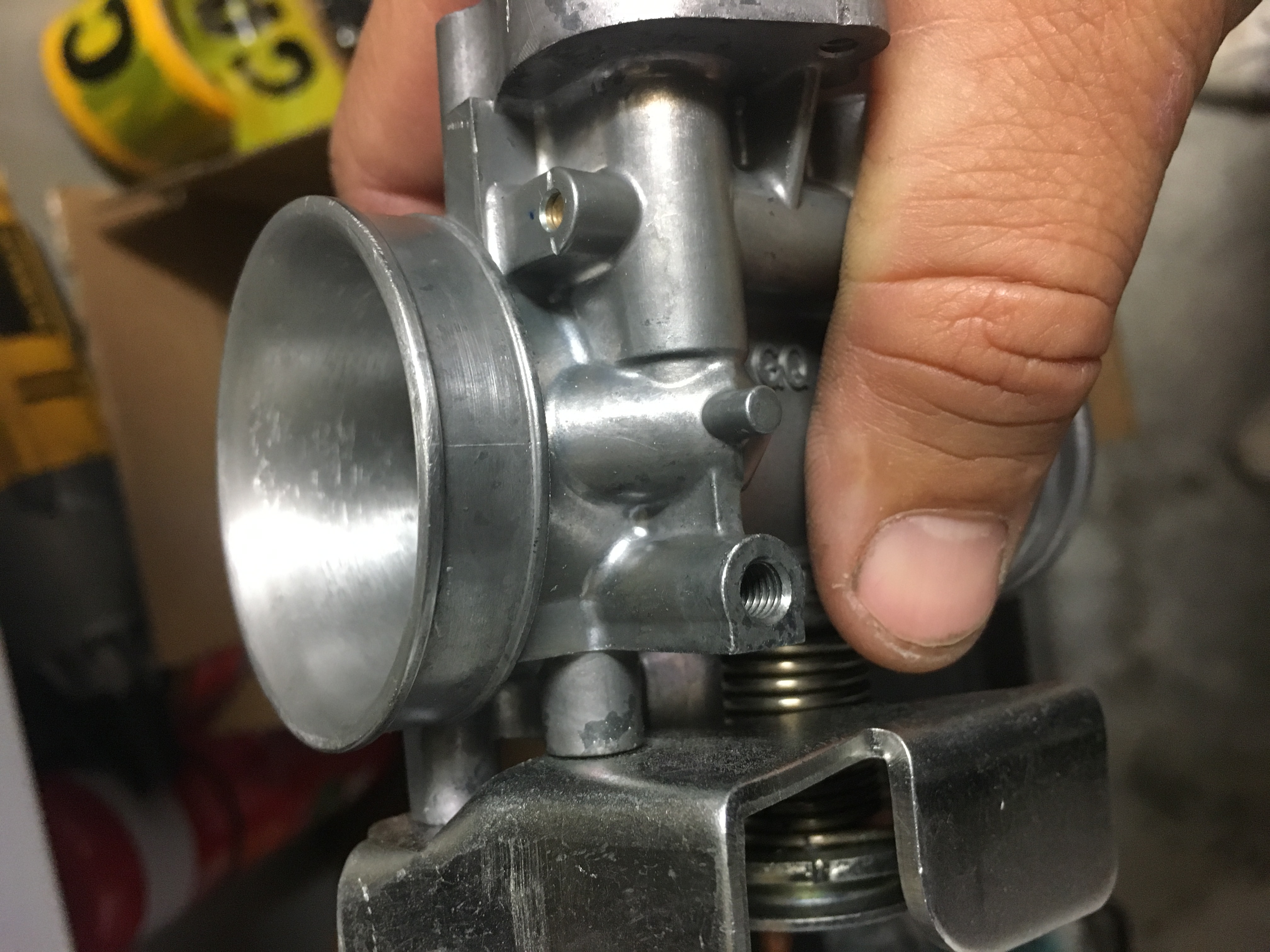

I didn't like the fat lip on the stock 35mm tb as I thought it would hinder smooth air passage from airbox hose in to the tb itself. So I've decided to use some crude tools to taper the edge in to funnel shape. This way now there is a smooth transition for air traveling from the air hose in to the tb and engine itself.

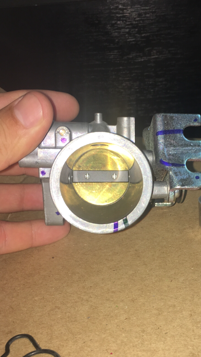

Original shape

Post by Pcxdemon »
Different angle

Does the 35mm TB have the same OD on the inlet as the 31mm TB, of about 46mm?

Post by Pcxdemon »
38mm on the intake side. I've gradually enlarged it to 40mm and at the top of the taper goes up to 45mm..I could do more all round but it's good as is now..
