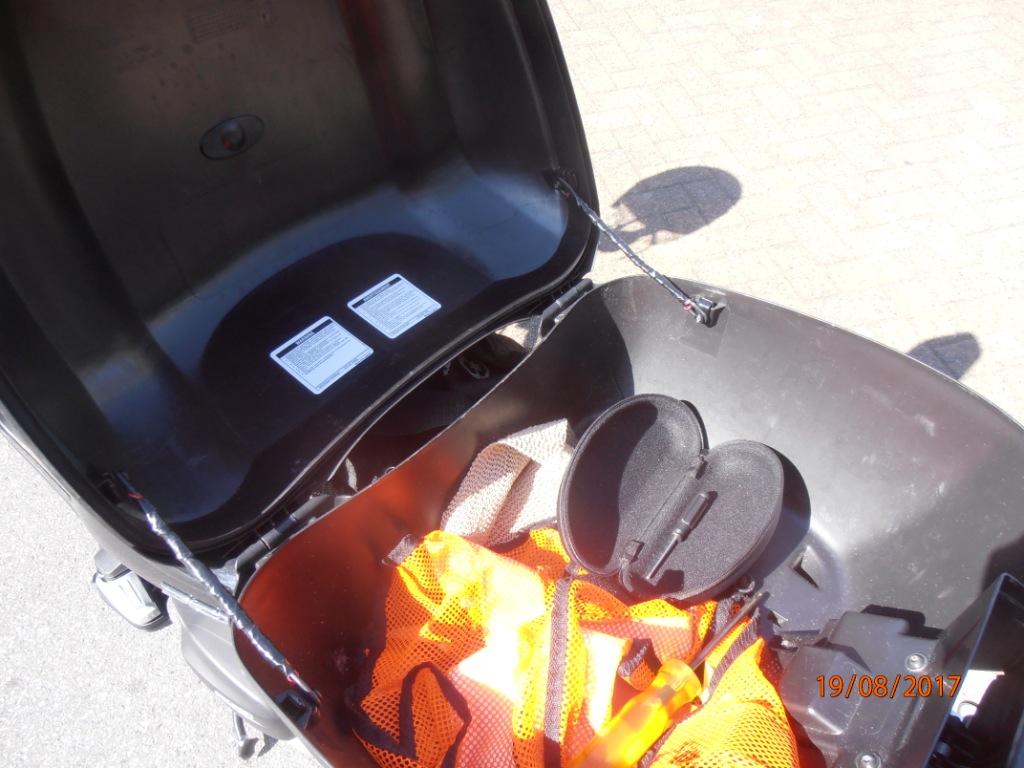

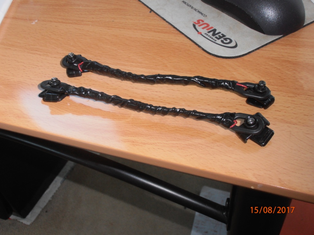

well I created another version of the MacGyver fix with some glue, wire wrap and electrical tape. I'm sure the glue will not hold up, but the wire and tape should keep it together.
If this version fails, I'll likely try the idea by PCX150Rider...just need to pick up some lugs

Re: Broken Honda trunk box
Xixon, I like your fix. It should work fine, and probably better than OEM. Nice job!

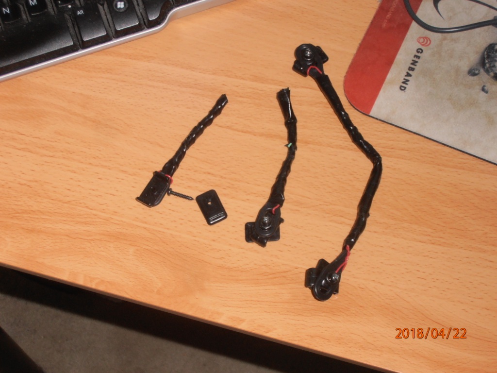

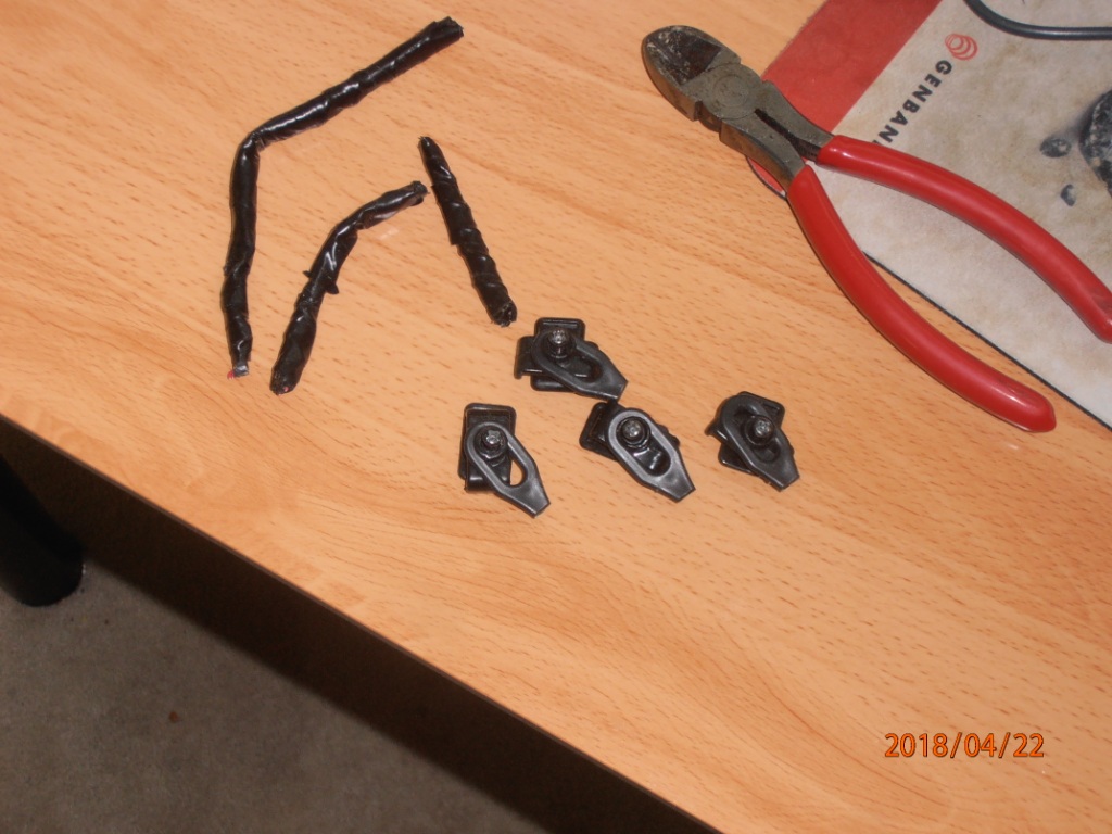

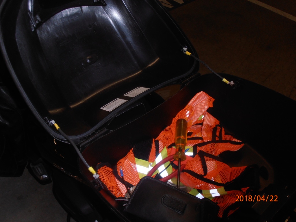

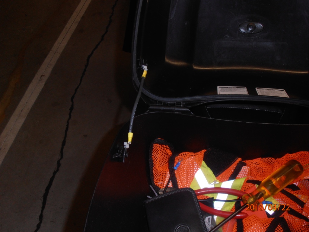

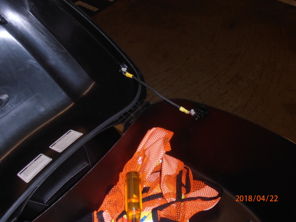

Well my MacGyver fix lasted 8 months....so this time I used the idea from PCX150Rider
I've used 10 AWG stranded wire with connectors....I first just removed the old arms but quickly found out the strain on the ty-wraps holding the arms was too much.
I have cut off the connecting clips, as they have a slot to slide so I think this will put less strain on the ty-wraps
I believe this MacGyver fix will last much longer, but the ty-wraps will eventually break, so that why I doubled them up...I may consider replacing them with something more durable
