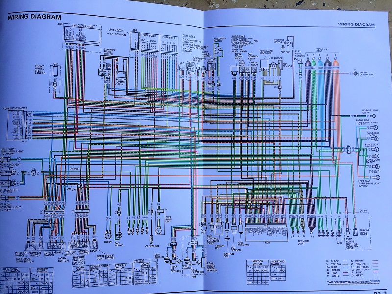

Here is the wiring diagram (800x600, hoping it is showing good) :knick620 wrote:Thanks for all of your support guys, excellent intro to the forum as a new forza owner and member.
Well it was the 10A fuse under the rh glove box. a couple of photos to clarify the issue for any other owners with the same problem.....
Now if any of you are able to advise on a workshop manual DL!!
- Diag Forza (2).jpg (296.68 KiB) Viewed 2232 times
