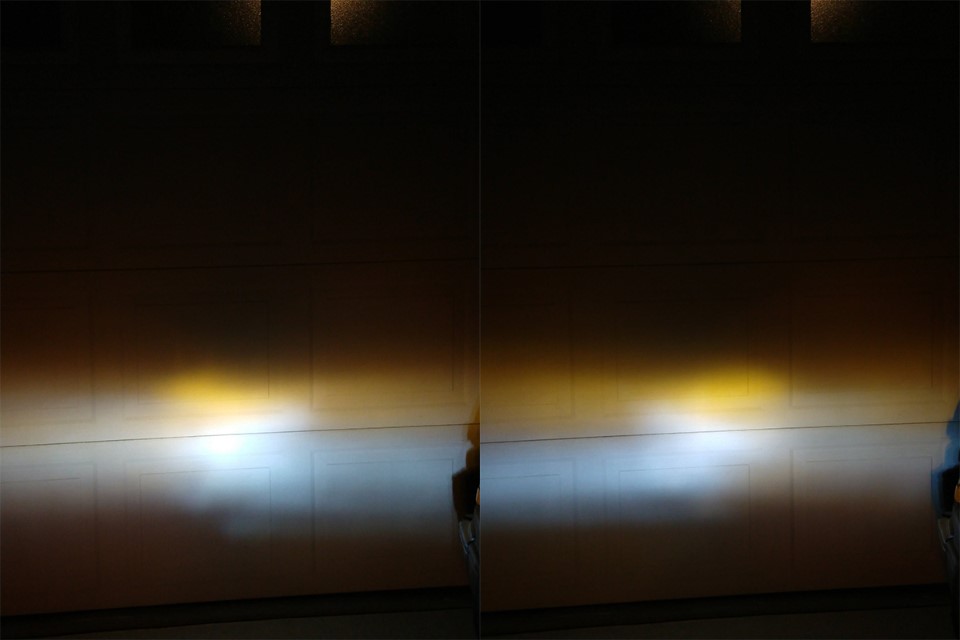

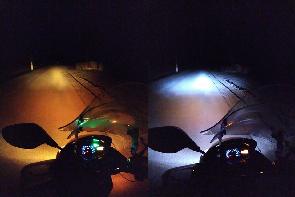

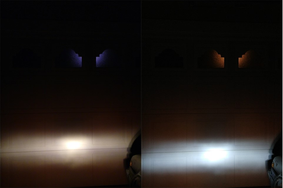

I did some night riding around my town to see how effective the LED lights are and I'm pleased with what I have so far.

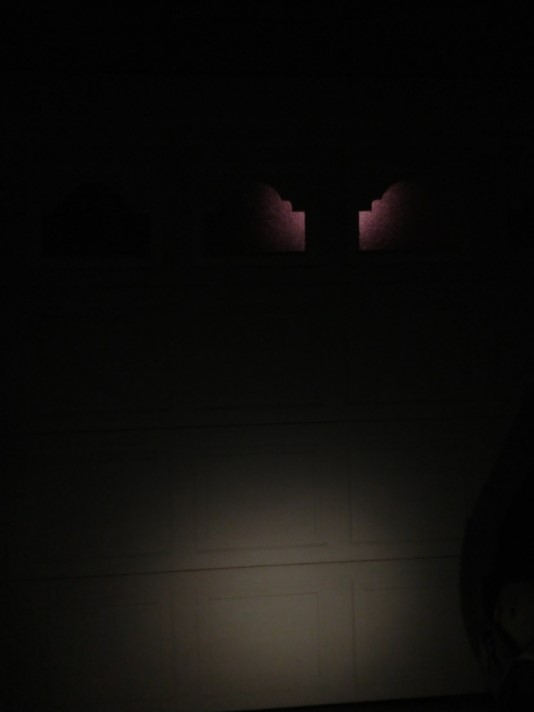

The cut off line of the lights might not be that great, but it might be good enough. The High beam works, I would say like stock. The low beam is good, but I don't remember too wheal how the stock beam was, so that will need some before/after comparison. My cellphones camera couldn't capture the shadow details, but it does give a good idea of how the light projects.
As for the color of the lights, the yellow 3000K is very yellow. The 6000K "white" light is a bluish color that gives a lot that blue glare when looking at it. For the final project I will set Yellow as my low beam color, as I find it very pleasing to the eye. Studies have also shown that Warm White headlights are better for the eye, less stressful. I can look up some sources if anyone is interested.
In the following image I locked the shutter speed and ISO settings on my phone, no clue on the f-stop.
In this garage picture I didn't lock the white balance, which you can tell by the color of the light coming through the window.
I did lock the shutter speed and ISO setting on my phone, no clue on the f-stop.
The headlights are bright when compared to the light from my 10 watt driving lights.

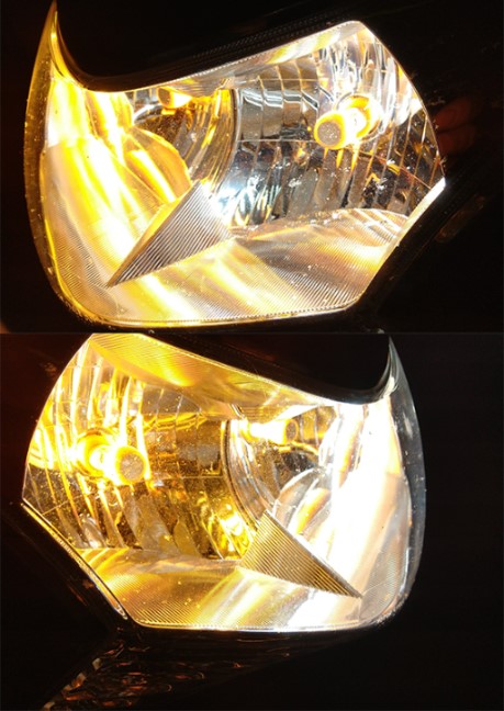

After flicking the lights from Yellow to white a few times, they fell out of sink. One is Yellow and the other is white. It does highlight the difference of the Hi/Low light beam and the color difference.

As a note, you may want to shoot against a distant wall from a fixed distance and using the OpenCamera app lock the camera settings down and compare the stock light beam pattern to the LED.
That's a great idea, I'll be doing that for the final judgement. I'll be looking up instructions on how to adjust headlight beam as wheal. I just installed the OpenCamera app, lots of great features. My phones camera can't capture the light above the beam cutoff line.

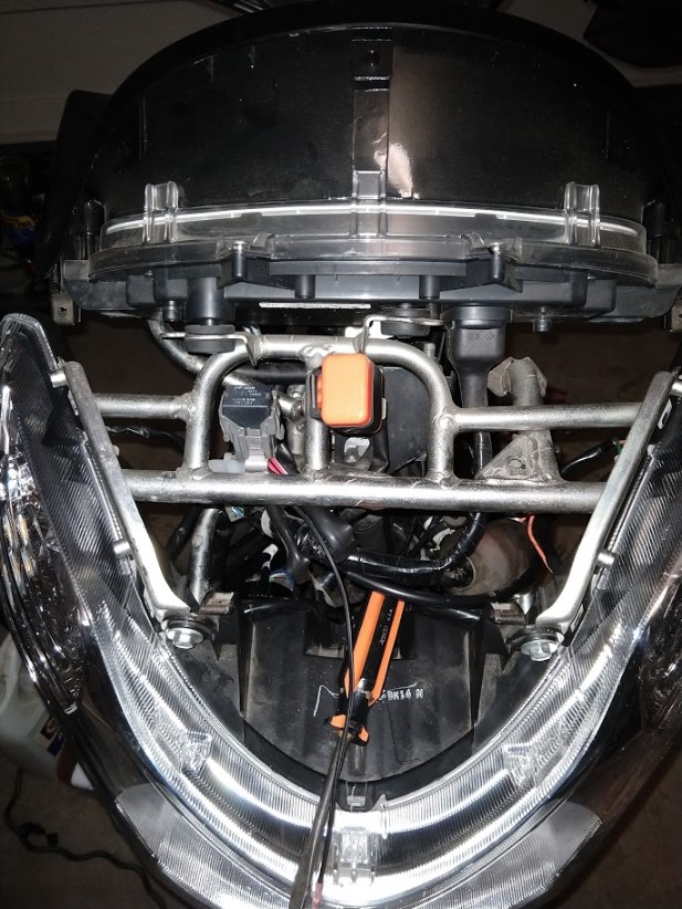

Turn signal flasher
Here is a pic of where the blinker relay is located. It just plugs in. This is the 99 cent eBay one. It's the bright orange relay in the image. I added some electrical tape, as the plastic mounting bracket on the flasher broke.

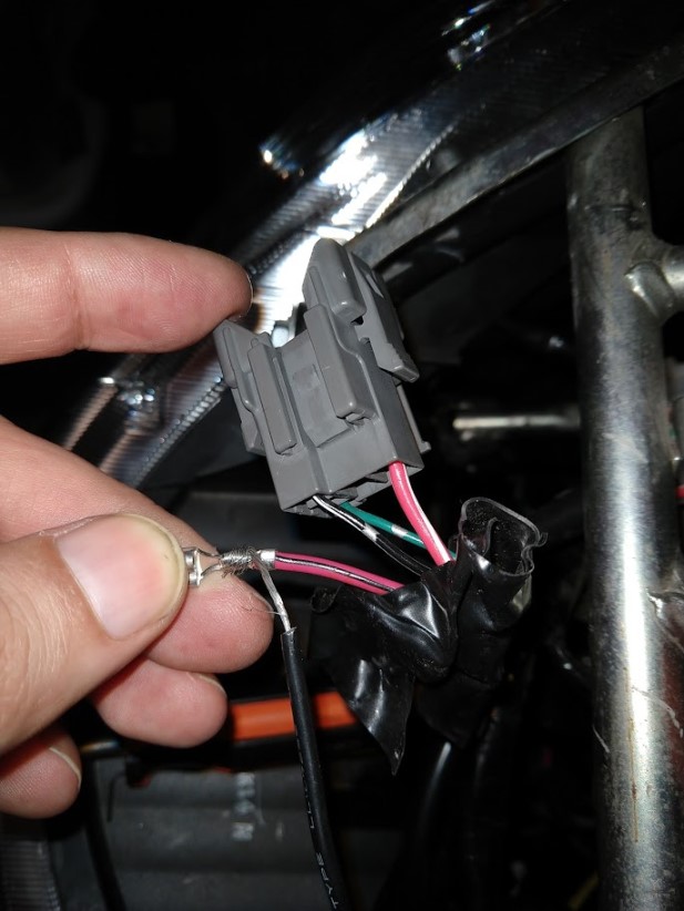

Cigarette lighter receptacle
I wired my cigarette lighter/(auxiliary socket) to the main relay, specifically the Red/Black wire.
I soldered the wire onto the spade connector for a more secure connection. By the way, I didn't have an issue with the wire wrapped around the spade connector.

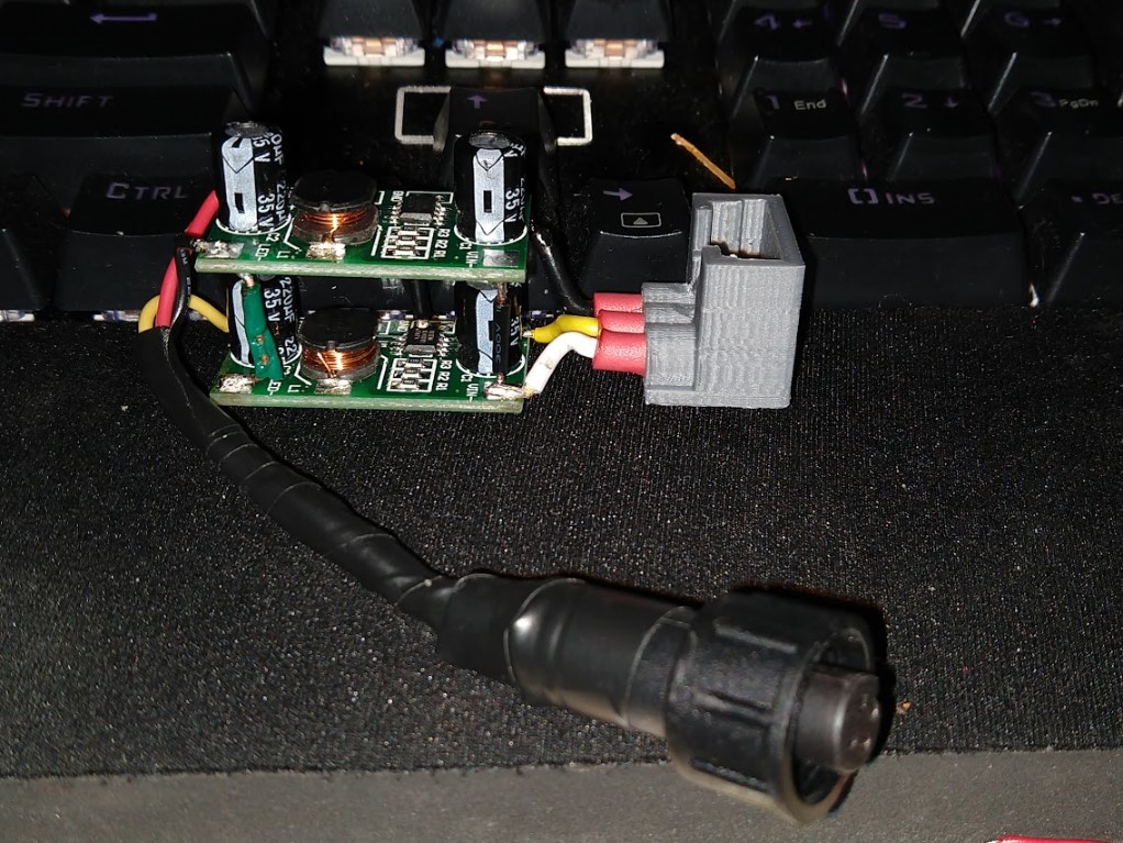

LED voltage regulators
Finished the LED drivers, now just making a case for them.
Just as bright as before.

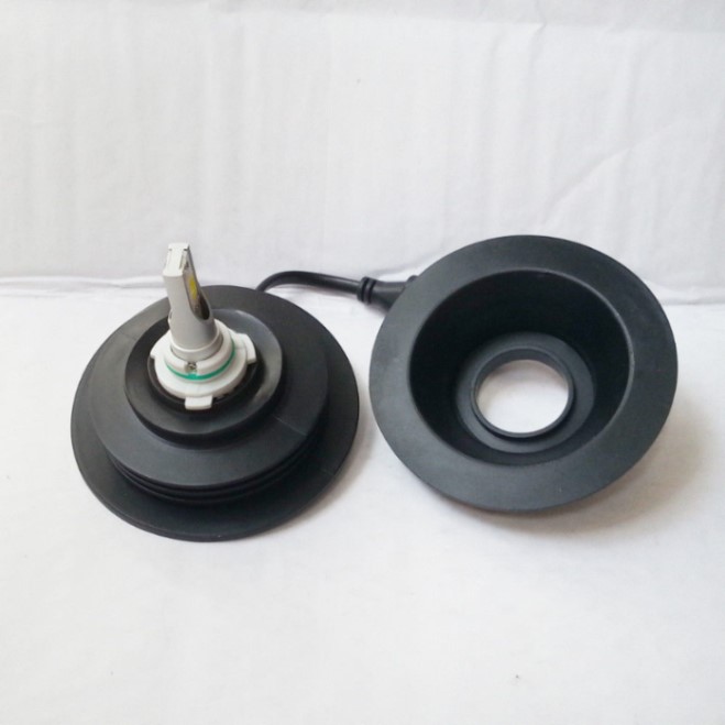

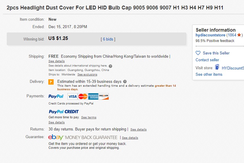

Found a nice looking dust cover rubber boot on ebay, not sure on the quality though or the size. It might need some trimming to fit the pcx.
It's another option.

That's really very nice, thanks for sharing that, I never thought to look on eBay for those.
