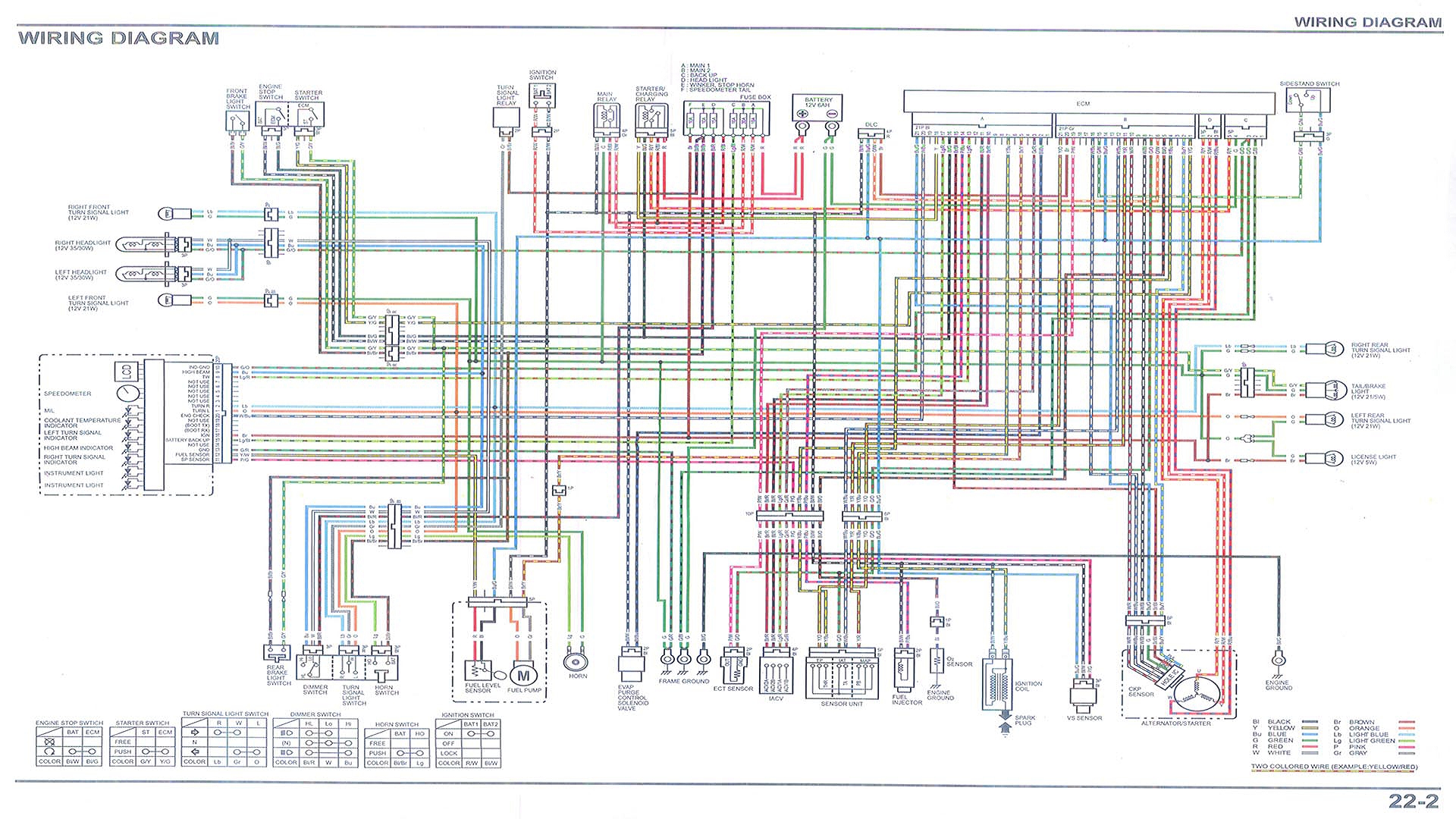

Posted: Tue Jul 09, 2019 9:18 am
Check your wires for continuity. The green is always ground. Both sides of that switch go to the ECU. See if you can pull the plug to the ECU and make sure the wires have a good connection to that plug.
There can also be multiple issues at the same time, so check your other switches as well (such as the left brake switch, which for some reason has more problems than the right one most of the time). Look at the entire wiring diagram to trace down possible electrical problems. Definitely check all of your fuses first.
You may or may not have this already, but here is another copy, just in case.
- 20181212_153554.jpg (1000.63 KiB) Viewed 3340 times
