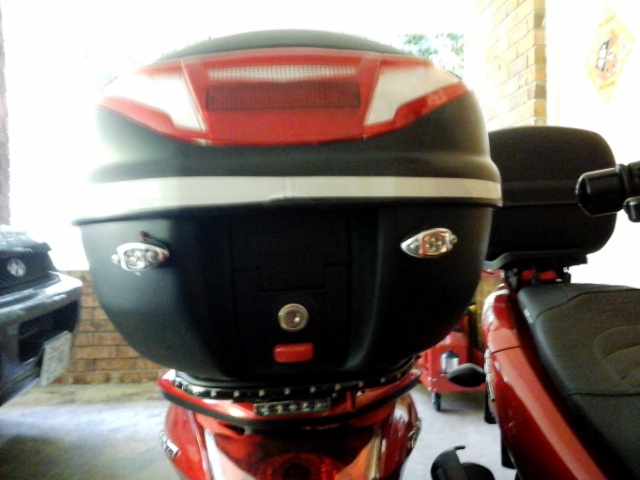

WhiteNoise wrote:Yeppie, I see the pics now! Nice!! So do tell, what's the wire coming out of your top box?
I would guess it is for the lights on the top box.
Re: Honda OEM Rear Trunk Base, 2013 one-piece metal version
Posted: Fri Jun 13, 2014 3:13 pm
by 6ftMach1Girl
Yes. When I can take a decent video I will post. Has modulated brake lights as well as turn signals. AdMore Lighting.

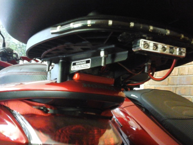

Why do it that way? There is an outline of a hole on the bottom of the Givi box the lines up with the outline of a hole on the underside of the Givi plate. I drilled out the holes and used a multi wire quick disconnect for the wires. Then I connected everything under the rack in a protected junction box so that I can disconnect the whole thing easily, from just the top box, to disconnecting everything so that the bike can be taken apart. I also have lights on the rack plate, which I also connected to the junction box.

Here are a few pictures of our light setup. It is probably not fair that I was an aircraft electrician in the military and a computer engineer after that, so this is sort of a hobby for me.
First I needed to determine what wires went where and had to get a terminal block.
Here is the protected junction box and theadditional lights on the tailrack.
...and the tailbox lights.
