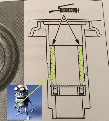

Holy crap that guy in the video used the grease packet to put 1.7 grams grease under the seal collar on the guide rollers but I didn't see him put the 7.3 grams of grease (the bulk of that packet) on the inner surface between the bearings (these kits don't ship pre-packed with grease) that's why the big packet of grease.
Maybe he says he did it, but if he didn't he's running the bearing pretty much dry or with what little the factory put to keep them from rusting in shipment. Tell me you used the bulk of the grease packet in between the wheel bearings as shown in this picture.

Thanks Homie! The note that came with mine asked me to apply 15g of grease in the areas. Mine came with in a tube exactly like this:
And the tube contained indeed 15g of grease. I thought that was a bit too much, I I emptied about half of it into those areas. According to your diagram, it might have turned out to be right after all!
Re: Rear Wheel noise
Good man, you have a natural instinct that serves you well. Pays to read the service manual and not be totally reliant on notes in shipping packages not directly from Honda. Also we've learned not to trust youtube video mechanics that might be adding, omitting information or working dangerously... wait I'm a YT mechanicprasannar2009 wrote:Thanks Homie! The note that came with mine asked me to apply 15g of grease in the areas. Mine came with in a tube exactly like this: And the tube contained indeed 15g of grease. I thought that was a bit too much, I I emptied about half of it into those areas. According to your diagram, it might have turned out to be right after all!
Yep there's this guy on YT with his PCX running and the belt cover off whilst dangling his hoodie strings all up in it
Anyhow if you put too much grease it will make itself known in the race inside the clutch outer bell. The shoes will get greased, glazed and contaminated. Squealing and odd sounds with performance issues will occur. All is fixable without new parts but one should take care with the amount of grease inside the FACE SET DRIVEN assembly.
