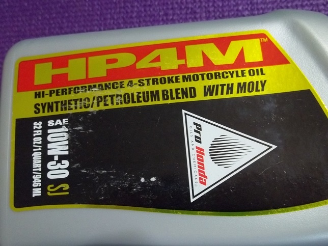

I'm going to change mine at 1000 miles using the Pro Honda HP4M 10w-30 with Moly. It will be the first time.
I already changed the engine oil at about 600 miles.
I figure at the rate I'm going that will be around September. After that I'll change it every other year as prescribed in the SM. 8)
