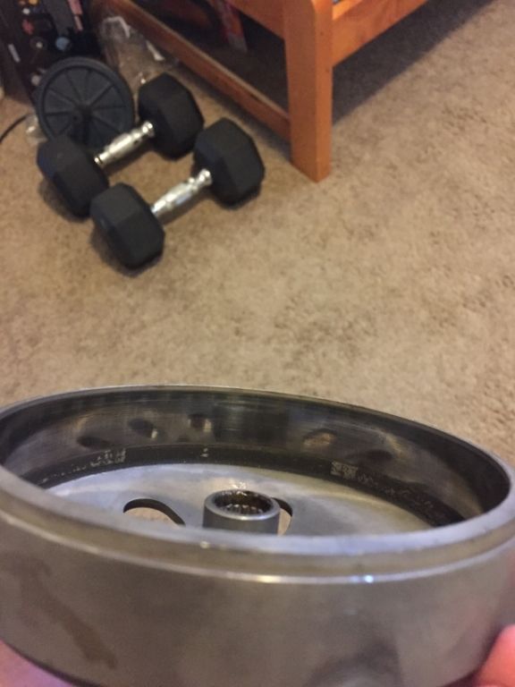

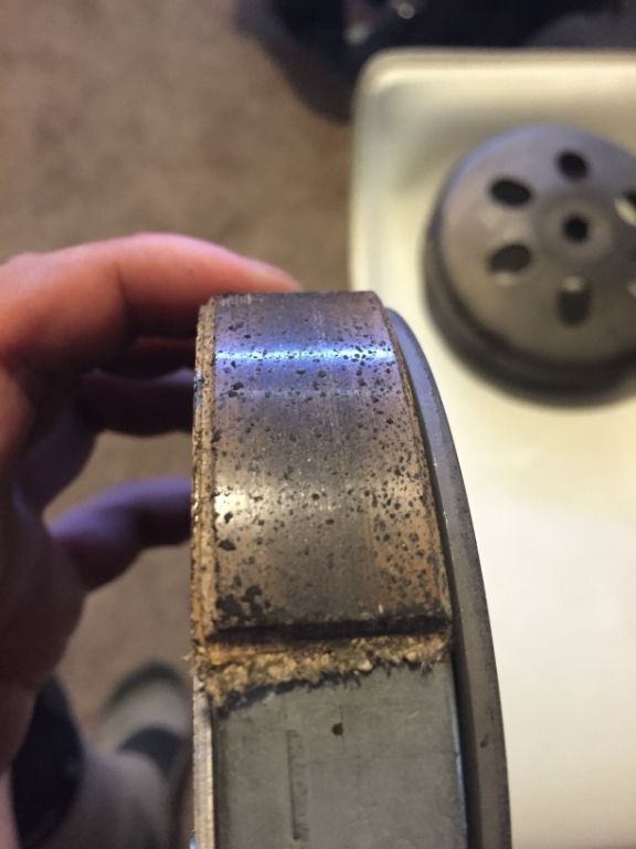

Okay, so I swapped out the stock clutch with a Malossi Delta Clutch. There's an improvement, but it's very minor. The mechanic suggested either using lighter weights or a stiffer center spring. I'm a bit amazed how he can say that given that it's currently pulling at 8500-8800 rpms due to the 10g weights, but whatever, more money out the door <_<
