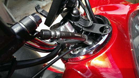

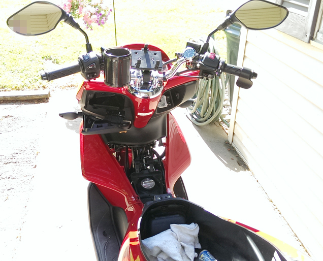

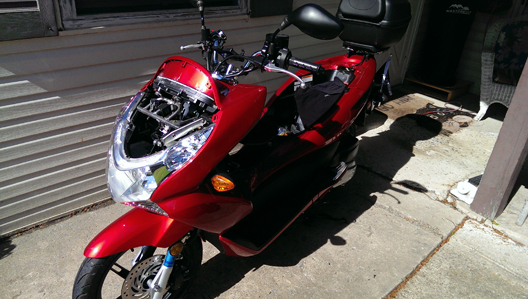

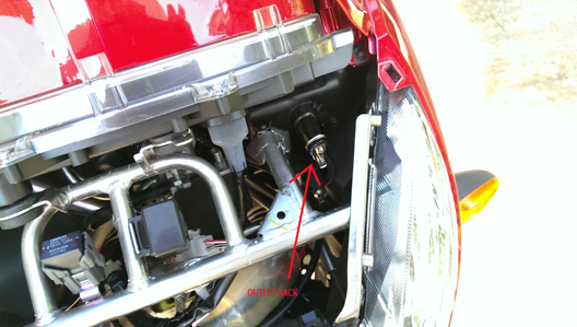

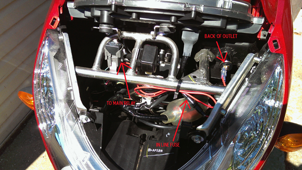

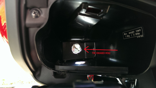

I can report SUCCESS!! I finally got around to installing my new Ermax +25 today, plus a 12v outlet in the "glovebox". I wanted to get it done sooner but this dratted yard keeps wanting to be mowed. Anyway --- I'm still impressed that same-same got my Ermax to me in 8 days. Kudos to them. While the patient was open was a good time for the 12v outlet. Attached are some photos of the outlet install plus the Ermax in place. The black trim is hanging down in one of the pix -- I'm letting the glue set up for a day before I trim it.
Also included pix of my Navigon GPS ( which I was going to sell but not now ) on the RAM EZ Strap mount. The RAM base also fits my HTC phone so the outlet can do double duty. I wired it to the main relay -- it only works with the ignition on so I don't drain the battery. I was going to take a ride to test the wind with the Ermax, but it's raining ---- again. Maybe mañana.
