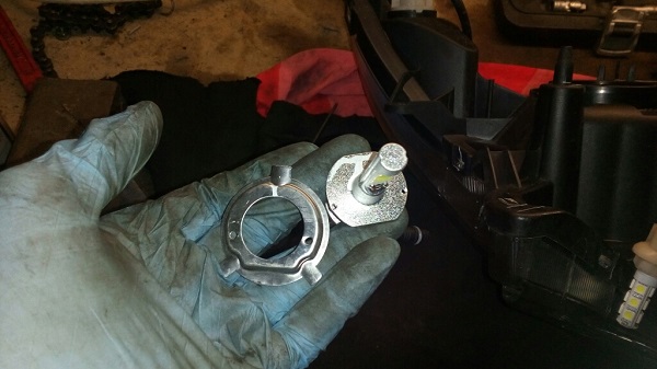

hello now here are the photos ..
H4 6000LM 35W 6000K Led

How did you adapt the connector?I believe that the non-life version of the PCX has HS5 bulbs. I am interested in converting mine. I already swapped the original bulbs for better quality ones with better light output, but led headlights would be much better.

hi. I bought the lamps in h4, in this type of lamp, the plate that makes (h4, h7) is screwed, just remove it, you can see in photo number 2, ie mounted without the plate,.

how did you prevent the h4 bulb from falling out.
