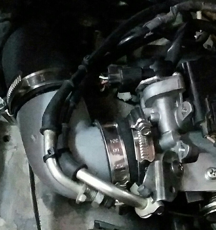

Today I finally got stuck in and modified my airbox for the Yuminashi 31mm big tube air intake.
Before I got started I thought I'd clear the error codes and reset the ECU, but the scoot was dead. :?
So I hooked up the Lithium charger and left it to top up while I worked on the scoot. :geek:
Anyhow, after lots of stuffing around I finally got the airbox modded and the intake tube trimmed to suit. :D
I whacked it all together and thought after a few hours the battery should be ready to go, nope... :|
After checking a few things, I grabbed a tester light and found that the battery wouldn't even register.
Hmm, 3 month old battery and it's stuffed already. Now I get to find out how good the warranty is... :roll:
Anyhow, since I can't test my handy work from today, you can all rejoice at this attached photo and behold. :lol:
Oh yeah, the outer side snorkel has been removed too, since it's so much smaller than the new air intake tube.
Last time I removed the snorkel it sounded like a diesel tractor, I can't wait to hear what it sounds like now. o_O

Wooo, AWAB stainless hose clamp, only the best, break out the seldom used 7mm nut driver.
So this job is at what stage now, stock bore but bigger throttle body, injector, and air tube? I'm sure you'll be testing and tuning this setup, but with the BBK installed won't any current observations be somewhat obsoleted.

Great pic! Really gives a noob something to add to the already outstanding resources on this Forum to refer to when doing surgery. Thanks!

k2apache6.0 wrote:Wooo, AWAB stainless hose clamp, only the best, break out the seldom used 7mm nut driver.
Yeah, that's the clamp Yuminashi provide, it's a lot better than the POS clamp that came with my red pod filter.
It doesn't creep too much as you tighten it up, either. I just used a Philips screwdriver since that gets the job done.

chicaboo wrote:Update:
When will you get off your lazy butt and install the bbk like finally?
I use water plumbing tube for the air intake.
