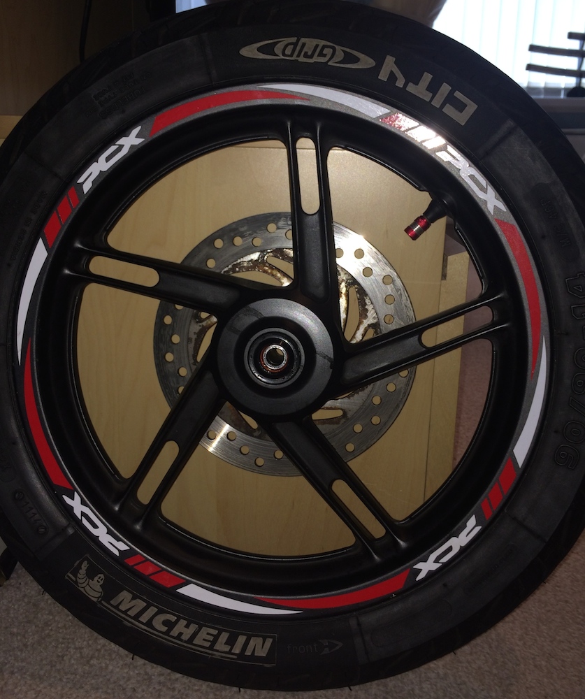

So annoyed!!!! i'll have to check the back one as well as they did that one too....
and that I waited weeks for the Rim Stickers from Italy and now they're going to be ruined,
as I noticed when they put the Tyres on, they mark the Wheel a bit!

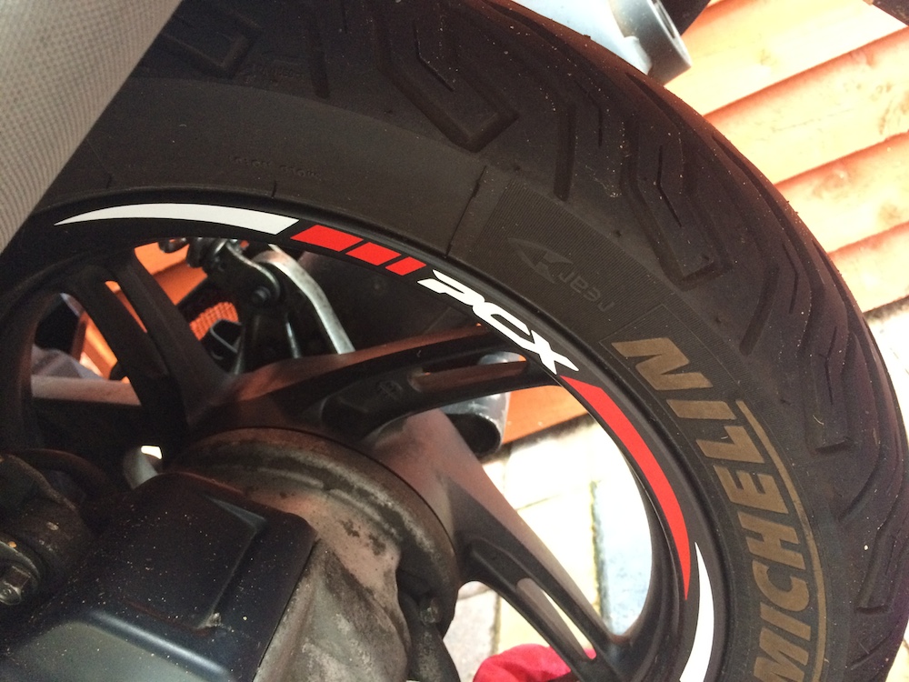

I checked the back one and that arrow points in the way the Wheel goes..

lol so what am I doing, i've taken the Wheel off...
is the Tyre correct or not?
as a few people on here have been saying it's wrong :-/
so as you're saying,
the rear one is correct as when the text is straight, the arrow is pointing to the rear of the Bike?

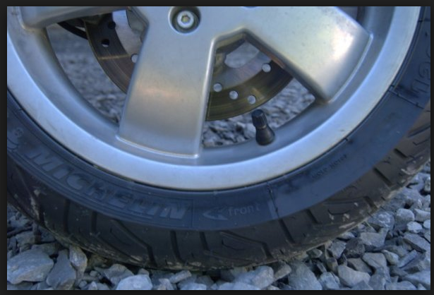

Picture worth a thousand words... you have made many discoveries by posting this thread. Sorry about your rim stickers bro. Apparently your Michelin citygrip tread should appear like this when installed correctly. As you can see that clearly shows your front to be reversed.

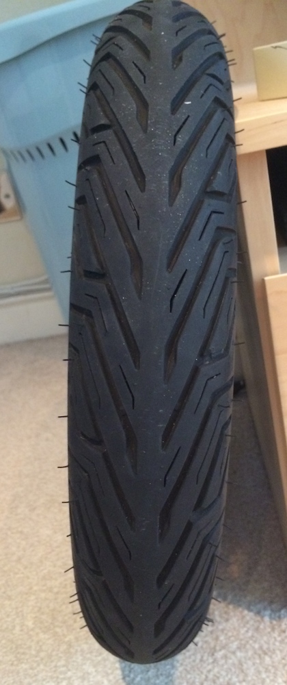

This is mine...
*front* text at the bottom of this photo, arrow pointing to the left
Just went onto the Michelin website and seen this... so it is on the wrong way then... as the arrow needs to point 'the direction of rotation'
