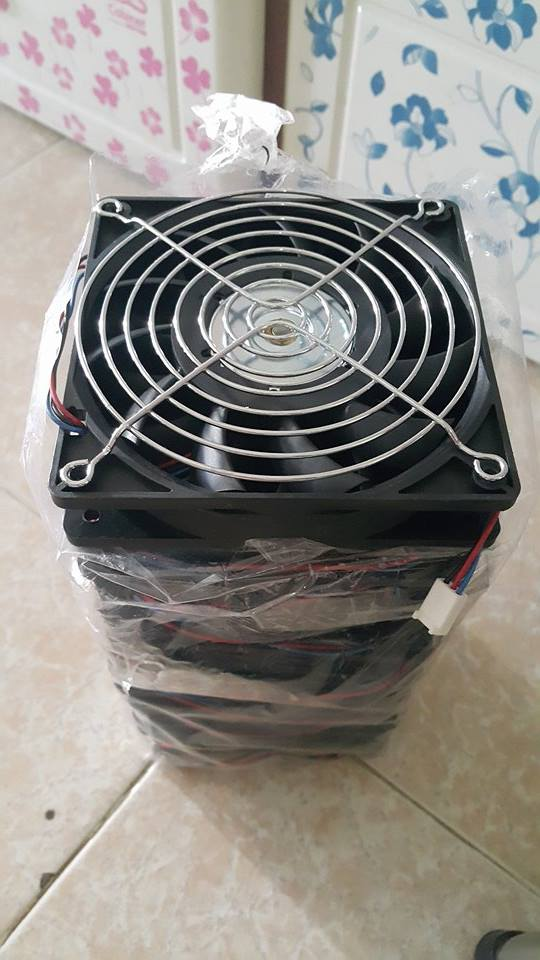

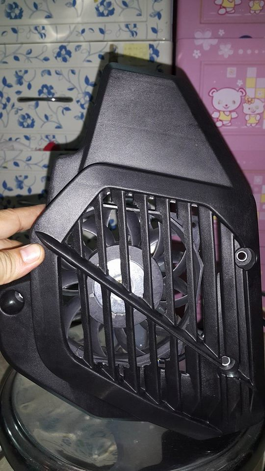

Update for Oyabun.
We do have guys here who run a PC server fan on his PCX to questionable results. They claimed to free up a lot of mechanical work and their fuel consumption has improved about 5km per litre but that must be tested. I don't trust anybody making any claims until I have experienced it myself. I'll see if they have any more of that fan left to try. Will report.

I really like this idea!! I have been thinking this for a long time and also electric coolant pump. I reckon the gains would be awesome!

Although I'd be fitting that fan on the inside to draw air thru the radiator..only thing then is you couldn't see it working or when it fails...
I'd wire that up to the ignition contact and install a 5-20 second delay switch to reduce battery load on starting up.

The guys running it has agreed to make one for me about 10$. I'll post the results here once I got it running.

Well I've asked them about the fan. They said it only helps with the cooling by pushing air into the radiator along with the fan inside the radiator that sucks air in. I've mentioned about dust or projectiles during normal commute or in the rain, they said to mod a switch off button to turn the fan off if there's chance of damaging the electric fan but then the fan would just sit in the way of the air being sucked in.
