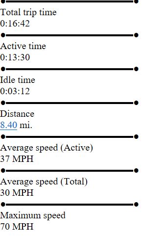

Re: 2015 Honda PCX150 Black Metallic (Performance informatio

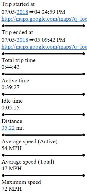

Just made a test run. Nice numbers so far. Need to change the gears to see what she has next.

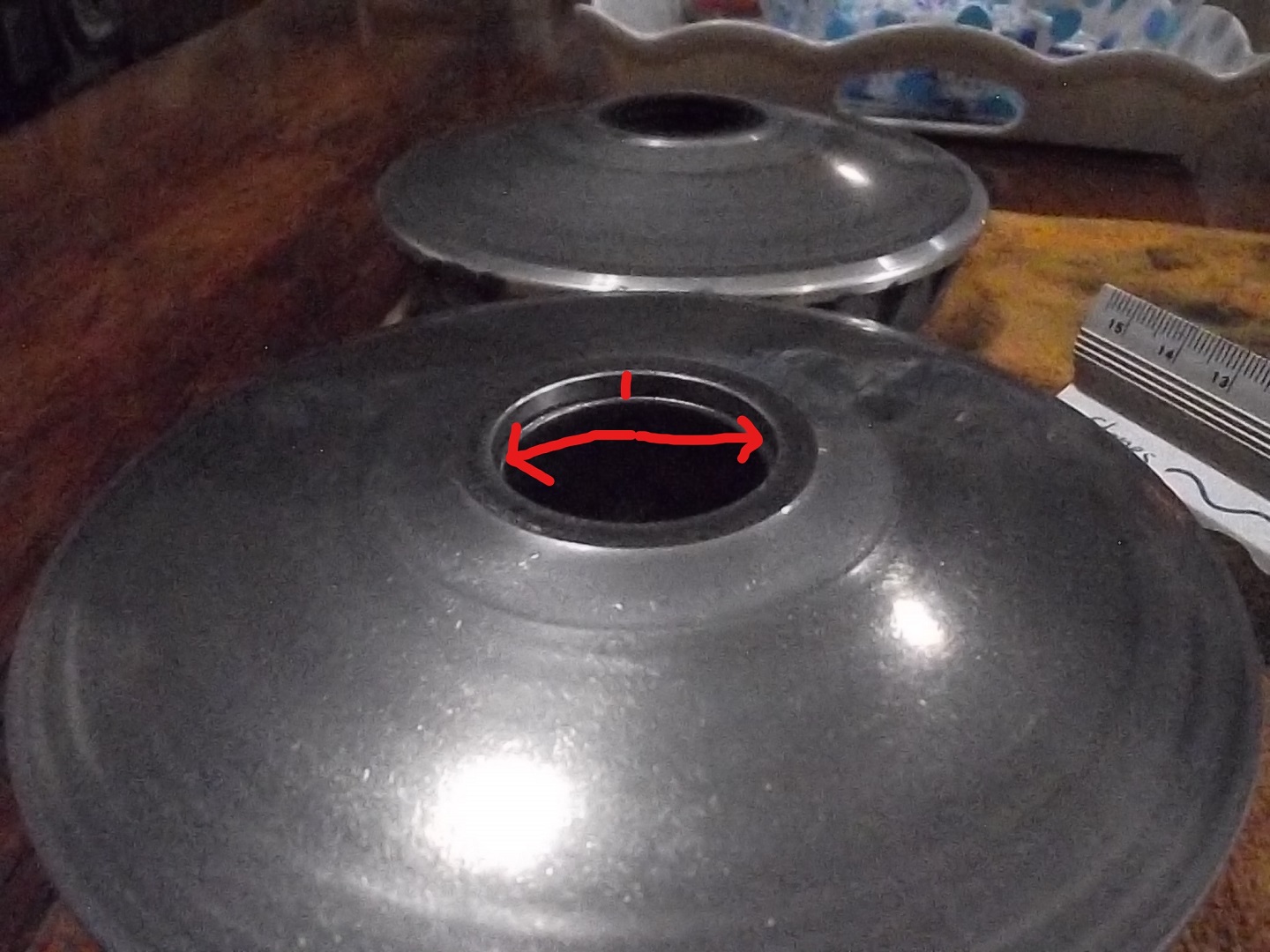

Test and measure time. I have been thinking hard about some of the measurements of the CVT variator and face. Found some new info today that may give a new view as to why the NCY kit works so much better than the stock setup. I am going to install the 18g rollers in the NCY kit and test a few things. I will post my findings in a few. Salute 07

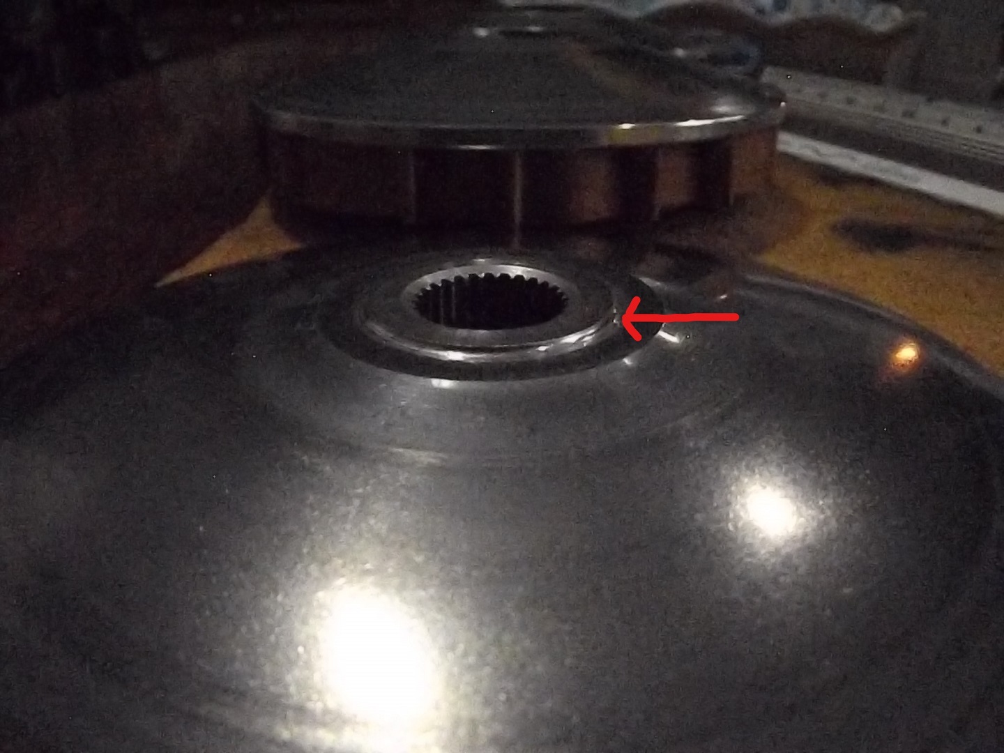

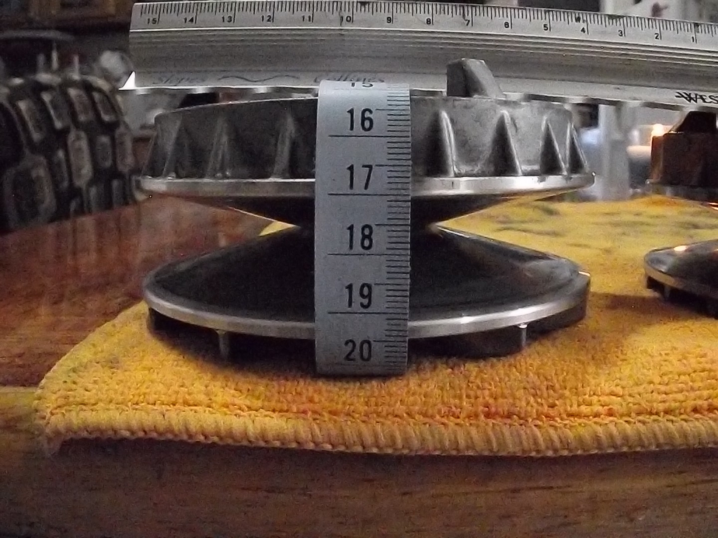

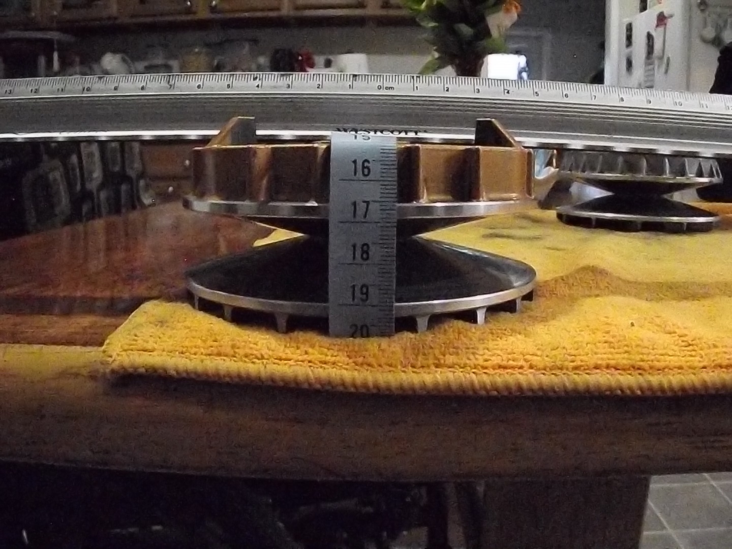

Note the NCY variator kit has a recess and boss that pulls the variator closer together and helps the belt ride further out on the pulley assembly. It seems as close a 2mm-4mm not sure. Also the pulley assembly seems to be about the same diameter for both. I put the stock 18g rollers in her and she became a smooth machine with no vibrations. Still hit 71mph GPS with a worn down rear tire.

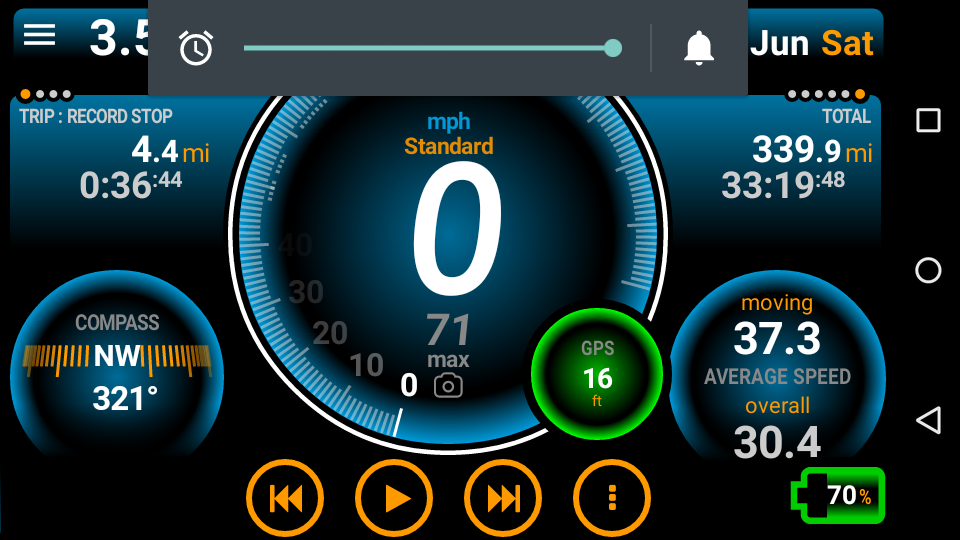

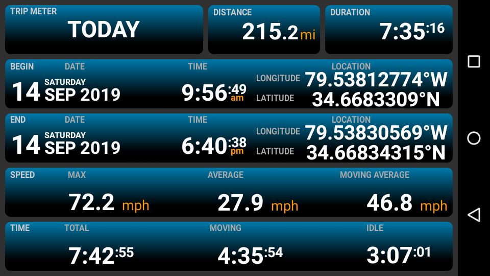

Saturday run with top speed. Ran out of road and did not hit the rev limiter.
