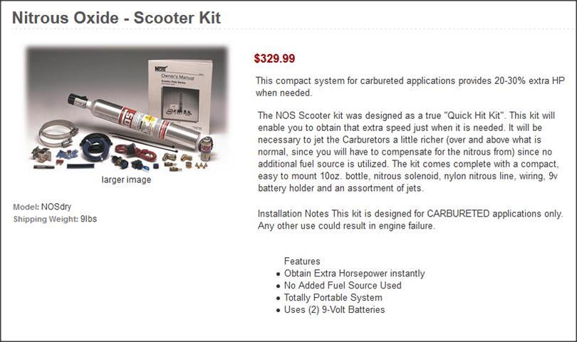

by Limey
Interesting that your link shows it at about $59 whereas on E-bay the same one is over $480. Must be trying to offload it because they know it is ineffective?
Should probably try this too??? :lol:
Snap 2020-06-06 at 09.19.06 (Small).jpg (54.43 KiB) Viewed 21758 times
