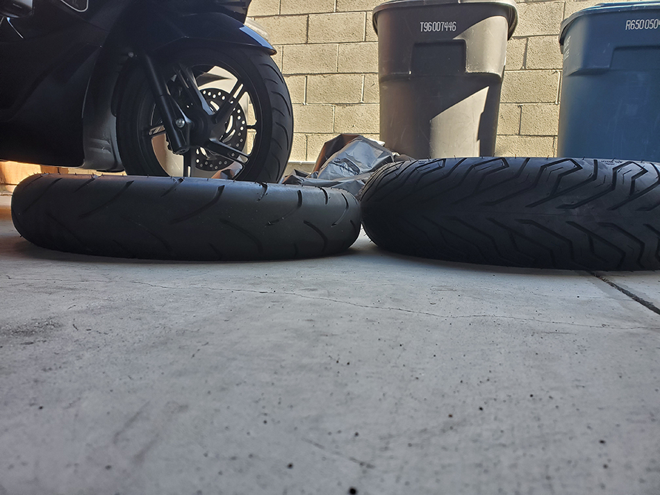

This is what I run. I want to say this is the biggest you can go without clearance issues.
Front: 120/70R14
Rear: 140/70R14
Rear comparison
