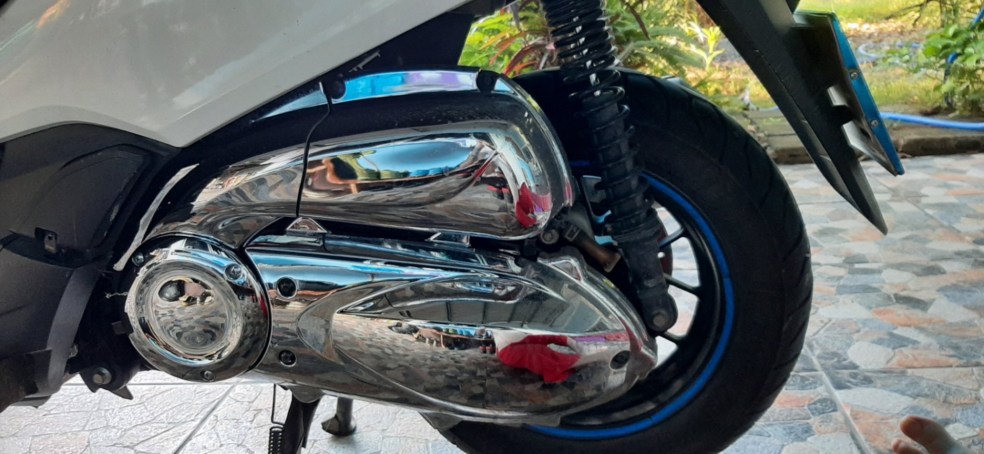

by canthai

Can you buy those parts?
Re: Belt Case Corrosion !
Posted: Sat Sep 18, 2021 9:34 pm
by canthai
