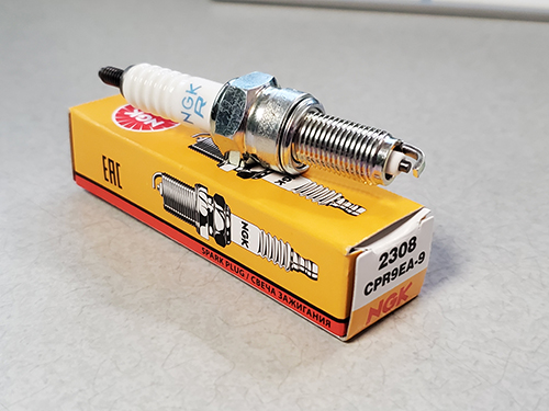

I guess I'm not so much looking at "Performance gains" more so optimal performance when you run intake and exhaust.
This time around I went with a Cooler plug than stock in hopes of not burning up the electrode. I'll be changing it out tomorrow to show what happens to a stock plug.
Personally I wish I could find a compatible E3 plug but no luck.

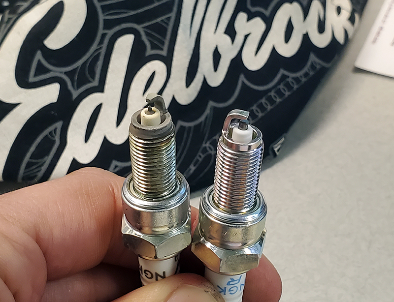

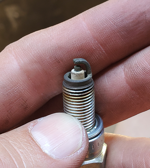

I totally forgot I swapped to the iridium. Same one raito runs. You can see how lean its running from the white coat on it..
Just found the original plug before I changed to iridium.
Here is the iridium with maybe 1k miles. You can see how lean its running from the white coating on it. New Colder NGK going in.

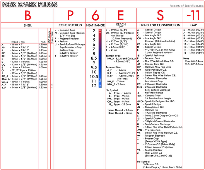

Cool little observation.
Stock: 6
Iridium: 7
Latest one i installed: 9
Screen Shot 2021-01-15 at 11.19.21 AM.png (293.56 KiB) Viewed 15878 times
Re: Performance Spark Plug
Posted: Fri Jan 15, 2021 4:07 pm
by springer1
I donno about the idea that a cooler plug with cure a lean running situation. Whenever I changed the exhaust on my 150 Vespa (Stella), I first installed a CHT and baselined head temps at various running situations, then rejetted after the exhaust change to mimic the original temps. Same thing when I added 2T oil in the premix to supplement the autolube .... the cylinder head temperature gauge soared when a little oil was added the gas, thus displacing fuel and leaning the mix.
I'd still have that Stella & never bought a PCX if some of them didn't have a risk of high speed seizes due to crankshaft bearing shim issues from the factory. Problem was it wasn't possible to determine which ones would & which one wouldn't.
But the point is that why make "performance" intake or exhaust changes without a plan for ensuring correct fuel/air mix from the onset. The amount of richening needed for that Stella due to the pipe was significant for both for the high speed & midrange jets. But at least on the 2 stroke there was a noticeable increase in HP, where on the 4 stroke PCX there isn't.
Posted: Fri Jan 15, 2021 4:47 pm
by Conelite
That's great info Springer1. Thanks. You are right, a cooler plug wouldnt fix my lean issue. Only more fuel would do that..
