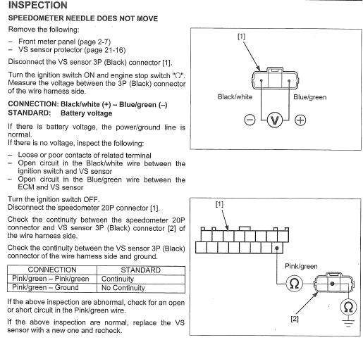

I checked the service manual and next thing is to check the VS sensor as its the least amount of work to get to. If that is good I will have to check for continuity between the speedometer 20P connector and the VS sensor 3P connector. But this is where it gets confusing as the manual states a 20P connector while my after 13' model should have a 16P connector going to the so called 'combination meter' which includes the speedometer - at this point I guess a typo in my manual (hopefully).
Anyhow to get access to the 16P (or 20P - will see if I get there) connector I should:

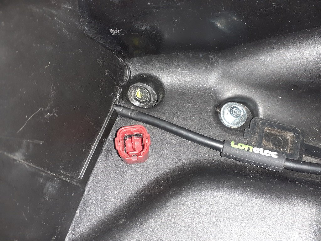

This is how my lid cover is now in place. Notice the cable coming out which states lonelec - some years ago I attached this cable in an attempt to be able to connect an ODB thingy to it to connect to my smartphone. After a disastrous failure (read the details here ) I just left it at that and removed the bluetooth obd adapter but left the cable in place and closed the battery lid cover. Obviously as you can see in the picture it was a tight squeeze and the cable got pinched a bit. No problem - until now.
It was when I inspected the battery connections as Conelite suggested and after opening it back up (after reading the service manual and decided to go all electrical) I noticed the cable was quite flattened where the lid was squeezing it. I tried to remove the cable before my previous post but it seems quite difficult to disconnect, so I cut out a small piece of the lid cover so it does not squeeze the cable anymore. And ... well the problem seems to be gone for now - so my assumption is the cable is causing a milli-amp bonfire among the 4 connections inside this cable and messing up my PCX her brain.
So the next thing is to remove the cable entirely again, and put the red cover as seen in the picture back on the other end and be completely done with it.
If this was the issue, then the problem was with its owner and there is nothing I can blame my little PCX :D .

If the cable is not connected to an OBD reader, why do you even have the cable connected to the bike? Im so confused. lol
Re: Strange behavior speedometer
Posted: Wed Aug 25, 2021 12:33 pm
by Ganglylamb
Because I'm lazy and removing the cable proved quite a bit of hassle as I had to remove the battery to get easy access to the connector :). Some say laziness brought the Roman empire down - if all holds up it also brought my PCX down :-D.

Just an update; got to the 16P connector (took some shortcuts as I did not remove the front side cover panels) and performed all things stated in the SM (had some help from my wife as I could not connect my multimeter terminals at both the front and end of the bike at the same time) and I have ended up at the end:
I also checked all the other electrical bits there are to check according to the SM at the 16P connector and all turned out fine.

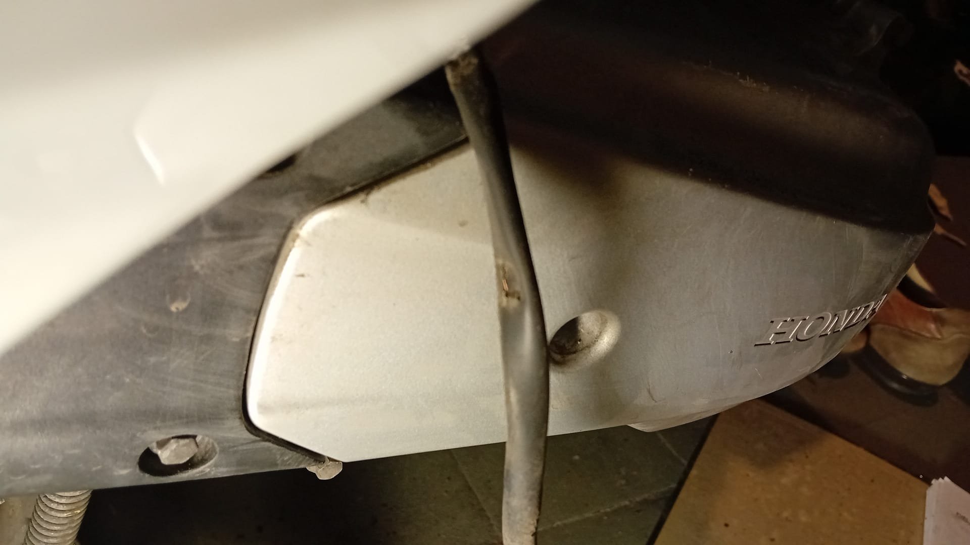

As I just got a new 2023 PCX and now have a backup I decided to tackle this problem so I stripped the bike of all the panels and finally found the culprit:
sensor cable.jpg (115.51 KiB) Viewed 8548 times
This is where the three cables going to the sensor are located in - if you look closely you can see a bit of copper sticking out. This part of the cable runs behind the air filter box. When cutting the sleeve I saw 2 of the 3 cables being broken at that spot.
sensor cable2.jpg (95.06 KiB) Viewed 8548 times
I stripped all 3 of them (the one which was still working only had half of the insulation left), soldered them back together and now the speedometer is working fine again.
I also noticed closer to the engine that the sleeve in which these 3 cables run was halfway gone (probably due to friction etc.) so I wrapped the whole thing in some duct tape to prevent further chafing.
So for those who have a broken speedometer - first perform continuity test as described in SM. If those fail look behind the air box first , the rest of the cable goes into the main wire loom and seems to be holding up fine with no chafing present.
