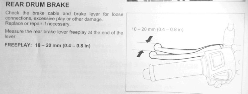

Per the service manual:
When adjusted properly there will be no brake drag and the parking brake will work great. For mine it is right at 10mm.
