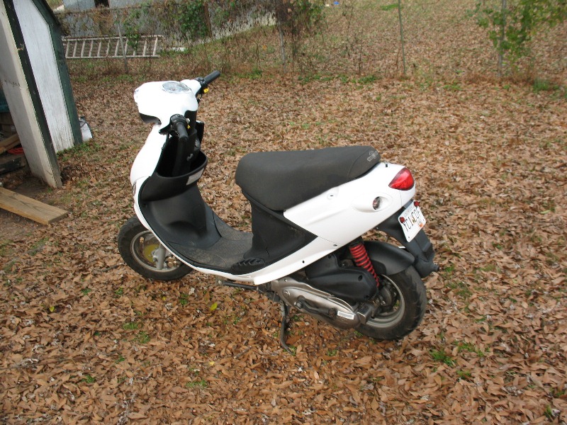

I picked up my 3rd Buddy 125 from a kid in Tallahassee. I owned 2 others a couple of summers ago, but had sold them (got an offer for more than I bought them for, made a good profit). They're awesome little aircooled scooters. They're not as well-finished as the PCX, but I wouldn't hesitate to ride a Buddy anywhere I would ride my PCX.
I bought it in the middle of October from a kid at FSU. He had dropped out from partying too hard and needed the cash, so I gladly bought the scooter from him for $700 as I was passing through the area anyways to go on vacation. He and his fraternity brothers had abused the shit out of the scooter, and neglected any maintenance for the last two years. I picked up my 3rd Buddy from a kid in Tallahassee. It had been abused by fraternity brothers, and neglected from any maintenance for the last two years.
The next day after I bought it, I did a quick gear oil change and engine oil change -- both were really nasty. I rode the scooter while I was on vacation for a few days, finding out everything I needed to replace or repair. In addition to changing all the fluids, the scooter also needed a valve adjustment, three new fairings, new controls for both the right and left side, a horn, new paint everywhere to fix all the scratches and sun fading, and new tires. I also had to get a rear rack and crash bars, the scooter looks so much cooler with them.

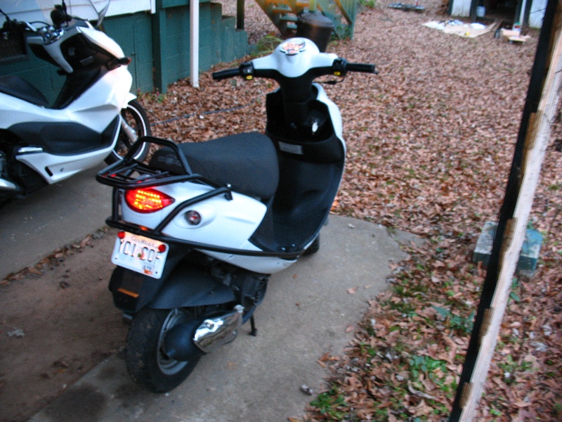

Next to the PCX for comparison:

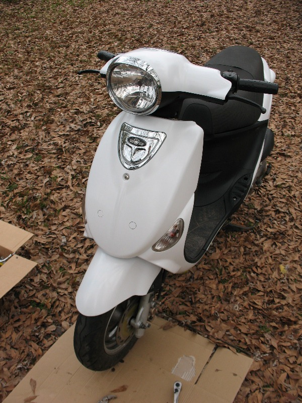

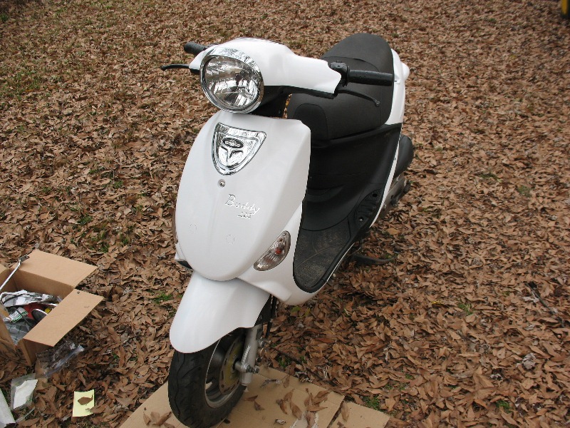

I pulled the scooter back out:

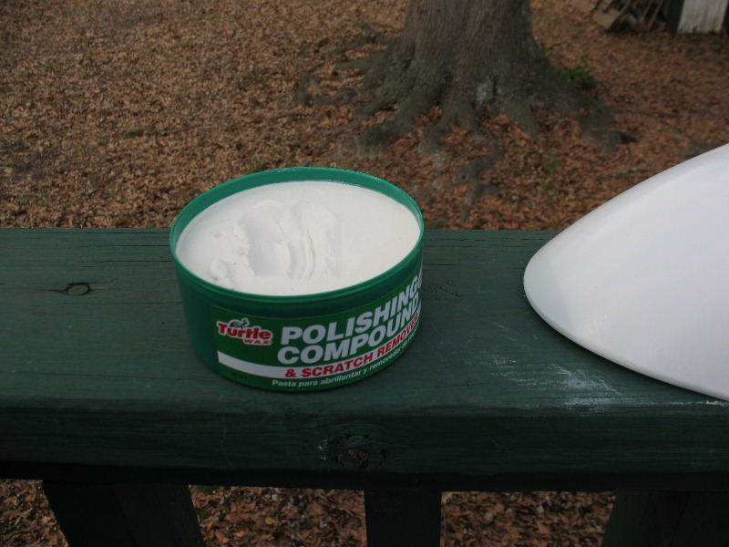

And pulled out some polish to get the finish more shiny. I use Turtle Wax, it works well.
I buffed out the front fender and reinstalled it.

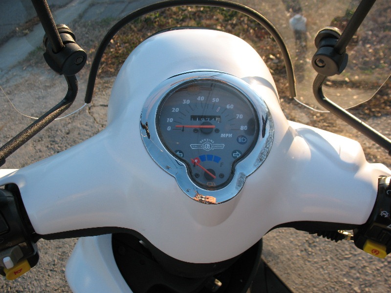

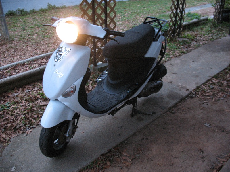

Then, I polished the hell out of the front of the scooter. Unfortunately, it was an overcast day, so it's hard to tell that the paint is now shiny. It's not super-shiny, but it is passable as factory paint.

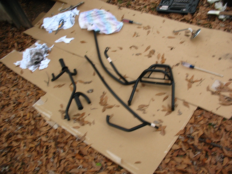

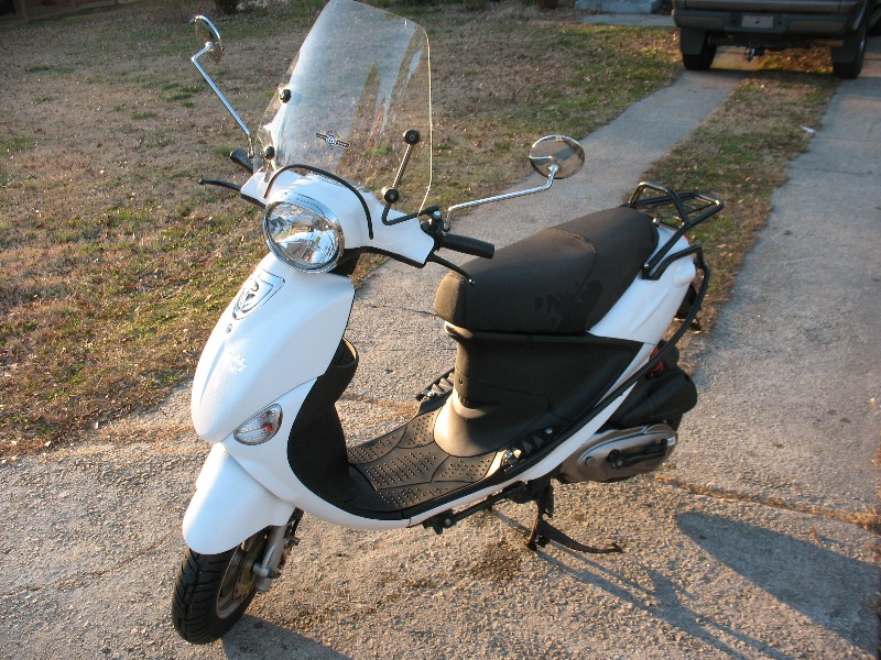

I polished the rest of the scooter up, making the rest of the paint shiny. I installed the rear rack and cowling protectors next.
Installed... Looking good...

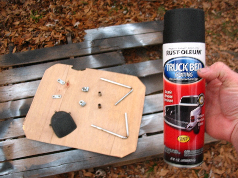

I would have installed the windshield too, but the hardware was all rusty and crappy looking. I pulled out my bedliner paint again, and sprayed the hardware for the windshield and the air blower cover.

That is starting to look like a factory finished brand new Buddy :D
It'll be nice to see it all finished and looking shiny and fresh.

Re: Buddy 125 restoration
Looking good, but why all the external metal tubing?
It's supposed to protect the fairings in case of a spill. I bought them because I like how they look though.

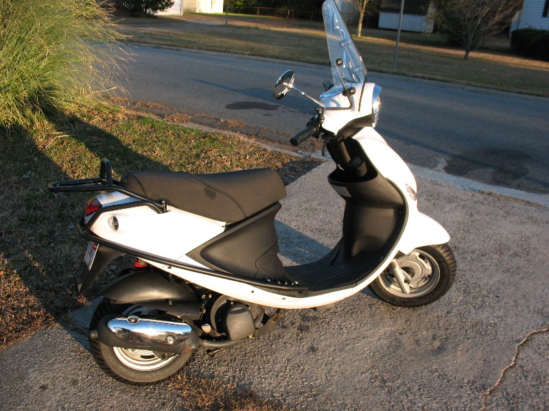

I sprayed the 2nd coat of bedliner on the windshield hardware today, I'll install tomorrow.

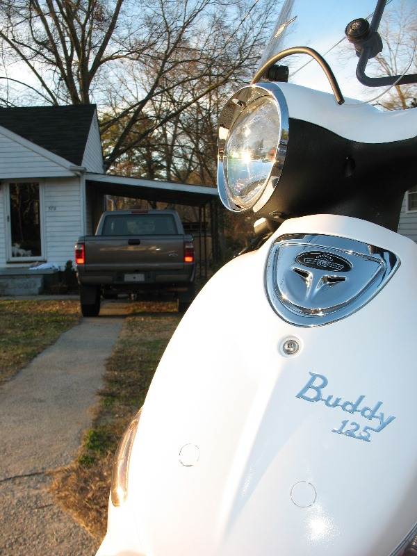

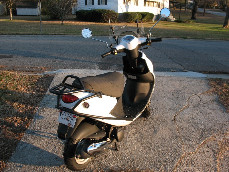

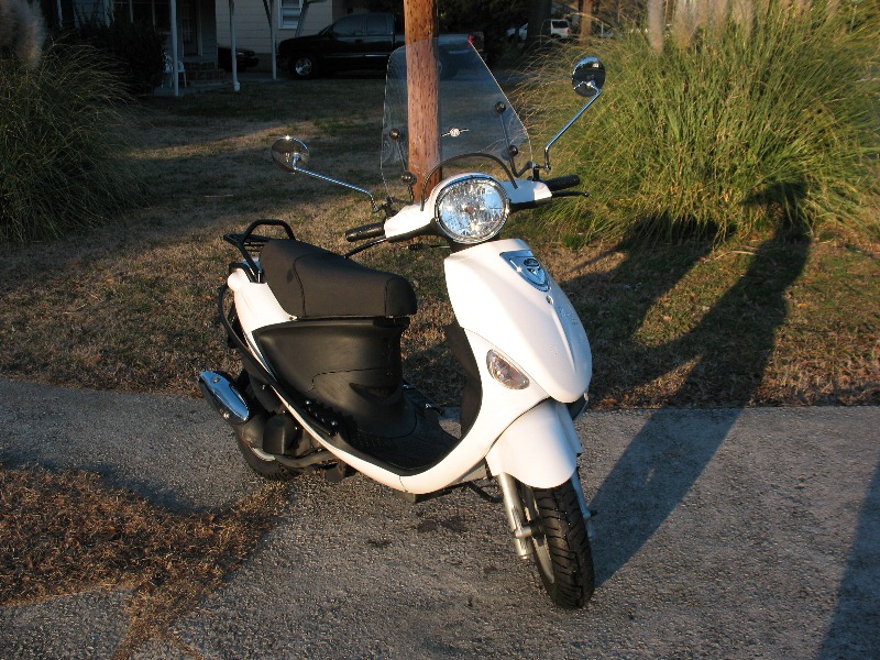

My staplegun was too shitty to finish the seat, so that's on hold for now. Here's the final product, without the new seat:
Post by rich666 »
Dave, that is immaculate - Like I said before it looks like a factory fresh out the door Buddy.
I would be lying if I said I wasn't jealous :) .
it tastes like...Eagle!
It's not quite perfect! Thanks though! :D
I want to add some depth to the paint to make it more glossy, so I might be adding some laquer paint over the clearcoat. I'll update when / if I get around to it.
