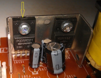

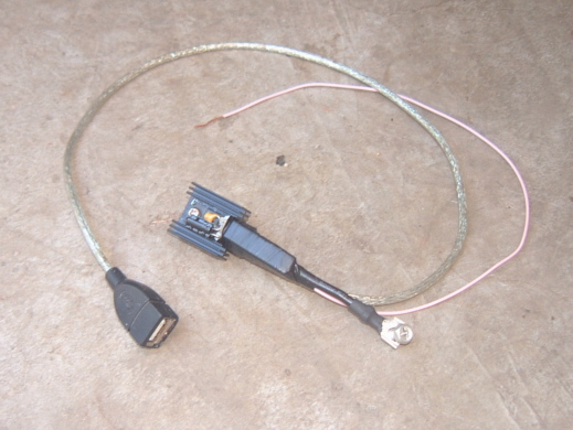

I made and installed USB charging point on my PCX150 this morning.
Ingredients:
  • USB extension cable from old computer.
    5V regulator from old printer (see photo below).
    Small heatsink from old UPS
    2 capacitors and some wire.
Finished product:

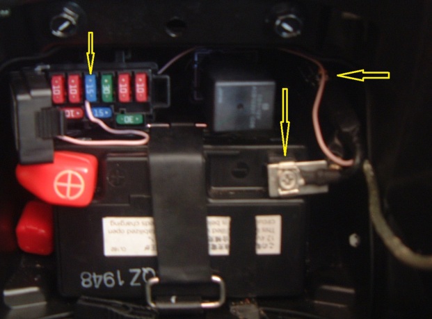

Connected +input to the headlight fuse so that it is only on when key is in (arrow on left).
Connected -input/output to negative terminal on battery (middle arrow).

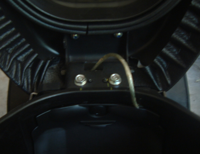

Pushed circuit into the space shown by the arrow on the right.

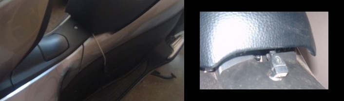

Closed battery compartment and fed socket through the perfectly sized hole that Honda considerately put there for me:
Closed seat:
Of course, if I was less lazy, I could have installed the socket in the glove compartment or on the handlebars but this works for me. ;)
