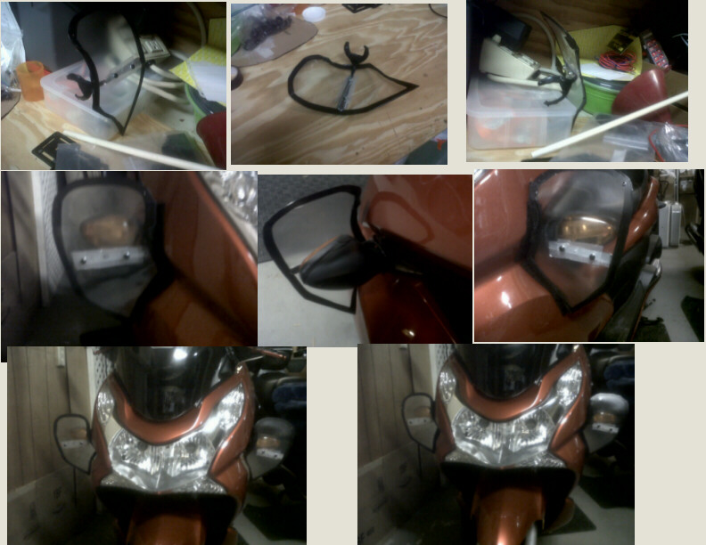

Posted: Wed Feb 05, 2014 10:27 pm
Well, I have started on version 2. I installed the left side this evening and took a picture or two. I need to make the right side next. Then, when spring arrives I will test it out, but I think it will work. I shouldn't have seen that picture. It gave me ideas. B-)

Posted: Thu Feb 06, 2014 6:10 pm
OK, Version 2 is complete. Here are the pictures of my invention. Keep in mind that they are held on with industrial strength Velcro. I haven't tested them, but I am betting that they will hold. When you want something done right, just invent it! :-)

Version 2 looks great :) I would make them a bit longer, but I like this solution much more than version 1.

Posted: Fri Feb 07, 2014 10:32 am
Home made is great. I can make things the way I want, without worrying about whether I have messed up installing it. Also, the total cost was less than $20. ;-). Of course, time is not part of that cost.

Mel46 wrote:OK, Version 2 is complete. Here are the pictures of my invention. Keep in mind that they are held on with industrial strength Velcro. I haven't tested them, but I am betting that they will hold. When you want something done right, just invent it! :-)
Mel, is that Plexiglas?
Re: Leg wind deflectors - where/how to order?
Posted: Sat Mar 08, 2014 9:56 pm
Of course it is plexiglas. I went to Home Depot and selected the size and thickness I wanted. I made a template using an old file folder. Then I cut the plexiglas using my Dremel. Great tool. I love mine. There is actually a bit for cutting plastic. Then I used my heat gun to bend the front pieces to where I wanted them. After that, I took the piece of plexiglas that I had cut out for the hole for the turn signals, bent it to the angle I needed for the front areas, and used industrial velcro to attach everything. It only took me a few days from concept to finished product. Each side is a reverse of the other, so I had to custom bend each piece to make sure they fit correctly.
