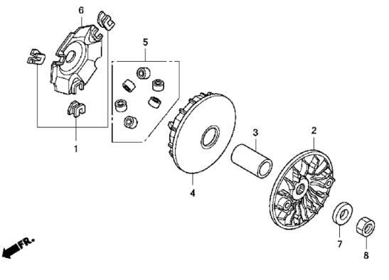

Instead of replacing the final drive gear, you could also modify the pulley spacer between the two driven faces of one of the variator pulleys. This would allow the belt to ride more narrowly on the variator, having the same effect as a final drive gear. I still have to experiment with it on my bike, but if I get results, I'll be sure to post a how-to.

Back on topic, here's the part I was talking about cutting down for an increased speed:
driven face.png (45.3 KiB) Viewed 3749 times
The part number 3, which is known as the boss, controls the distance between 2 and 4, the two drive faces. By making it a bit shorter, the belt will be able to ride up higher on 2 and 4, giving more top speed. The part is only $4 on http://www.mrcycles.com, so I might tear the scooter apart this weekend and tinker with it if I get bored. :)

Oh that's pretty sweet! And a potentially cheap mod or replacement if screwed up lol. Just gotta make sure not to cut it too short... And lose the belt :-)
