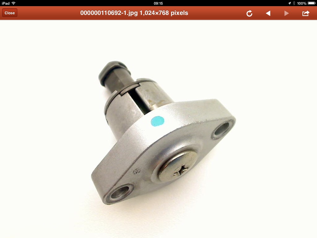

Re: Honda PCX 150 Idle Ticking Sound
so witch part is the correct part that needs to be replaced?
https://www.google.com/search?q=pcx+150 ... xk74jhM%3A
Hi iconsx.
I did not do the replacement. The Honda dealer said that part was $70 AUD for a cam chain tensioner.
Maybe it comes in a kit with multiple parts. Does anyone know more about this?
- Alibally
- Posts: 1761
- Year: 2019
This part is the tensioner
- ImageUploadedByTapatalkHD1436516161.031125.jpg (59.78 KiB) Viewed 7241 times
