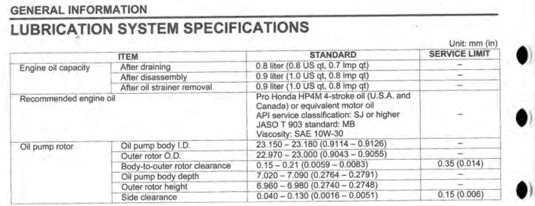

Sorry, synthetic blend "or equivalent."
Screen Shot 2015-05-05 at 11.57.14 AM.png (174.57 KiB) Viewed 6894 times
HP4M is a synthetic blend.
Conventional oil is inferior to synthetic -- this is a fact, not conjecture. If the specification calls for a synthetic blend, use a fully synthetic or a blend.
You'll probably be ok with dino oil, but I wouldn't risk it, especially given how ridiculously cheap a quart of oil per 3k miles is.

Maddiedog - is that from the service manual? I had a look in the owners manual before my last post and I was sure it just said 4 stroke engine oil with a few requirements such as non energy saving. I wonder if different manuals / regions state different things.
Re: todays oil change..
Posted: Tue May 05, 2015 2:50 pm
by maddiedog
That's from the service manual, not the owners manual, which is probably why every time I say Honda recommends synthetic, a bunch of people question me. :)
There's no reason not to run synthetic regardless, even during break-in. The conjecture that conventional oil is better during break-in is just that, conjecture. The PCX ships with HP4M, and I recommend everyone run a full synthetic uncompromisingly. There really is no reason not to, unless you're upset over the extra $4 a quart of synthetic will cost over conventional. :lol:

Just checked my service manual, which in the UK comes as the older 125-150 PCX + 2015 addendum, and it reads almost like yours but instead of ProHonda states 'Honda 4 stroke motorcycle oil or equivalent' which ties-in with the bit in yours that adds 'USA or Canada' next to the ProHonda. Exactly as stated in the europe owners manuals (hence 150cc covered to as UK is 125 only). Wonder why they don't mention ProHonda for europe?
Still, as many have said, stick to good quality 'runny stuff' from good manufacturers, make sure it's not energy saving and within the temp range for your locale. Can't really go wrong can you.
