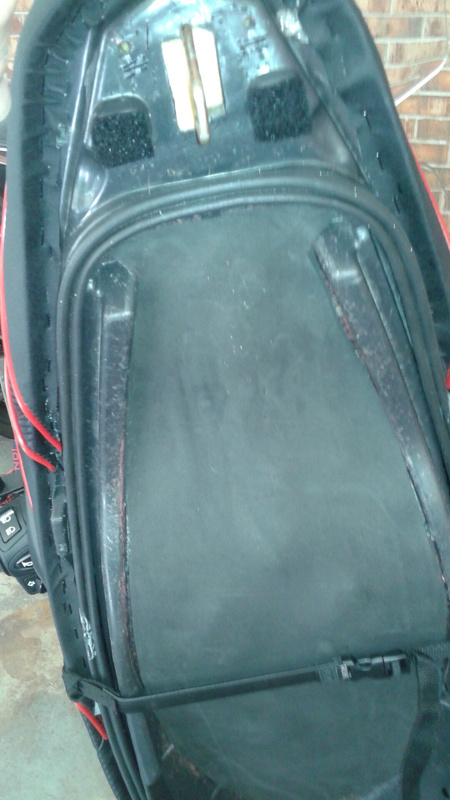

First pic is the original seat. 2nd one is the custom one. There is no gap for the rubber seal to slot into

This is normal for replacement seats from Asia. Just pull the one from your original seat and it will have enough sticky left to stick it to the new one. I have done this to 3 replacement t seats so far and all have been fine. You could order a new seal if you want to but the one on your original seat works quite well.

Here is a picture of my newest custom seat. It did not come with a seal. The other picture is the underside after I installed the seal from my original seat.
