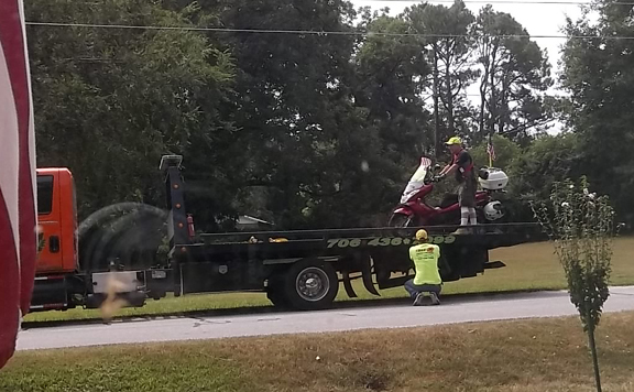

PCX zipping along – engine died – turned over but no start.
Wednesday I left home – stopped and topped up gas – rode up to clinic about 40 miles.
Scooter ran great.
Came out of clinic – started right up.
Scoot was running very nicely on trip home with no problems
when at about 30+ miles it cut off at about 55 mph or so.
I coasted along till I found a safe spot to pull off the road.
Tried for restart.
Maybe twice engine sputtered for a moment – then died.
Tried again but battery now too weak.
This was about noon and temp was in upper 90s with heat index of maybe 105.
No shade tree handy so –

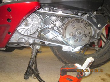

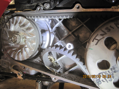

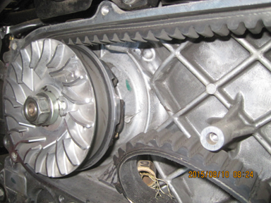

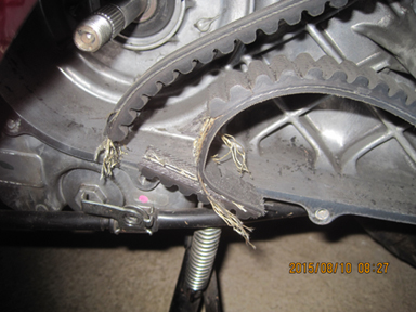

Hay Inoplanetyanin
Some good thoughts - and one sentence made me think that I had overlooked a simple check.
You said.
If still nothing, turn the crank manually (will have to take off the cvt cover for that) and see if the engine has unusual resistance in it.
I thought - self - why have you not cranked over the engine manually??
THANK YOU FOR THE THOUGHT.
If I had done this back at the beginning I would have saved myself a lot of work - so I will pass some thoughts to everyone on troubleshooting the scooter.
see the next couple of posts as I work through this.
Thanks
Sean

This is really foolish on my part since it doesn’t take 5 minutes to split the case.
I pull cover and what do I see ???
PCX CVT 1 cover pulled 324k.jpg (134.97 KiB) Viewed 9802 times
Well there’s your problem! :o
PCX CVT 2 belt broken 324k .jpg (123.43 KiB) Viewed 9802 times
The belt is broken, jammed and some of the sliders came out of variator.
PCX CVT 3 belt broken jambed veriator 324k.jpg (124.74 KiB) Viewed 9802 times
Not sure how well you can see it but if you look at upper left of this photo
you can see that belt is slightly twisted and wedged between veriator and cvt case.
NO WONDER MOTOR WOULD NOT TURN.
Also look at lower center behind twist in belt, you will see a slider laying there.
and finally the belt itself.
PCX CVT 4 belt broken 324k.jpg (114.17 KiB) Viewed 9802 times
So – now we know why motor would not turn over.
