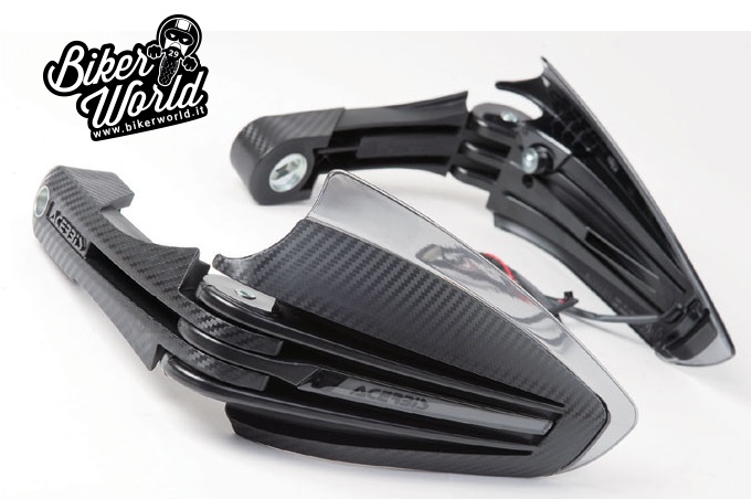

Has any of you have any experience with these: Acerbis X-Tarmac on the Forza? I have 2015 with a Honda tall screen.
https://acerbisb2b.co.uk/index.php/0017 ... guard.html
Do you think they will fit?
