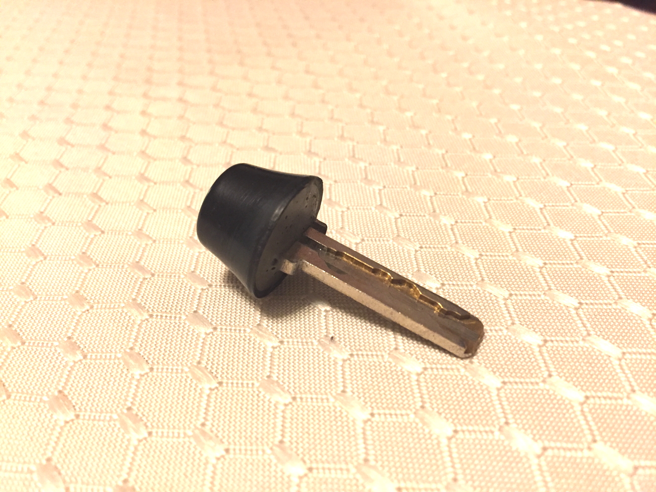

davenowherejones wrote:I do not like the key arrangement. It is possible to put the key inside the case and lock it inside. Not good.

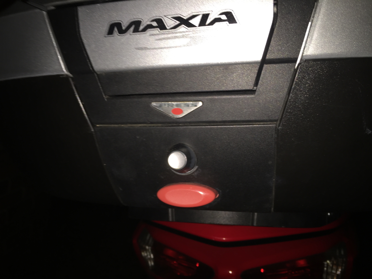

I took an old radio knob, cut one of the Givi keys, and epoxied the key into the knob. Now, I have a stealth key in there all the time. When parked, I turn the key just slightly to the right so that it can’t be pulled out but the lid button can’t be pressed.

Here’s more or less what people see when they walk past the bike. It looks like nothing.
Here’s the key-and-knob on the dining room table.
