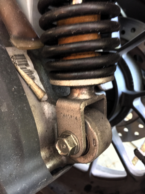

OK, I posted a query in another thread, but wanted to give a heads-up here.
After only about a year of service, my Malossi shocks are weeping oil. I’ll try to post a couple of pictures in a little bit. To my mind, this is unacceptable.
I do not want to put my stock shocks back on, and am hoping to hear about longevity of YSS shocks for the Forza 300.

Posted: Fri Jun 02, 2017 8:10 pm
by MBMyer
Here are pix of top and bottom on one side. The other side looks about the same.

Oh, and it only just now occurred to my fatigued and aging mind that what might be more helpful than months of service is miles of service.
These weeping shocks have ~3500 miles (~5600 km) on them.
