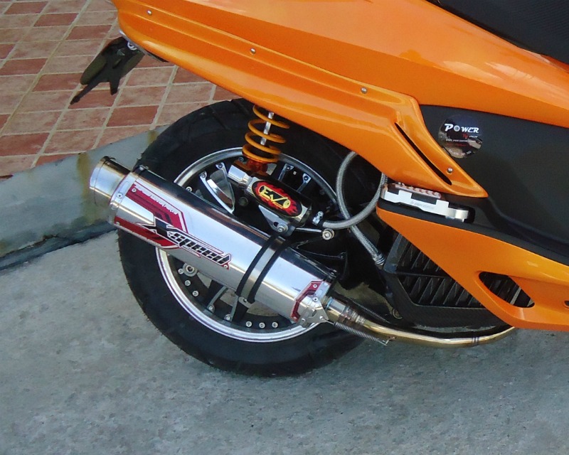

hey everyone im new here i have a 2013 pcx 150 red i have had it about two weeks now and love it. my ? is i have been looking up a lot of stuff (how to's & accessories) and i ran in to these oil breathers
so what i am wondering is does anyone know if the pcx 150 has a pcv system cause if it does then i know this part is useless its just for style if its the look your going for but if the pcx doesnt have a pcv system does anyone know if this part is a good idea
thanks for taking the time to answer my ? :D

Good question. Is this a photo of a bike on the net?
I assume yes.
My guess is that U.S. versions may vary too.
Let's see what folks come up with.
Re: NEW PCX OWNER WITH A ?
Posted: Mon Oct 08, 2012 10:50 am
by vwbike
yes it a bike from powerbypcx.com they have a lot of custom scooters

I don't think the PCX has a PCV valve, but it does have a crankcase breather that terminates in the air filter compartment. Since there is a breather (and the oil breather you posted does the same thing), I don't think you'll gain anything by adding it. If anything, you lose the convenience of being able to easily check your oil level. ;)
Posted: Mon Oct 08, 2012 3:02 pm
by vwbike
cool that answers it thanks maddiedog
